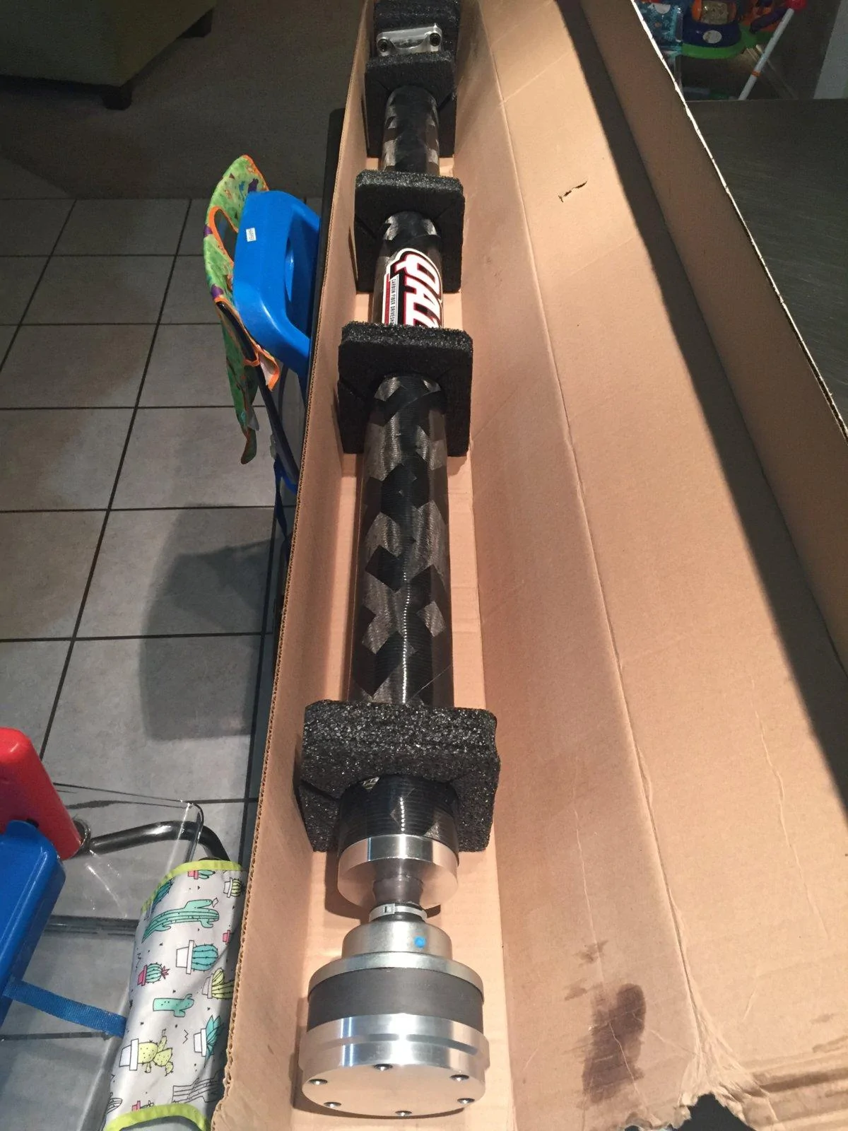

Well thanks guys. That is the info that is worth knowing. Have not heard of one negative about the QA1 except for their packaging for shipment & hopefully that has been cured. Might be a good idea to speak with them when ordering about that.
The product certainly looks top shelf & when the folks that have experienced it first hand speak highly of it helps the comfort level of replacing the OEM shaft. I'm purchasing this & the MGW shifter from what others have experienced with the improvement from the stock equipment. Hopefully will have the same results & enjoy many years of great driving!
