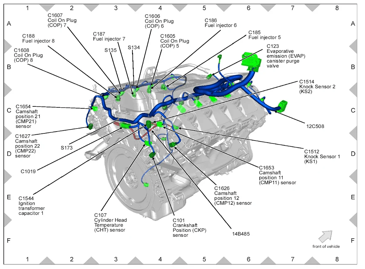

Does it show CHT temp in the dash cluster? If it does I'm wrong and it is something else. If it runs it is not the crank sensor.

Here is a diagram.

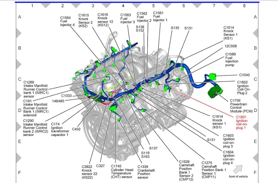

Here is a gen 2

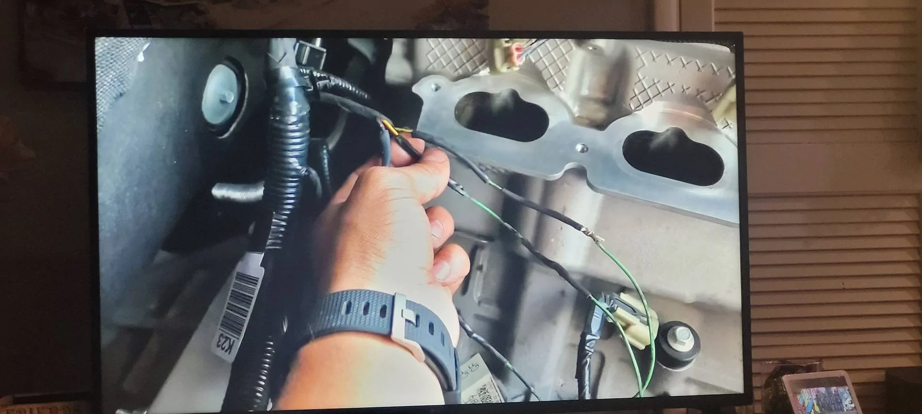

Sircatsalot
Jun 6, 2021
U.s
Drake
2015 Mustang GT
Here's a picture in a video of where it actually is. I suspect it's the very top wire that seems to go behind the engine somewhere
