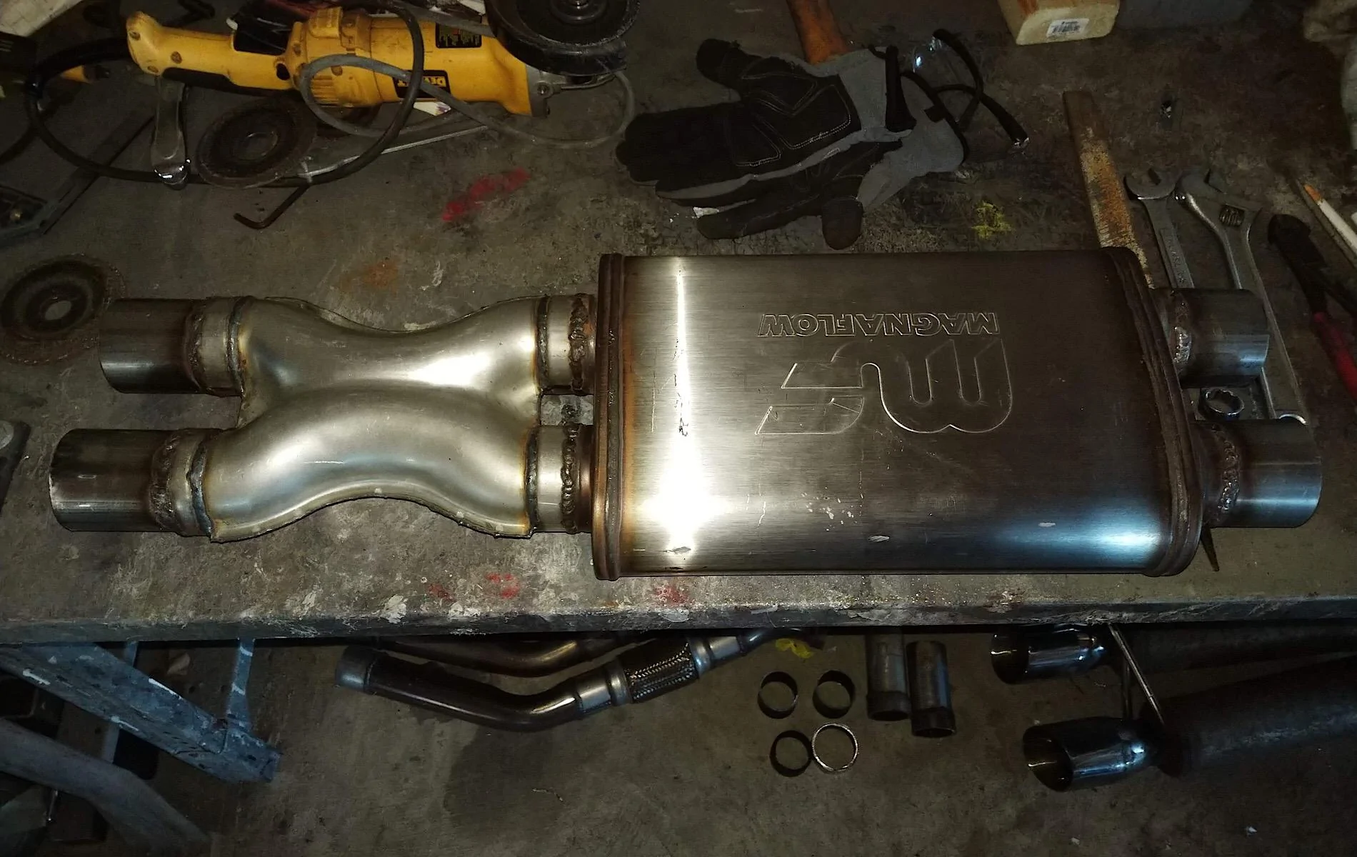

Well one thing lead to another today and I ended up with a completely different center section then expected. This is purely experimental...
Double x with one non resonated feeding into a mangaflow resonated. I should have it installed tomorrow and hopefully some sound clips. I’ll see how it sounds and determine if I continue forward with the concept.

What's the advantage of dual xs? Looks good btw:cheers:

Corsa uses it in their extreme systems. Gives a slightly different sound then a normal x. Problem is that these double Xs are usually combined with loud/raspy mufflers so you can’t really hear the difference.

I noticed a more hollow tone at low loads, and a more exciting/racy tone at high rpm and load vs. a regular X. It's not a big difference but it is noticeable. Corsa claimed some hp on the corvette when they first tried it.

Also, it's easier to hear the difference on their Xtreme since there's no resonators. It's the most clear/crisp exhaust I've heard for the coyote. You can hear every firing event. I'm not sure if it will be as noticeable with a resonated X-pipe. I did actually gather all the parts to do this very same thing before I bought the double X-pipe, Zack. Nice to see it tried!

Holy s**t I think I might have found the Holy Grail of exhausts. Quick and dirty sound clip.
I'll have and better one and a drive away clip later on. But in terms of sound, this thing is just about perfect. Nice deep tone at idle and absolutely no drone. It might actually be a touch too quiet at high RPM but it's got a great smooth tone!

I can definitely hear it. One thing is that the resonated X-pipe will burn in and get louder after a couple hundred miles. Make more videos!

Sound Clips! Mic did a terrible job of capturing the sound but at least it gives you an idea. Much deeper tone in person.
So there is some drone right at 2K up to 2.25K RPM. Not terrible but it is there. Can look into eliminating it down the road with some resonators but it is not something I feel I need to do right now.
