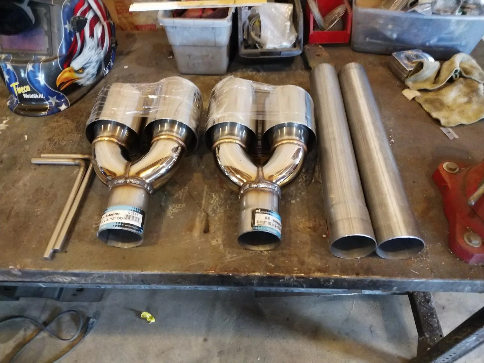

The start! Should be completed tomorrow.

Going muffler delete. Keeping the stock resonator or switching it out?
Going to be a straight muffler delete for now. Step two is removing the center section and replacing with the resonated x. I'll try that for a bit and then go from there.

Have you thought about a set of powersticks (chambered exhaust) or other resonators.. ?
That's not bad. Still a bit unrefined IMO. This exhaust will most certainly be a work in progress tell I find the sound I am looking for. Right now I am working off of the theory that a mid muffler setup will sound a bit deeper and less raspy then a axleback muffler location. That is why I am going for a muffler delete to start and then will be messing with the center resonator location. My other thought was to go with a non resonated x and then two cylindrical mufflers just aft of that. What those mufflers will be I am still not sure of.

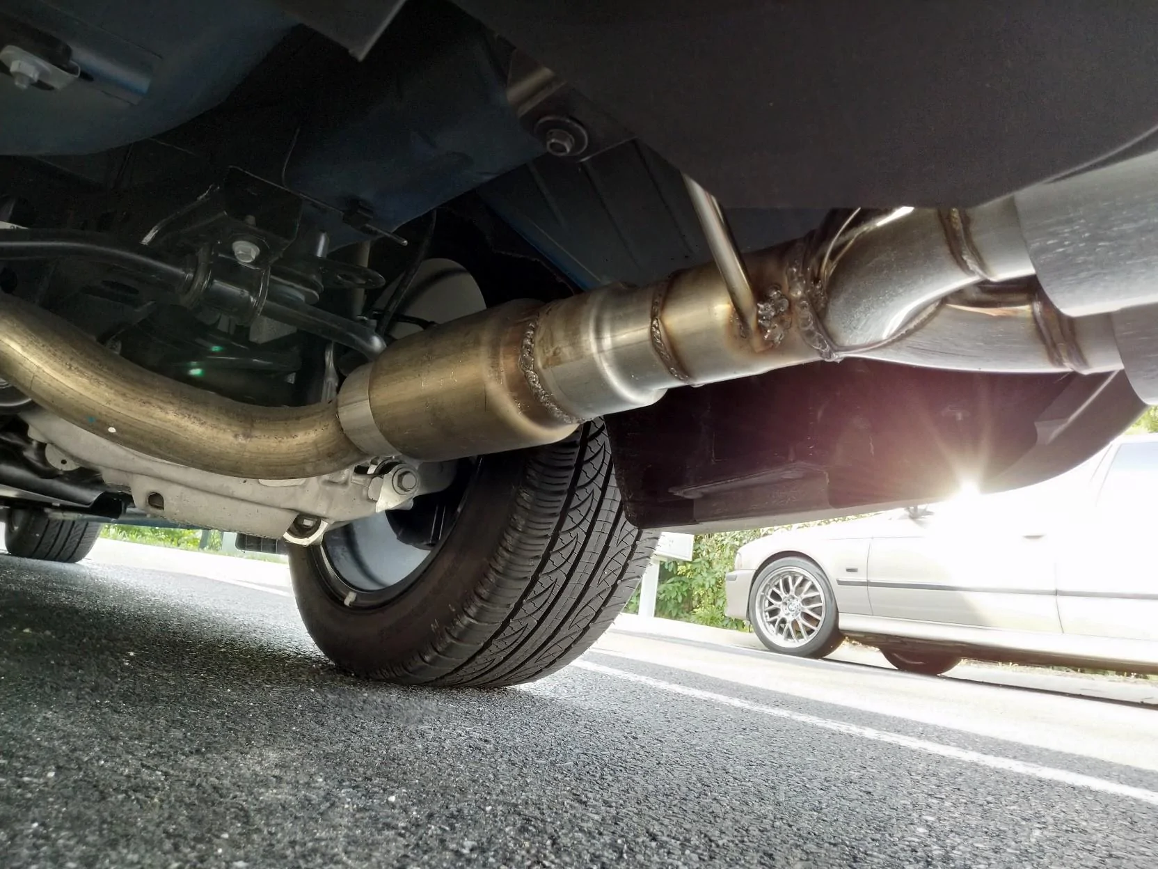

Well it's done. Ended up getting my dynomax mini bullets installed. Sound is ok but it's a bit all volume and no tone right now. Step 2 with the center section should fix this issue. Sorry I don't have a sound clip but it sounds pretty much identical to a muffler delete as you would expect.

Looks really good man!
Nice welds, about as good as most of the exhaust shop's I've used.:thumbsup:
I hope you do the mid muffler setup:headbang:
How are you liking having over 50% more hp on tap in the 18 Zack?

Plan to! Hopefully within the month or so. Likely will redo the axle back as well with less welds/different resonators. After finding that vid I think I am going with the h pipe and mag a flow mufflers after.
