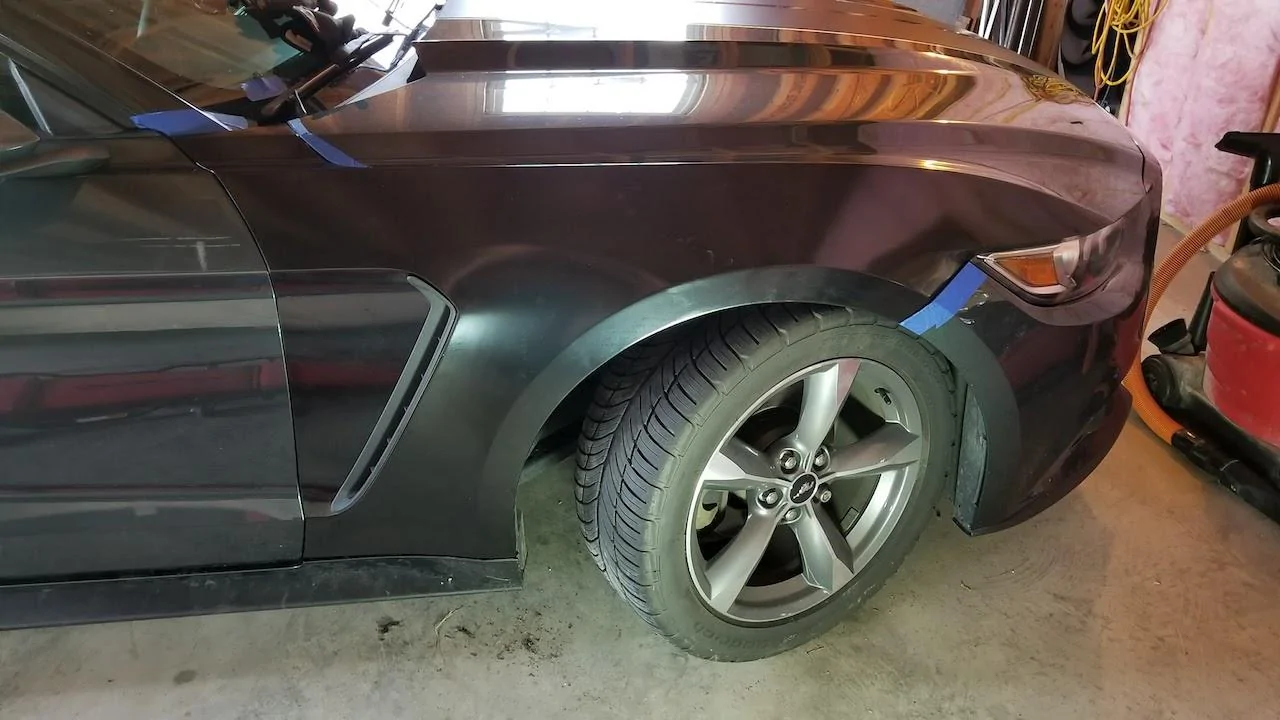

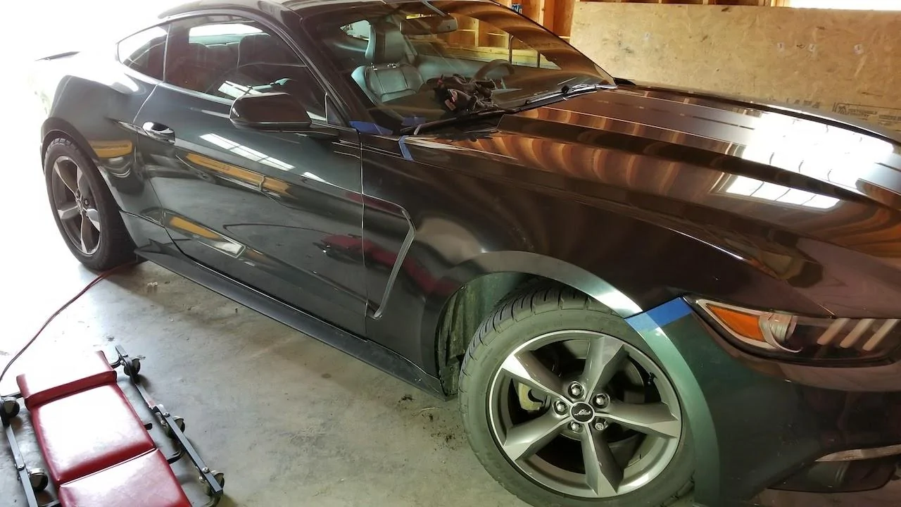

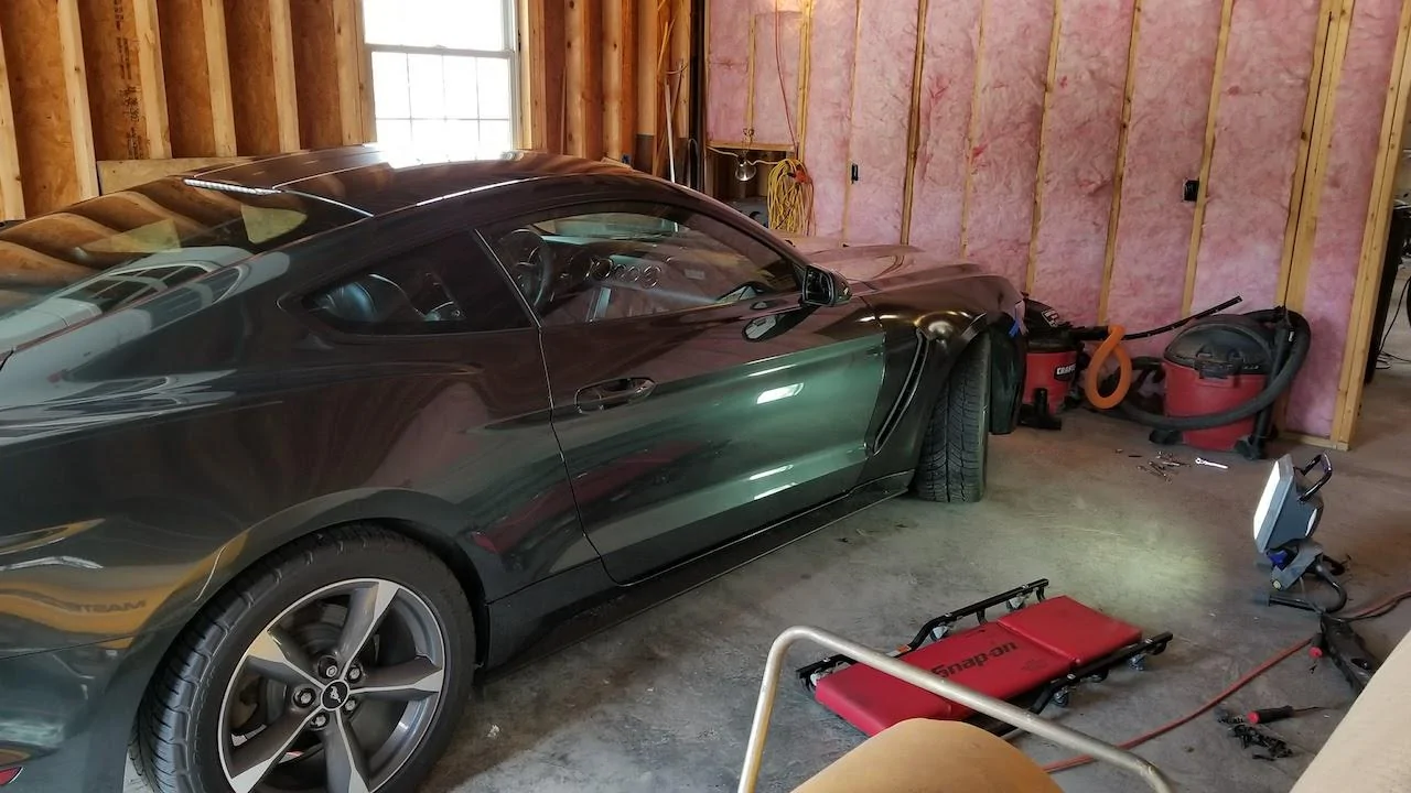

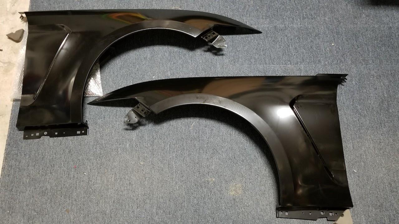

Test fitted the fenders today and am very impressed. With a bit of massaging (a benefit to these being metal) I was able to get them fitting as good if not slightly better in some areas then the OEM fenders!
