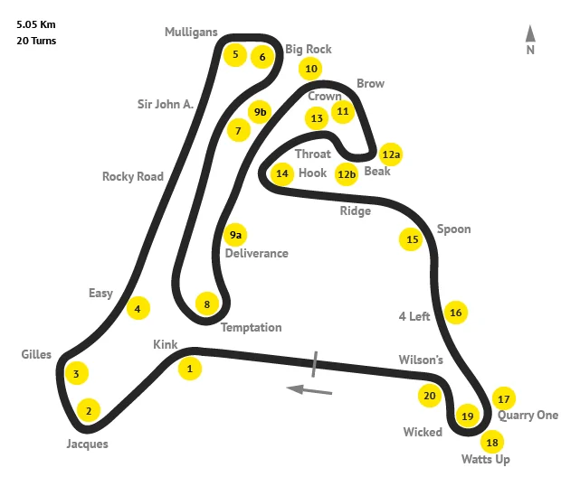

unless your track looks something like this (20 turns over 3miles), and you are driving in 100F ambient, I doubt you even need exhaust wraps.
I've been doing this for couple years and I am still yet to do anything with diff cooling. I use a Milwaukee fan to cool down the diff between sessions if it gets on a hot side, and it never overheated during a session so far.
