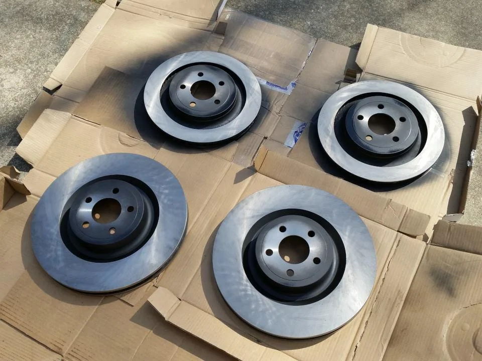

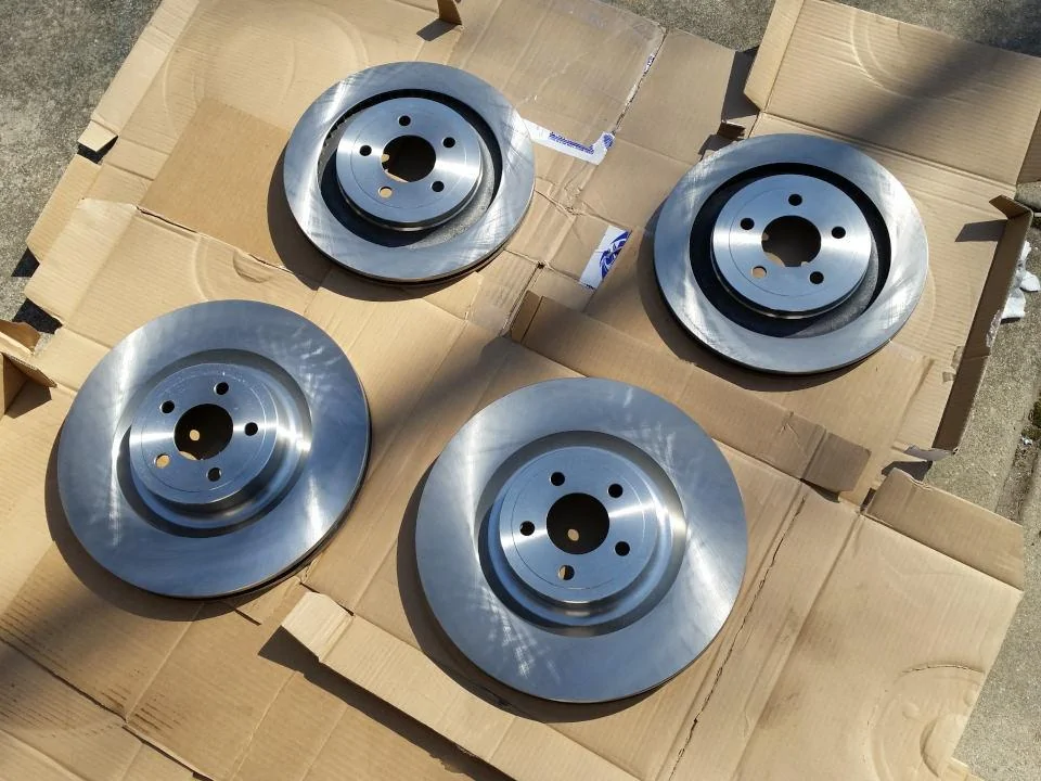

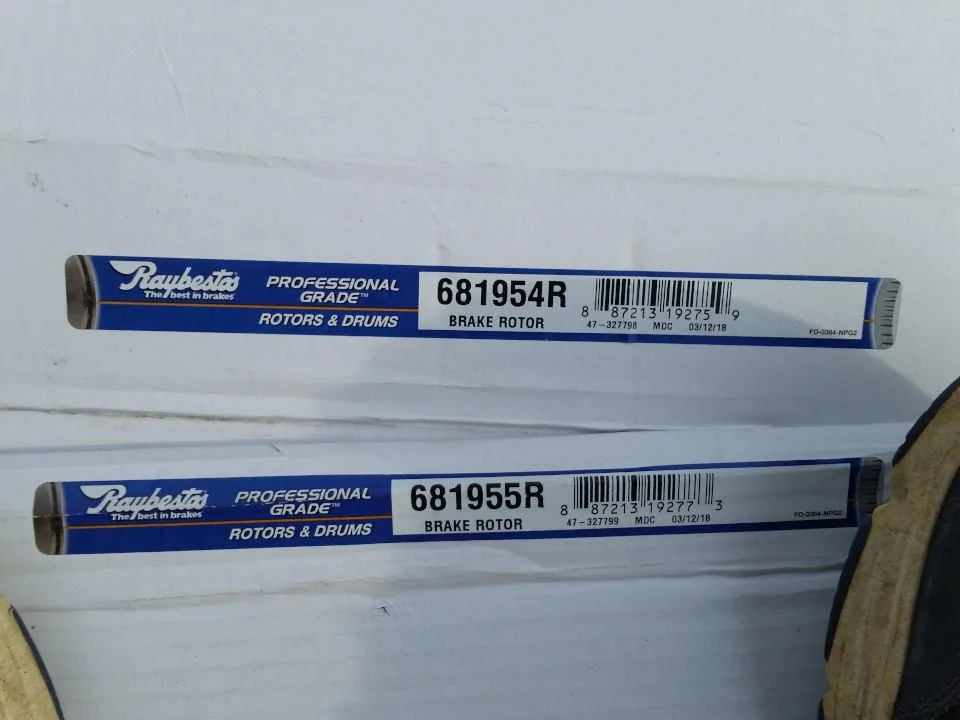

I guess by now this thread is waaaay off the original topic... but anyway, here's the powerstop bedding procedure, which I followed to the T. This is on the box, BTW. The pads also come with replacement caliper clips and anti-squeak grease. Also included a pic of the Raybestos rotor part #s. Very cheap from RockAuto, but did require a quick spray of flat black paint, as they aren't coated. Other than being a few ounces heavier than the stock rotors, they spec out the same.
