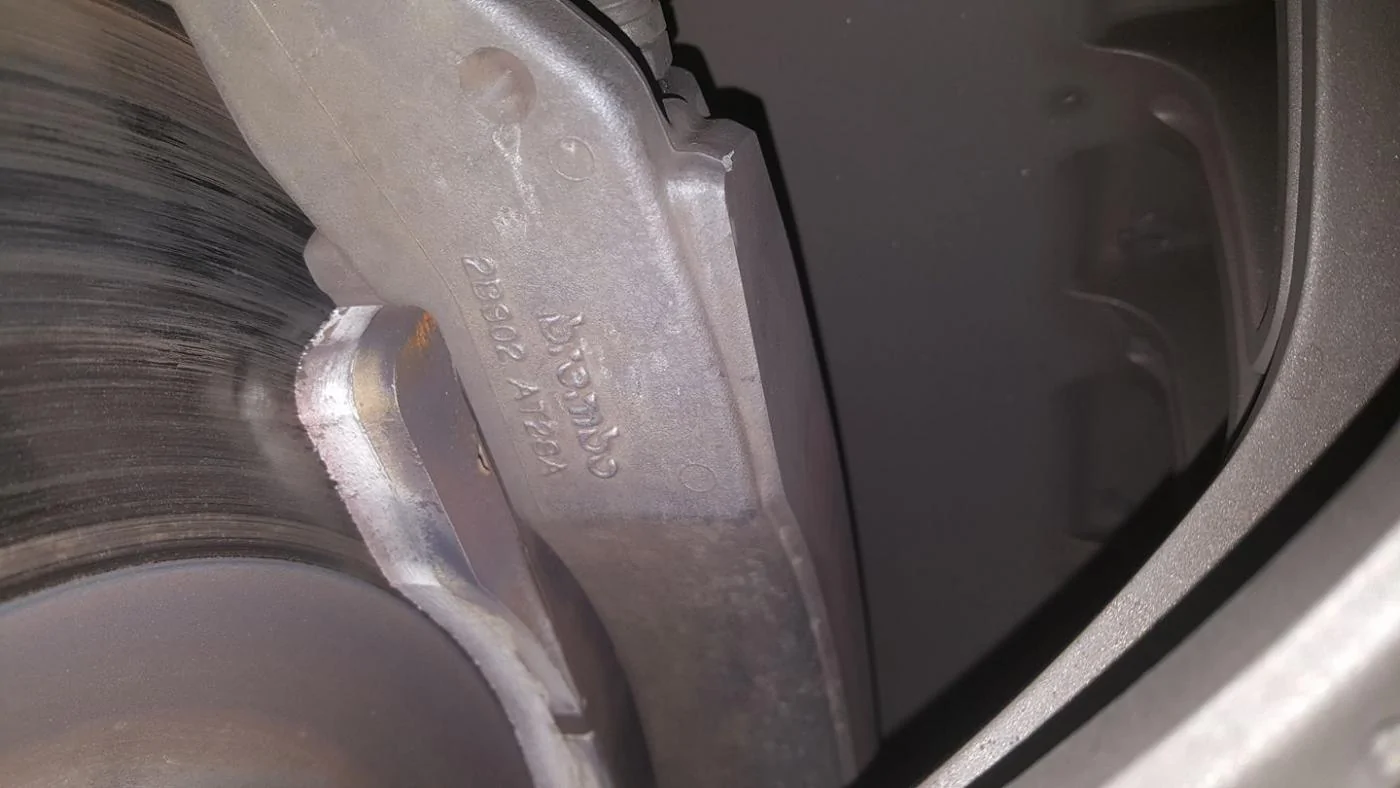

You mentioned something where your braking data files surprised you. Do you care to share that information? It sounds like while you didn't feel like you were braking as hard on the R12's your data suggested otherwise :shrug: Did this cause you to over-slow at corner entry? Maybe you were over-braking combined with no brake cooling to cause the caliper flex leading to the tapered wear.
Data is in the side by side videos. I had expected the data to show significantly better braking with the stock pads. It shows about the same. That was the surprise. I was not over braking and you can see I actually went in too hot into 7. I was not able to get into ABS on the R12 and was able to on the stock pad. That's the part that had me thinking I would see greater G's under braking. The G's in the corners are the same between the 2 tires so the grip level does not account for the inability to lock up. The tires can be clearly heard protesting that they have no more grip available.:lol:
I believe the pads tapered because the bite of the R12 was not enough and I was having to stomp on the pedal with both feet to get the car slowed down. Too bad I can't get brake pedal pressure with my Solo DL. I'd love to see what that would show.
I'm amazed you had enough bite on the R10. Perhaps what I received was not R12?

Jim, looking back at your original post it does look like your pads had the silver backing plate which is what the GLOC R8 pads use...the R12s are blue. Perhaps the blue color faded out entirely if they were in fact R12 pads, but the switch up may have been a possibility..

The blue goes away in one session.
In all fairness P-Zeros make a lot of noise, all the time :D My Comp 2's are much better communicators, I know when I have them loaded properly and when I don't. Staggered tires do not work on these cars for track use. When I went square on P-Zeros it was a vast improvement. The 285 Comps make my car very neutral on stock suspension (except in off camber turns with too much entry speed :frusty:)
If you were not boiling the fluid the need to use two feet with PP brakes it is an indication of a bedding issue. R12's should be giving you ABS all the time on those tiny little 255 P-Zero's up front. If you ever want to try them again let me know, I can get you a set of Pre-Bed R16's (for Sebring) or R12's and can get you a set of factory rotors. I would suggest an R10 on the rear to balance the car out. I think if you gave this a try you would have a much different opinion. Again, pushing hard at Sebring brake cooling is mandatory. Also if you have 200#'s riding right seat that is a lot more inertia to slow down.
The R10's bite very hard for me, and I typically do not brake initially with enough pressure so I have to modulate it. With my very basic set-up I have to be careful on loading the chassis because there is not a lot of extra grip available if I shock the chassis. The PP suspension is really good but under-sprung and under-damped for track use near the limits. The car tends to go where it wants under late braking ;)
