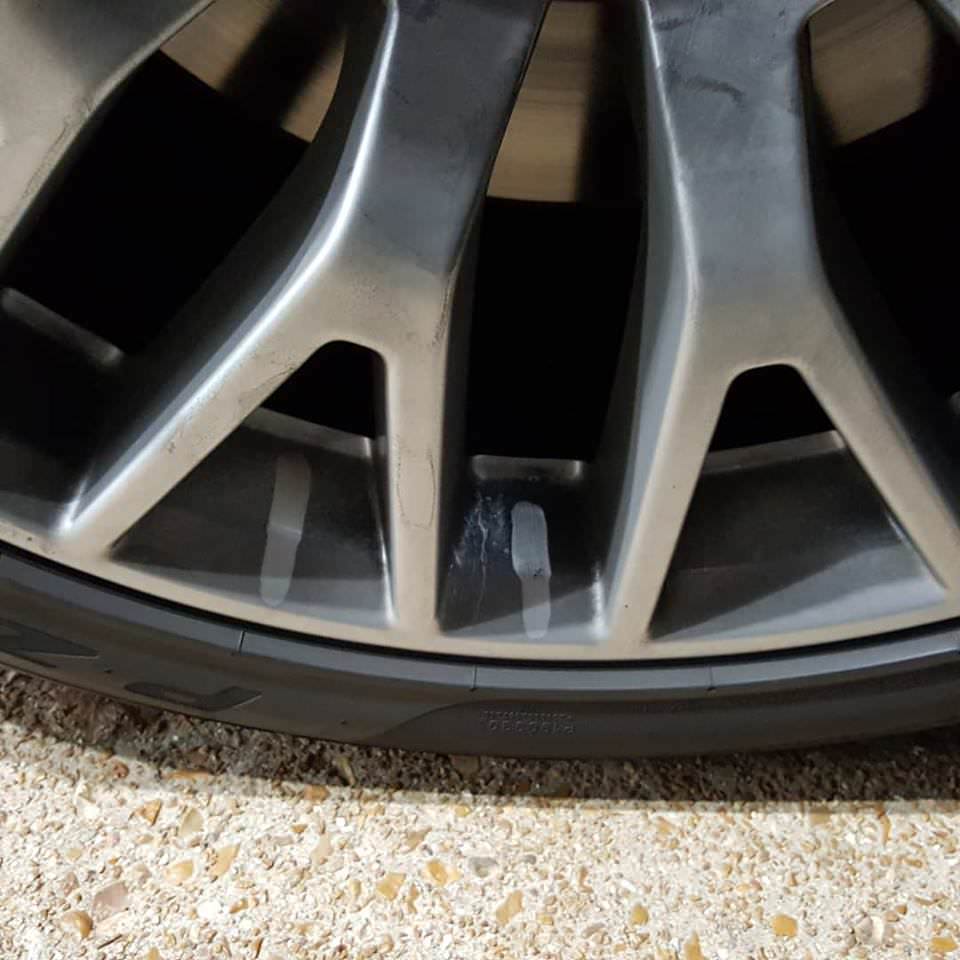

I installed the Powerstop Track Day pads on Friday and had a chance to try them out on Saturday. I was still on stock non-PP pads before switching to these, so to me it seems like they grab a lot harder. Also pedal feel is much firmer and I'm able to get into ABS much easier, but that may be due to Motul 600.
Initial/cold bite seems good, I haven't heard any squealing even in 25 degree weather we had over the weekend. They do dust quite a bit. This is after one 20 min session:
Overall they seem pretty good.

^ Good to hear. I ordered a set for my non-PP setup and will be doing a 2 day event with my Mustang at a brake heavy track (Eagles Canyon) April 21-22. I'm an instructor and pretty hard on the brakes so this should be a pretty good test for them. I only track this car once or twice a year so I don't want to invest in upgrading to full track setup.
