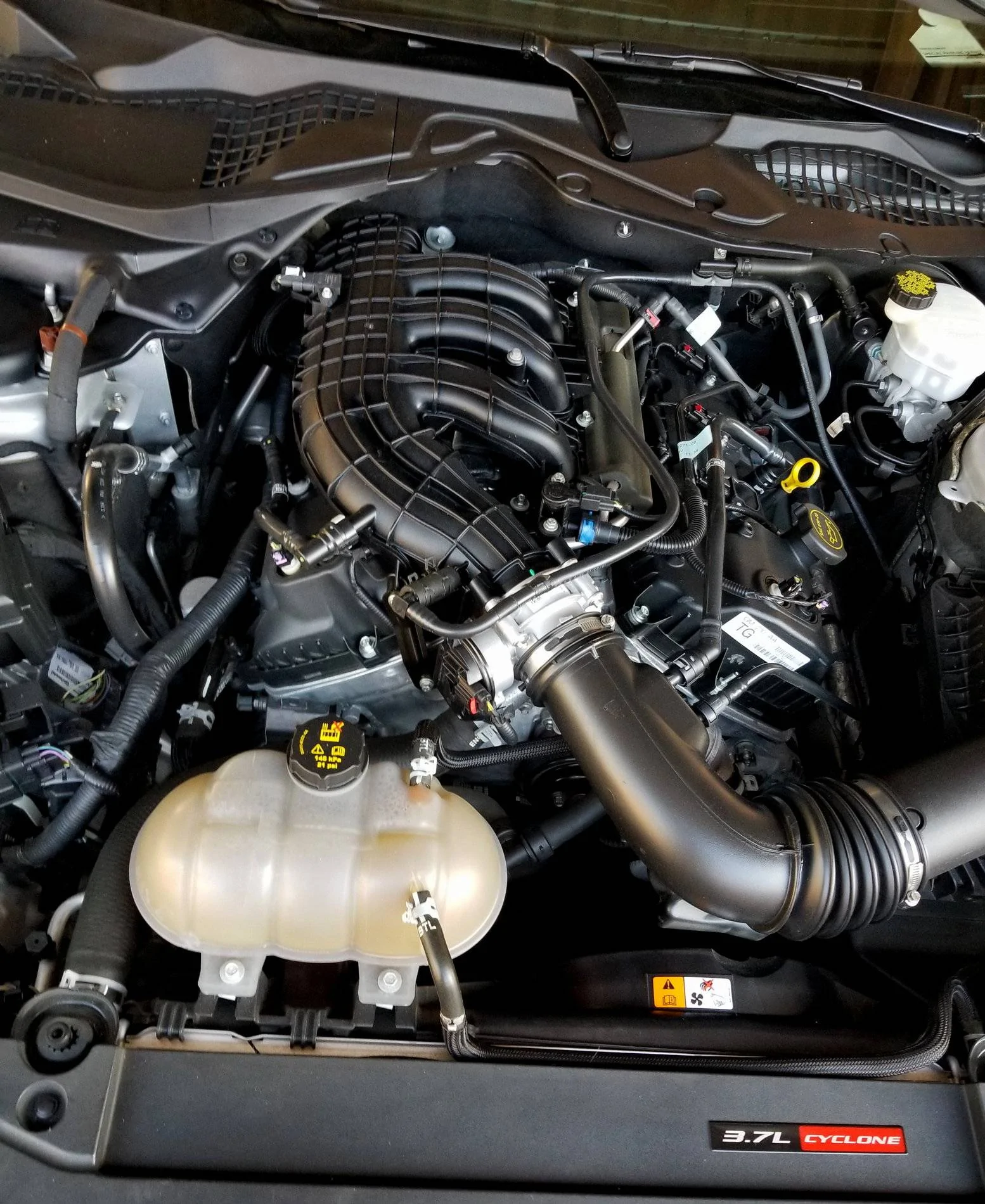

@zero_chance , hey- I think I understand your dust problem-I'm in Las Vegas. It's like the wind is trying to build sand dunes under there. I've washed my 2016 S550's engine bay three times, so far. I was nervous enough about it at first to look it up (found it owners' manual pg 232 under vehicle care).
Yours is just dust, right? It'll come off easily.
What I do is: at the hand car wash with hi/lo pressure wands. Warm, not hot engine, turned off. I bring aluminum foil and plastic grocery bag-that goes over alternator. I wrap the coil wire connectors? with little foil pieces. Not necessary with engine cover. Straight to "wash" and keep pressure low, as soon as suds appear go quickly, thoroughly over everything under the hood. Immediately switch to "spot free" rinse. As soon as it's rinsed, take away plastic bag, etc, ,start the engine. After checking it over, close the hood and go for a little drive, until it's dry. Check for any little puddles left, sop them up.
When it's dry, I give a spray all over with a Chemical Guys product that gives it a sheen. The spray dries completely, I think it helps keeping the dust down.
Some places have a tire/engine setting. It's very harsh, made for grease, I wouldn't.
Engine pic is from today (yes, I have way too much time on my hands) It's a little dusty now, haven't cleaned it since January and it's been windy.
Anyway, that's how I do it. Hope that helps.
edit: Want to make sure it's clear-the wand I use sends water at no pressure- like a watering can- until you pull the trigger. Don't pull the trigger. Spot free rinse is very low pressure. owners manual recommends engine cleaning, using care.

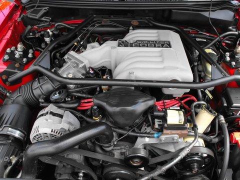

Here's how I have been keeping engines clean for eons...
1) Spray down under hood and engine bay (do not "supersoak", just spray down)
2) Get Simple Green - it will not harm metal or plastic surfaces
3) Spray the SG liberally over the entire engine and engine compartment
4) Wait about a good 10-15 mins
5) Rinse
6) Close hood and start engine
7) Let vehicle run a good 15 mins so heat from engine will dry mostly everything
8) Turn off vehicle
9) Pop hood and manually dry any areas where water may be laying
10) Use a dressing of your choice to wipe down any rubber/plastic items so they have a sheen - NOT a wet gloss.
That's it... been doing it for years, never had any issues afterwards. You can get the engine bay wet, but what some folks do wrong is they supersoak or drown it, which is when you run into starting problems.
Electronics and harnesses will be fine - they are designed to withstand water spray as many of the connectors are sealed - but not designed to be submerged (as in flood waters).
IF you have an OPEN AIR CAI (exposed filter element, such as Roush, GT350 and other aftermarket types) you MUST cover it with plastic bag, so the filter does not get soaked and so you’re not getting any residual water into the air intake tract. If you have the factory sealed airBOX assembly, no need to cover it as it’s sealed.
Another detailed trick/tip:
After dry, get WD40 and spray the metal areas - after spraying, again start car and let sit for 5-10 mins w/ hood closed. The WD40 will not ignite or cause any issues with anything, the heat will burn off any residual WD40 so don’t worry if you smell anything while car is running. After running car, just pop hood and wipe down any plastic surfaces.
WD40 will protect the metals from that oxidation and rust; the original intent and design of WD40 was to repel moisture and water - which will help to prevent that oxi build up due to constant changing weather conditions.
I’ve been doing the above for years with any vehicle I’ve had, including my 94 Cobra - and it works.
The attached image is of my 94 Cobra engine bay as it looks today. If I didn't tell you all, you wouldn't believe it has almost 145k original miles and was driven 24/7/365 in every season here in NJ up until 2007. The engine has never been out of the car and the attached aluminum parts/accessories are all original and look as new as they were right out of their parts bins back in 94...LOL.
I did the above process every time I washed the car (so about 1x a week). The WD40 not only protects the metal, but also any other surfaces such as plastics and rubber surfaces/components.
You don't need a slew of the most expensive name brand detailing shit, just some good old smarts and use of existing products available anywhere. :)
