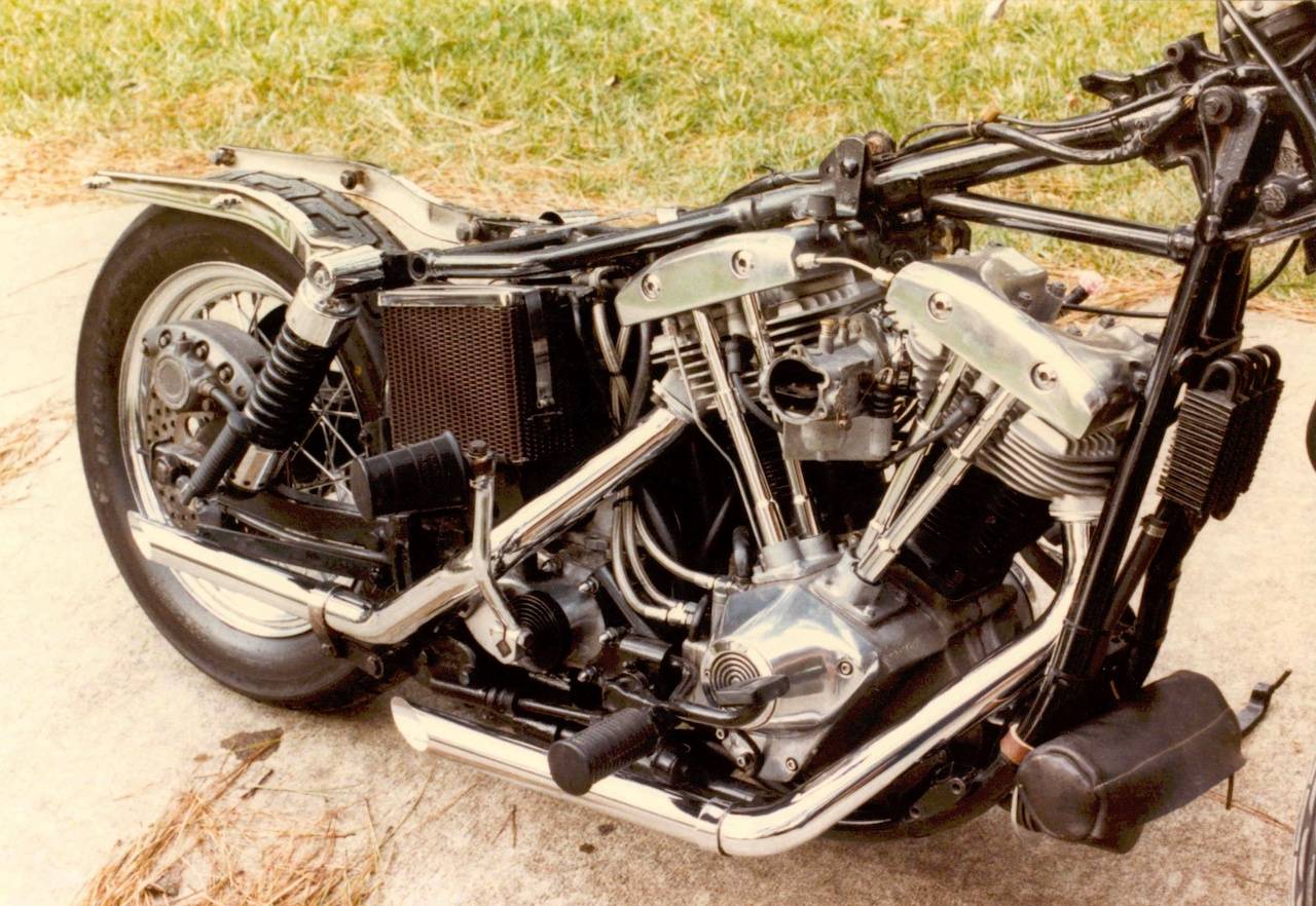

I 've been buying this stuff & using, on all things with wheels. Motors, suspension, rear ends motorcycle, yard machines. As far back as 1980, get it on a Motorcycle chain will need to re-oil same.

I've cleaned many aluminum engine parts, raw (no clear coat)aluminum wheels . User did something wrong
Show me ?
Zep like it for the siding on the house. Would never use it beyond that.
One thing that does destroy an aluminum finsh "Purple Power" .
Certainly not Simple Green, and it also will not hurt painted surfaces .

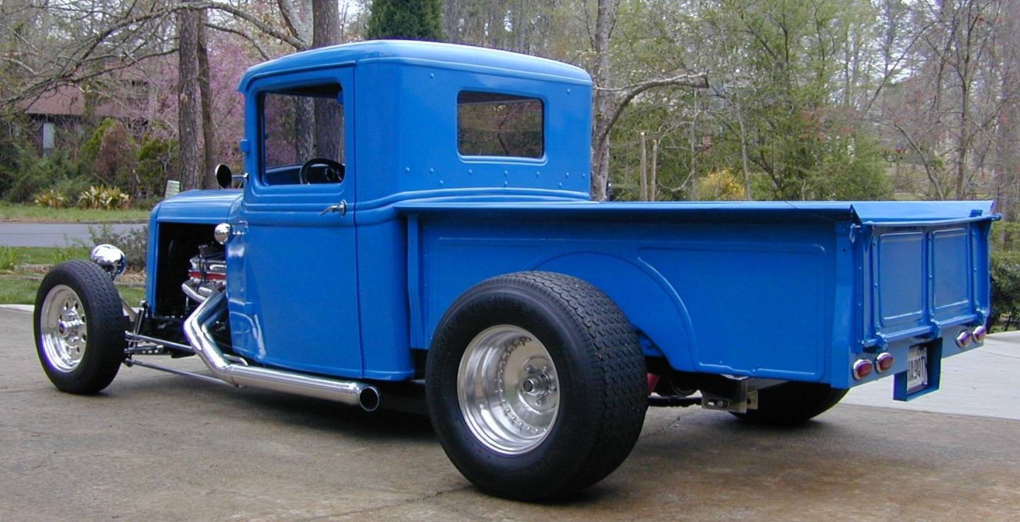

Blue truck built at the house took 4 years rust to paint to running.

Obviously, I was teasing you about the chevy engine you got in it. looks good thought you had a different paint job ? That blue looks good 👍
Thanks, Color Peterbuilt, is a truck needed a truck color was the thinking.
