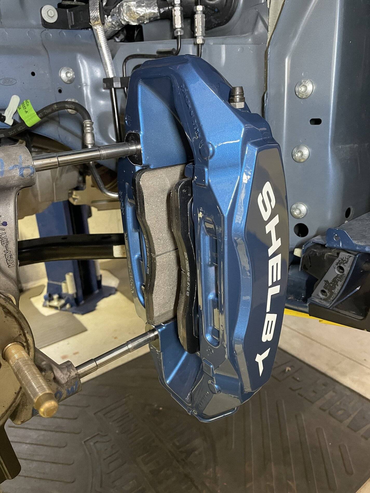

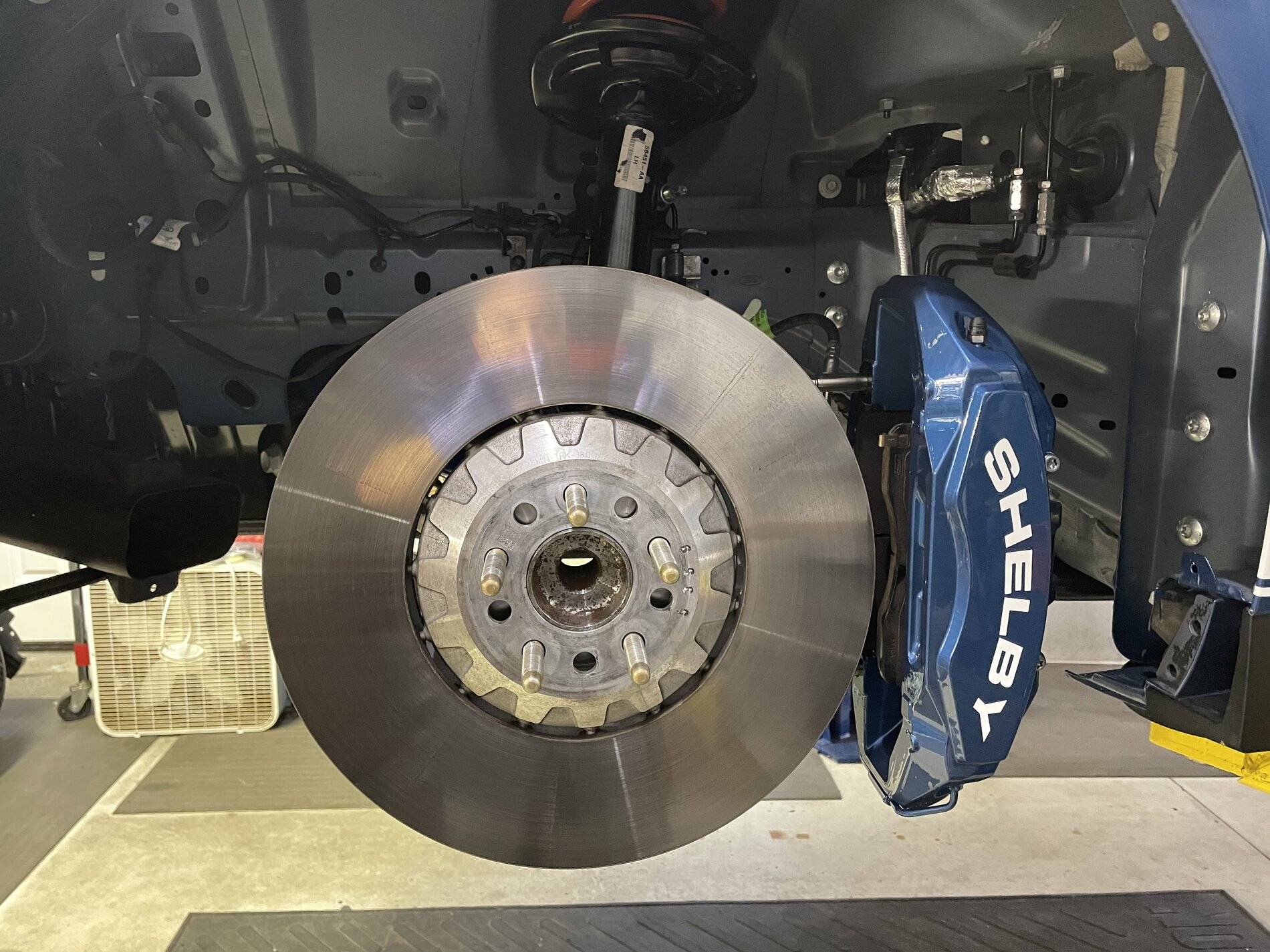

For those of you who did replace the pads did you do it yourself or take it somewhere? I've done it on a Hellcat before, was pretty easy, just 2 pins, but these look more involved. Since I don't have a lift in my garage I find myself wondering if it's something I want to even try.

I did mine, super easy. If you have ever done front pads before on any car, I would say it’s a little bit easier as far as work performed. With girth comes weight, which does play a little factor.
Think about getting a set of Caliperfexion caliper studs, and the extensions. Brake pad slaps will forever be a breeze after that!
Edit: I was getting the link for the studs for you, but KB posted it below :thumbsup:

Craig: It's not much different than any other front brake and similar to my '14. You can certainly do it with a floor jack and stands but those calipers are huge when you get right up to them. Hanging is doable but, the CaliperFexion stud/sleeve mod makes things a whole lot easier.
Jaime just enjoyed them again, too. :-) One of those things you wish you'd thought of for sure. Highly-recommended.

How did you support your calipers when installing the Caliperfexion studs? I have the set and extensions ready for install and I’m looking at possibly ordering a cheap set of S-hooks to hang them from my springs while I install the studs.
I hung them with S hooks. You could improvise and use wire or coat hanger if you don’t pick up some S hooks.
