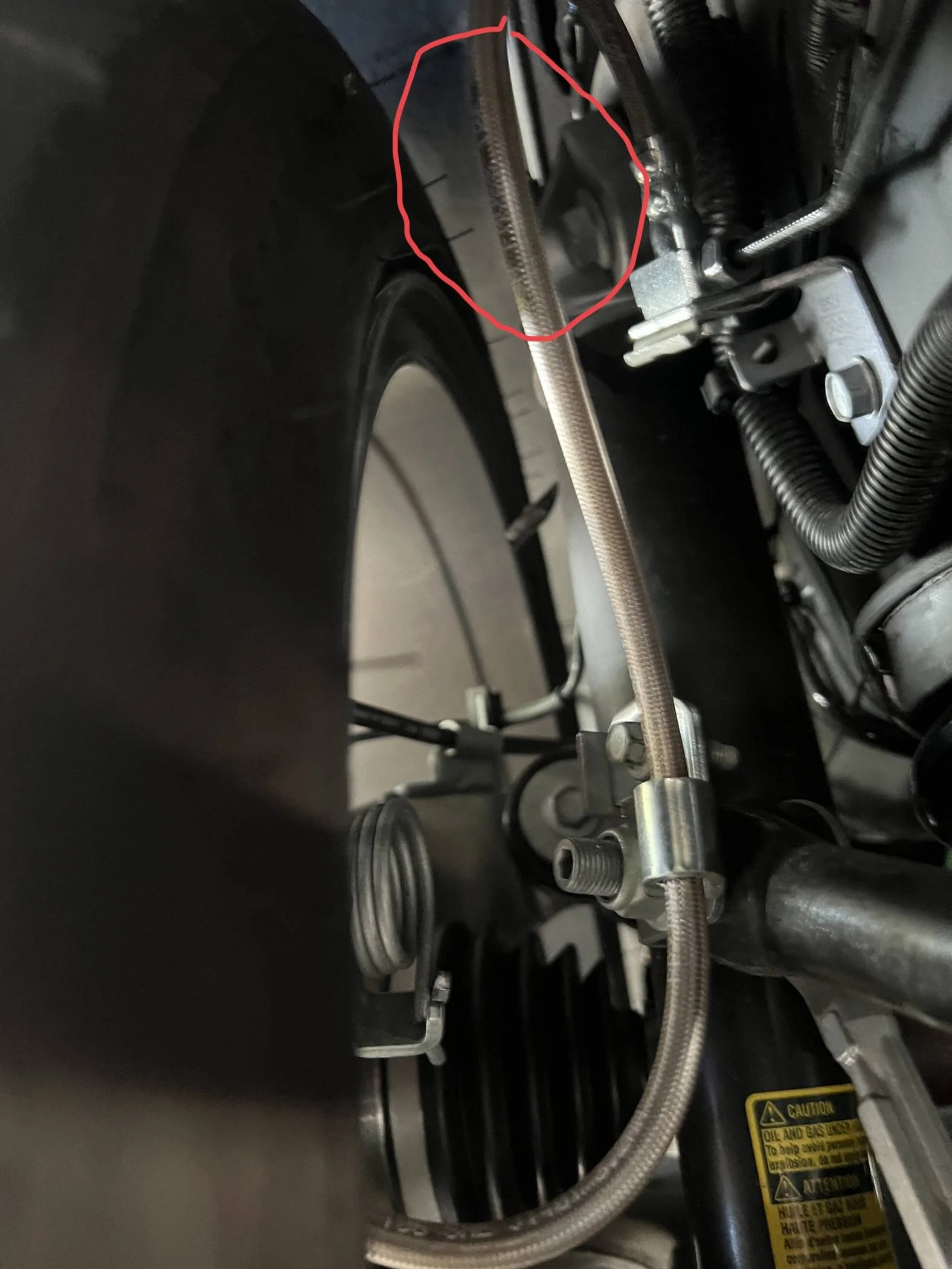

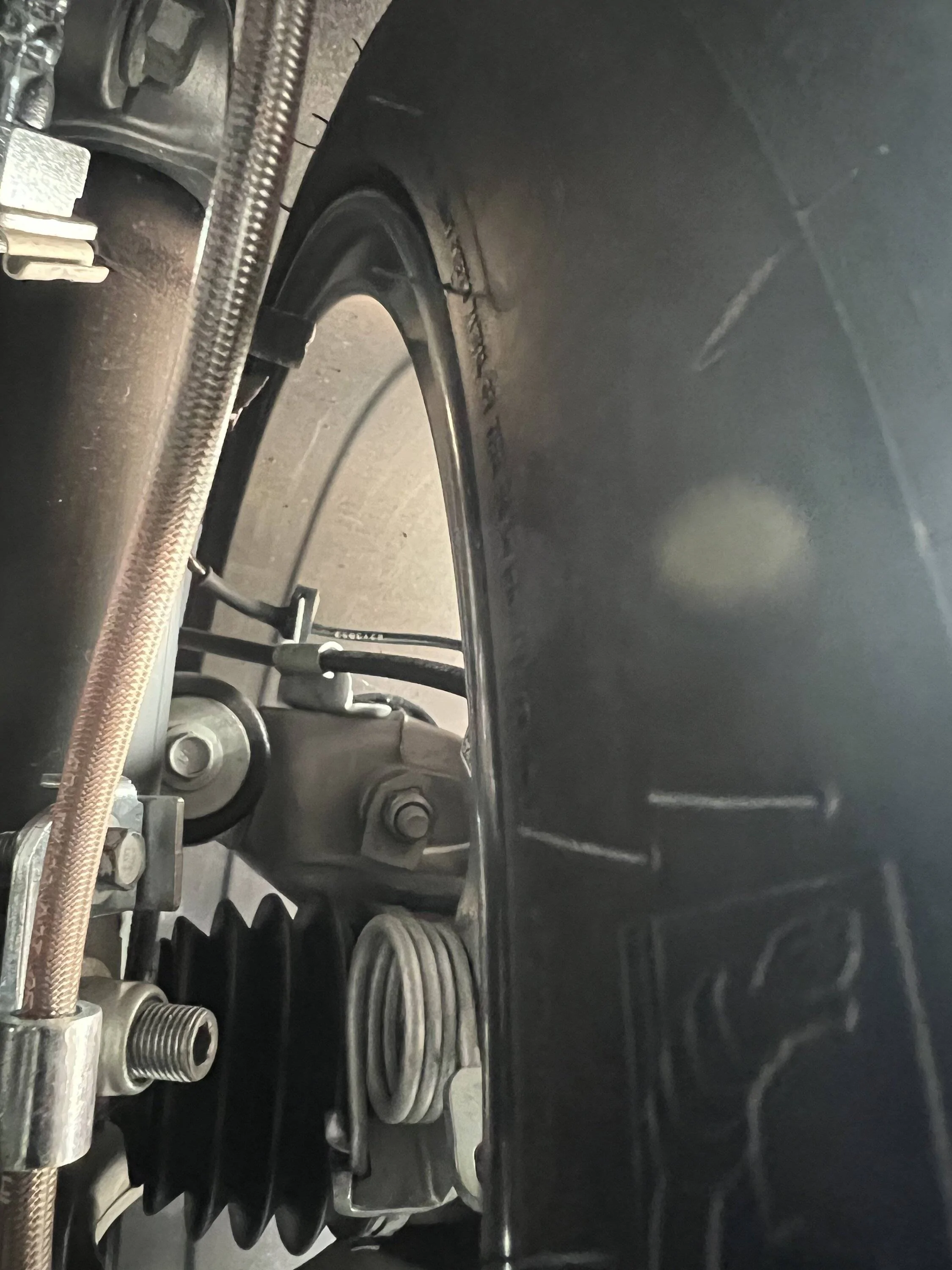

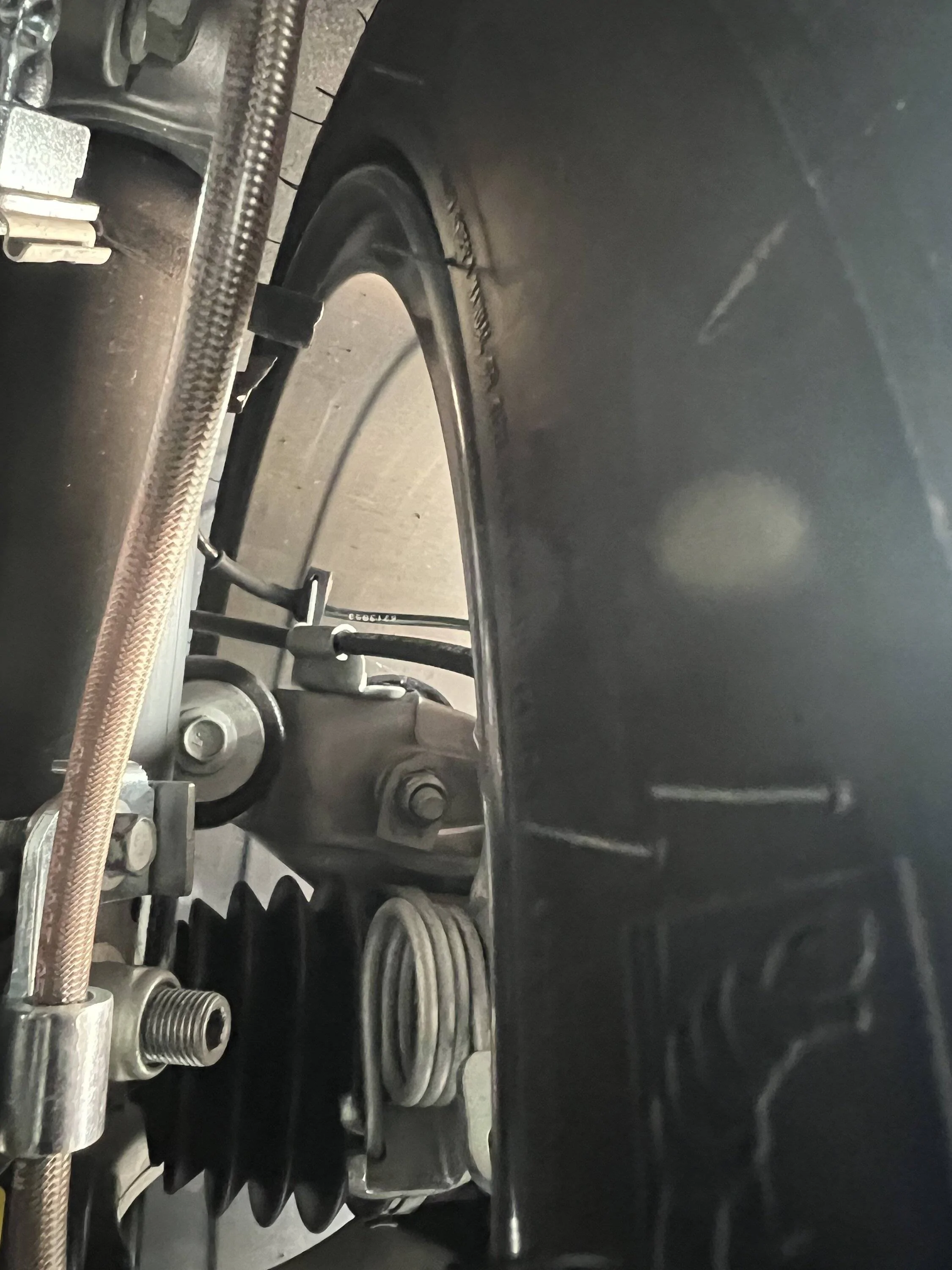

So seeing this post made me go check my lines. It’s interesting because there is about 2-2 1/2” clearance between the lines and the tires, but it looks like there is evidence of very slight rubbing. The lines are smooth, and don’t appear compromised in any way, but there appears to be a very slight amount of darkening on the lines as through the tires are occasionally touching them.
I’m going to contact my installer and have them check it. Maybe @Optimum Performance can weigh in; these are their lines.

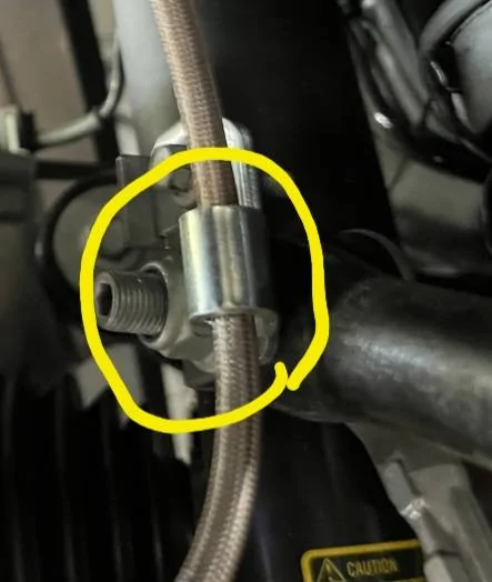

The line slides in this bracket. It should be checked upon installation through the full sweep of suspension travel.
Thanks so much for the reply and feedback. I’m going to check with the installer. I appreciate the info.
Is the adjustment made at the bracket you circled or does the line need to be swiveled away from the tire at the block where it meets the hard line?
What’s odd is there is about 2” or so of space between the line and the tire…is the suspension moving so much they can actually make contact?

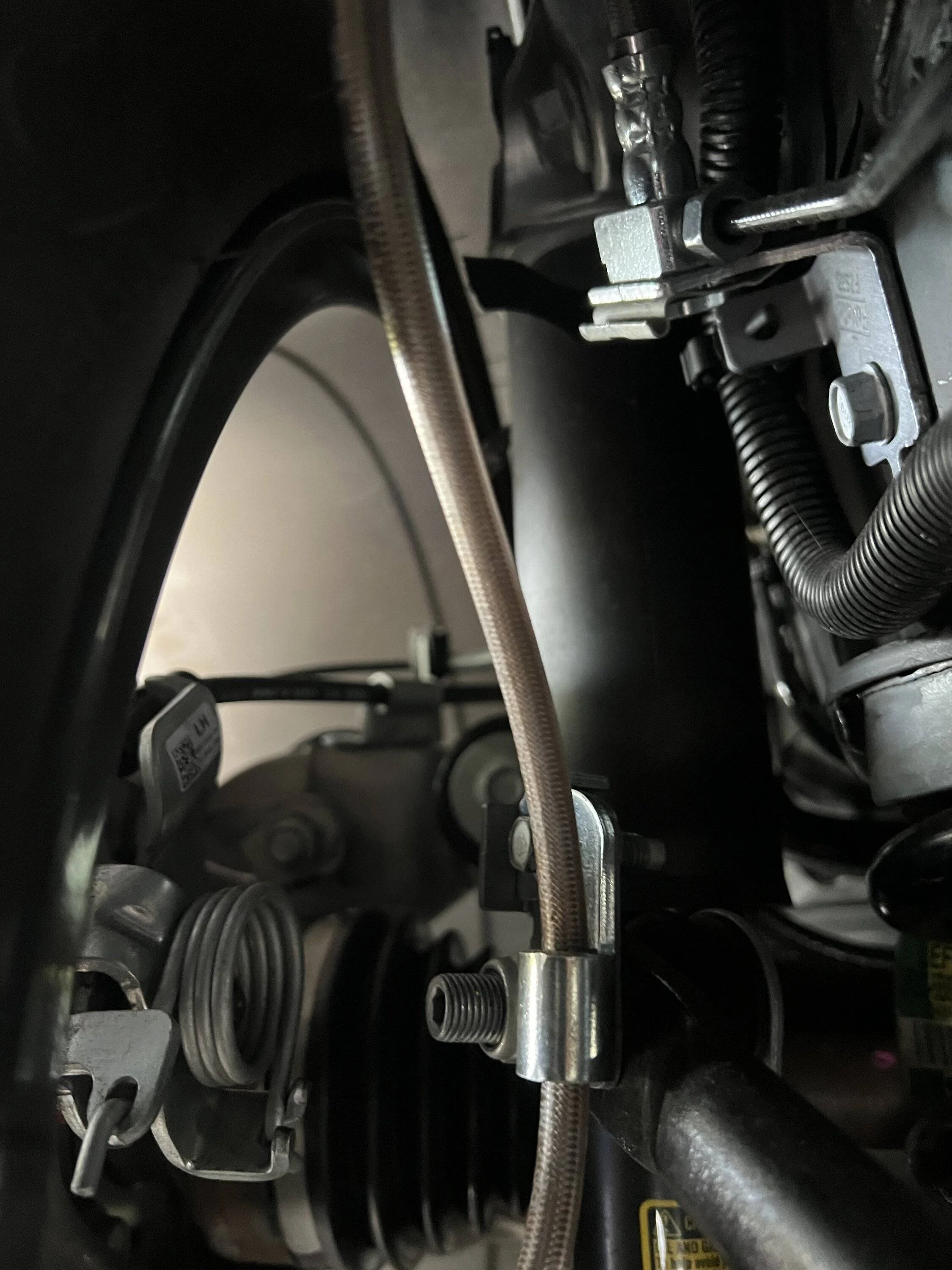

That's Why we check things, it's how ever the hose lays and twists during suspension travel. The hose can be effectively lengthened and shortened in this bracket, the hose fittings have play and brackets can be slightly bent to make things fit perfectly.

Keep in mind that on the S550 there is camber gain throughout the suspension travel due to the IRS. So 2"clearance at ride height may be only 0" in a corner because the hose is the same length, the distance between the 2 mounting points becomes more or less and the hose needs to move (wiggle) to take up that extra length. You can watch this with the tire off and with the car on a lift or jack stands, jack under the control arm and watch what the hose does, it needs to bend more or straighten out to account for the distance change.
Good to know. It’s going back into the shop to get checked. I’ll pass this on to the mechanic, who I have a good relationship with. I’m sure she’ll be able to adjust it. If she can’t figure it out, I’ll reach out to you, but don’t anticipate that’ll be necessary.
Appreciate the follow up, and advice.
