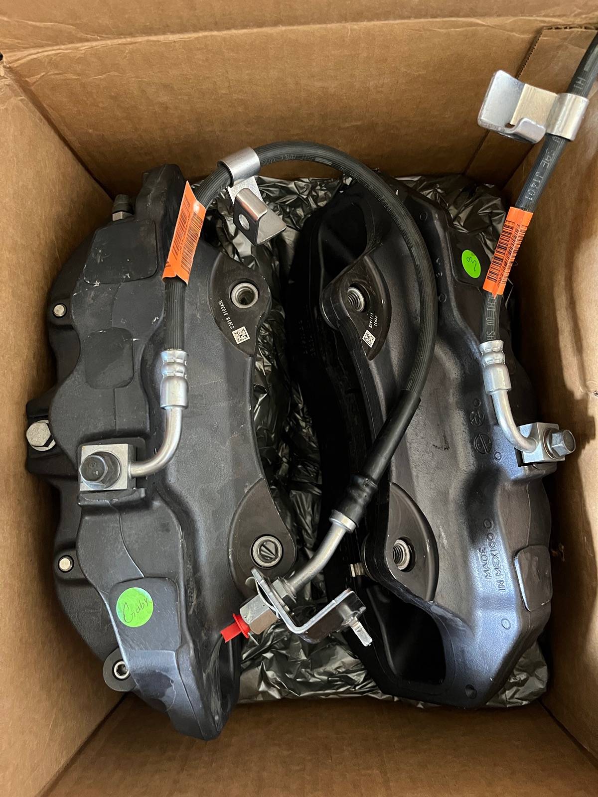

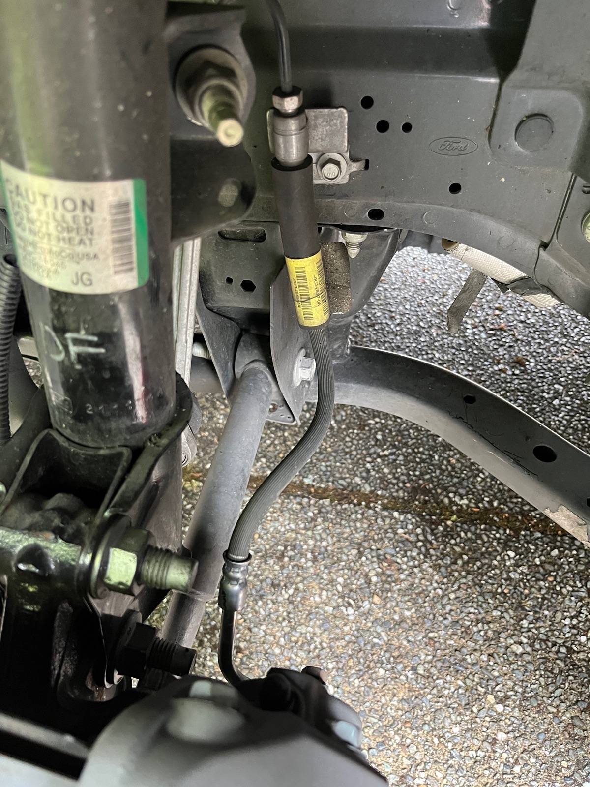

Hi all, I acquired this set of Brembo take offs from Shelby. They came with brake lines attached that look much different from the lines on my GT. Which should I use? Any help much appreciated.
This is the existing GT line.
This is the line on the Brembo.

PP1 brakes are not the same thing as takeoffs from a Shelby.
GT350 brakes are not a direct swap to a GT as are the PP1 brakes. You need a custom adapter to make those work.
But your OEM lines will work with the GT350 calipers, so just reuse those.

Thanks fellas. After looking closely, I believe that these are PP1 calipers from a Magneride equipped vehicle. Magneride appears to get a different brake line. I’ll go ahead and reuse my existing lines.

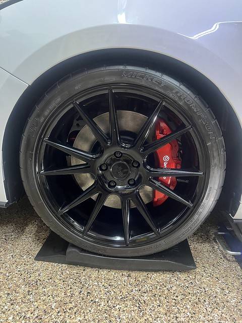

I went from Baer Brakes which were total garbo (don't know what I was thinking) to 6-Piston PP1 brakes on my Premium. Probably the best mod other than the Blower and fuel system.
Once day I'll change to the rear GT350 knuckles in the back so I can get some real Brembo calipers in the rear.

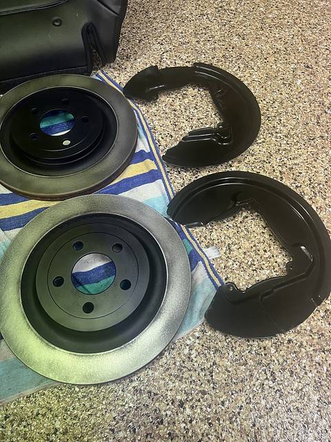

Using the stock GT heat shields is blocking and killing the cooling efficiency for the 6 piston Brembo brakes. The PP1 brake dust shields direct the cooling air to the back side of the rotors.
