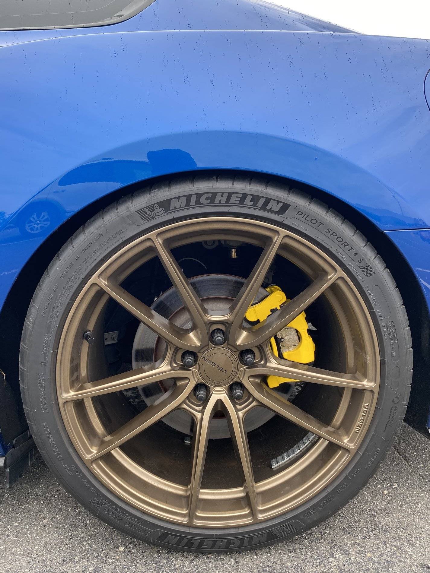

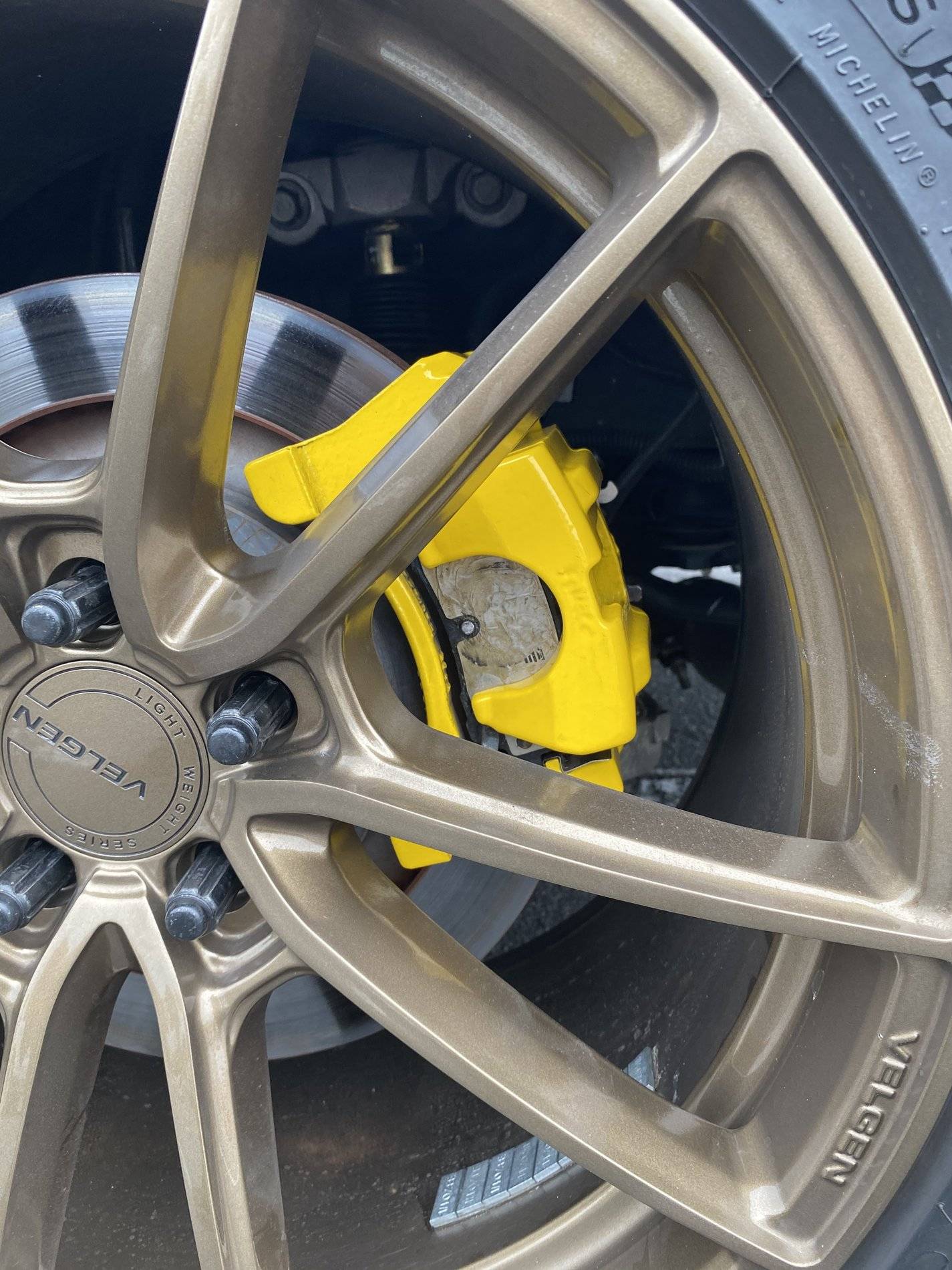

So I had my calipers recoated and for some reason the rear brakes have a burning smell and sometimes smoke under heavy braking. I’ve checked everything even bled the system twice.
Also I recently took everything apart today and found the mark from the pads were getting stuck on the brackets so I greased them. Still getting a burning smell under heavy smell. I’m out of options. Any ideas?

Sounds like you didn't use high temp paint for the calipers and its burning off.

Are the brakes staying applied in the rear? Are the brake pads able to slide smoothly since you greased them? If so, it’s possible that the rear caliper pistons are seized. With the rear wheels off the ground and the transmission in neutral both wheels should spin freely.
It moves but it’s very hard

Yes, those rotors are as blue as your lugs, plus you can always just touch them, quickly to see how hot the rears are.

It would be best to replace the rotors after you find the source of brake binding. Overheating the rotors causes hard spots that can’t be machined out.
You’ll need to disassemble everything and inspect thoroughly.
I would make sure the caliper pins slide smoothly, the brake pads move smoothly within the bracket, check the routing of the brake lines, and lastly inspect the calipers.
If you remove the calipers and the hub can now turn freely, then it’s a caliper/hydraulic issue.
It’s unlikely to be clogged/restricted brake lines but if you open the bleeder and the brakes release, then hydraulic pressure is not returning to zero psi after braking. In this scenario it’s possible that the fault could be in the brake lines or master cylinder.
