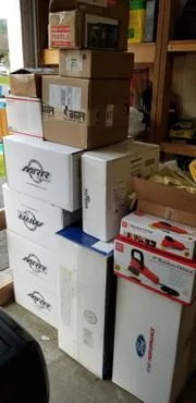

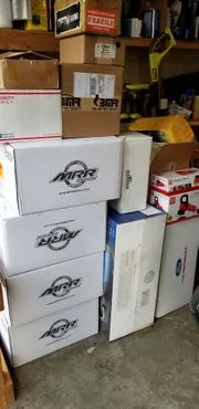

I know this is an older thread but I thought I would give an update on my plans and see if I have made any mistakes or am missing anything. Looking at my list do you see anything I'm missing?
  • MRR 19x10 square M600
  • Ford RacingTRACK STRUT AND SHOCK KIT (M-18000-F)
  • BMR SP083 springs
  • BMR CB005 Cradle Bushing Lockout Kit
  • BMR BK054 Differential Bushing Lockout Kit (not sure if I need this)
  • BMR SM760 Rear Shock Mount
  • Steeda S550 Mustang Front Roll Center & Bumpsteer Correction Kit (2015-2020)
  • Maximum Motorsports caster camber plates
  • Full Tilt Boogie racing shifter plate
  • BG Syncro Shift II tyranny fluid
What do you all think? I don't think I will recognize my car come spring. I'm very excited to get it going.

Looks great! I would go ahead and add an adjustable front bar. You can leave the rear bar as is.
Last season I added the Front Roll Center & Bumpsteer Correction Kit and then an adjustable front bar, and both had noticeable affects. (The effect was big enough that I feel I really should update my review on another thread.) Anyway, with the above setup, I think you will find that you want more front bar.

Transformational! Love the MRR wheels too. I would only forgo the diff bushings, unless you’re a serious racer. Enjoy!

Thanks for the advice on the front bar. That may have to wait until the next round of things. I'm not sure my wife would be happy with another box of car parts showing up at the door about now.

Definitely not a serious racer. I just got the kit for a good price from the classified section. Will it cause any negatives to install?
