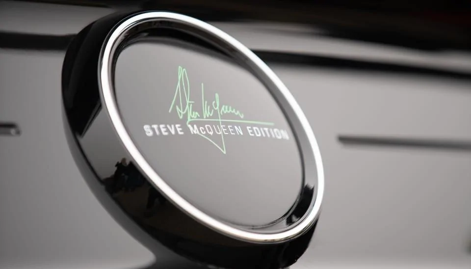

Also, we just had some nice feedback rolling in, in regards to our Steve McQueen package that carries a lot of the parts mentioned above ... this is what Richard said - "Truly blown away!"
