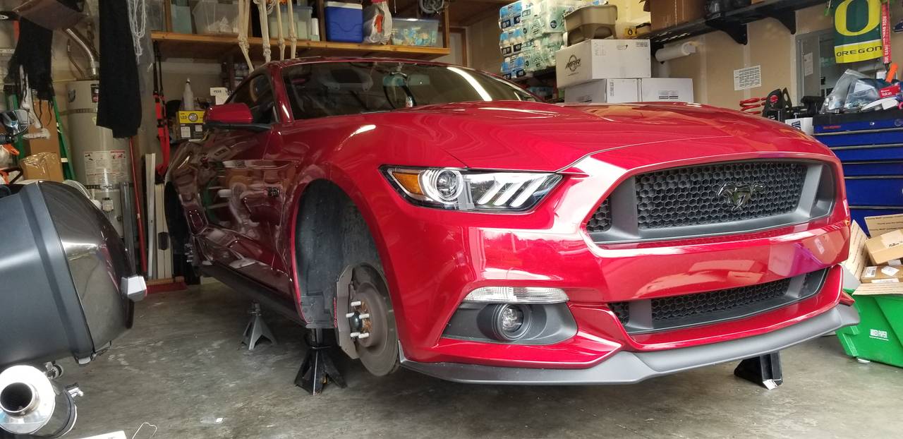

Well with nicer weather on the way (hopefully) and the stay at home order I figured now would be a good time to work on the suspension. Got the car up on jackstands and the wheels off. Not much progress but there is no need to rush. I'm not going anywhere for a week.

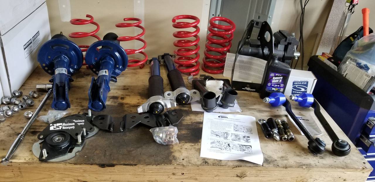

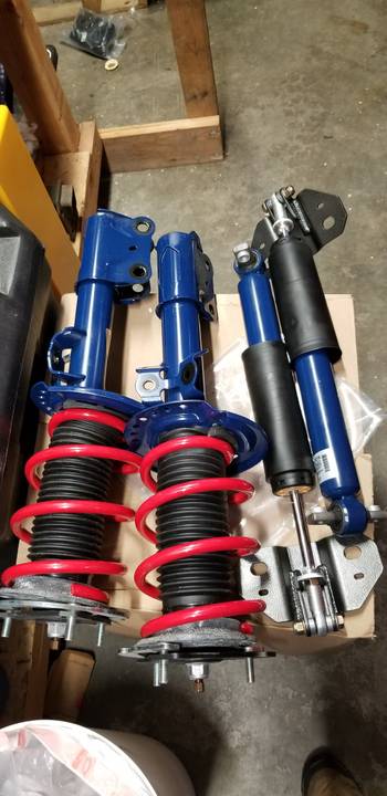

Didn't get as much done today as I had hoped. The wife had a to do list for me so if got a late start. Basically just got the shocks and struts put together.

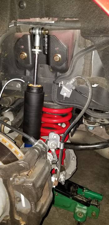

@BmacIL @Bluemustang Quick question for either of you. Is the rod end supposed to be able to move freely and smoothly? When I tightened up the bolts holding the rod end to 45ft-lbs the rod end became difficult to move around. I can move it around by hand but it's not smooth and easy like I expected.

Are you talking about the BMR rear shock mount? As long as it can articulate about the bolt axis freely, and can move around off axis, it's fine. It'll loosen up a little bit over time.

Yes, that's what I was talking about. Sorry about my poor communication.
Thank you!

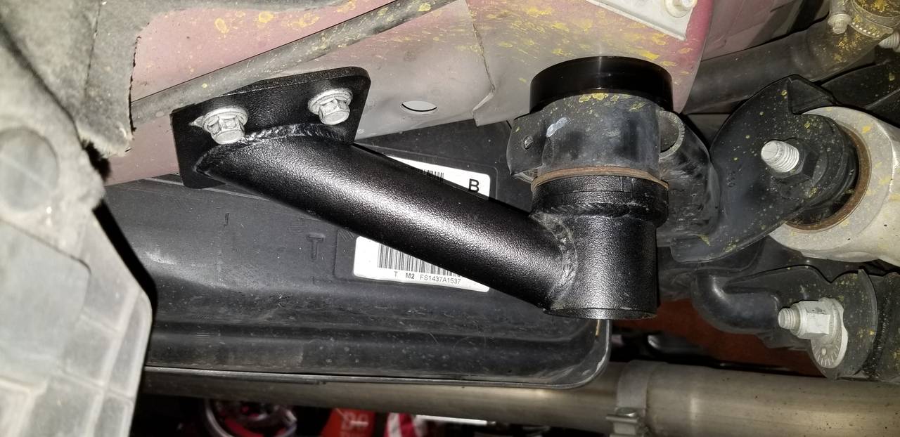

Made a little more progress done today. Got the rear springs, shock mounts and CB005 installed. Still need to get the suspension loaded so I can tighten all the bolts up.

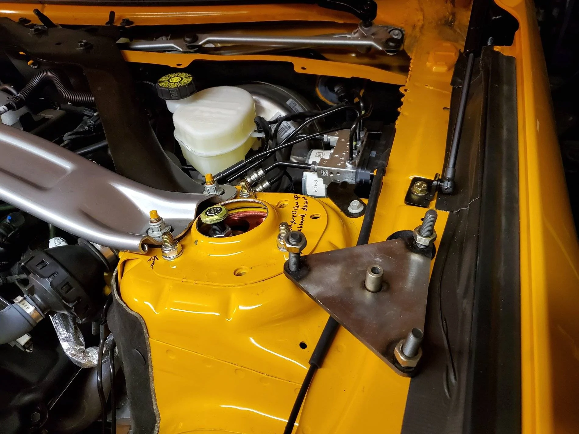

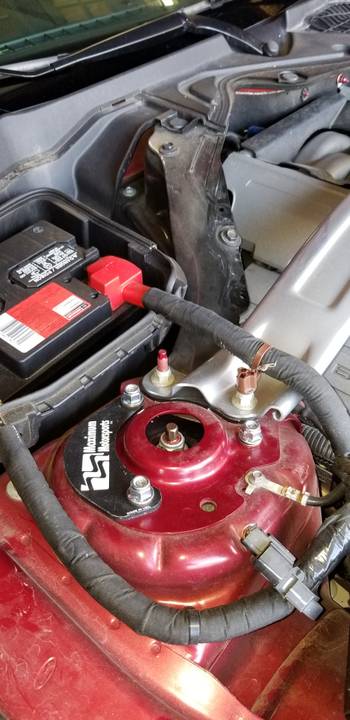

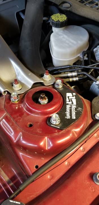

In the front I got the driver side strut in place and the Maximum Motorsports caster camber plates. I reused the strut to spindle bolt and nuts but I think I'm going to get new ones. I hope they have some locally.
Also do the caster camber plates move much in caster direction? They seem to move quite a bit side to side but very little front to back. Is that normal?

If you are putting in a lot of camber and need to see the camber plate lines I have the Vorschlag jig to cut the towers open.

I don't plan on putting a lot of camber. This is mostly a street car. If it sees a track it will be rare.

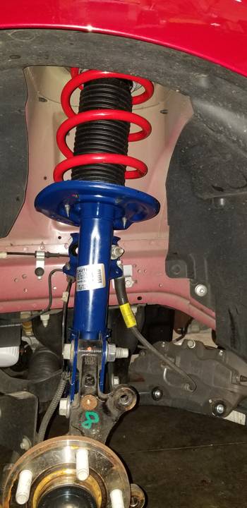

2017 PP Mustang GT - Ruby Red

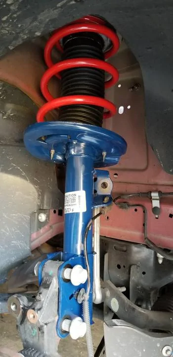

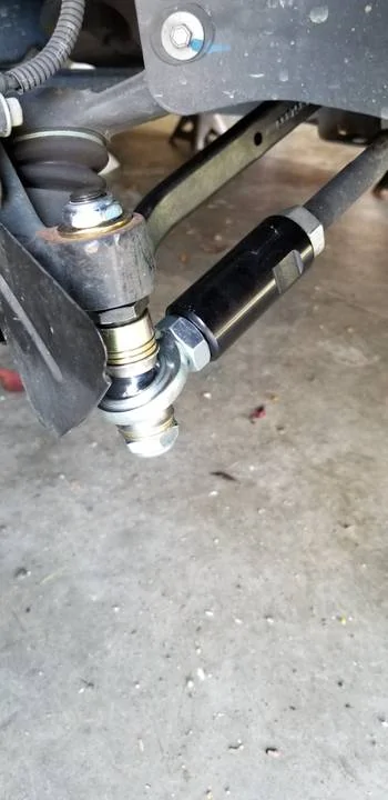

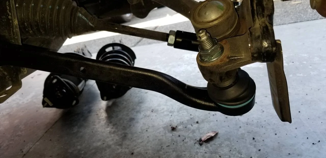

Got a little farther along today. Struts , camber/caster plates, lateral link and bump steer kit. All in place but not tightened up. Waiting for newer lower strut bolts. One of them required a little more hammering than the others.
