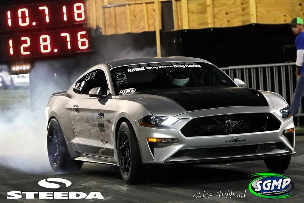

Yes, they would work extremely well with their advertised rate.
One thing I would like to point out, is that the rear Ford P/P rear damper is a
high pressure monotube design. The Steeda rear damper is a low pressure Twin tube design, therefore it will give you a better ride quality. On another note it, has ample control for wheel hop as noted in our 2018 10.71 record run.
