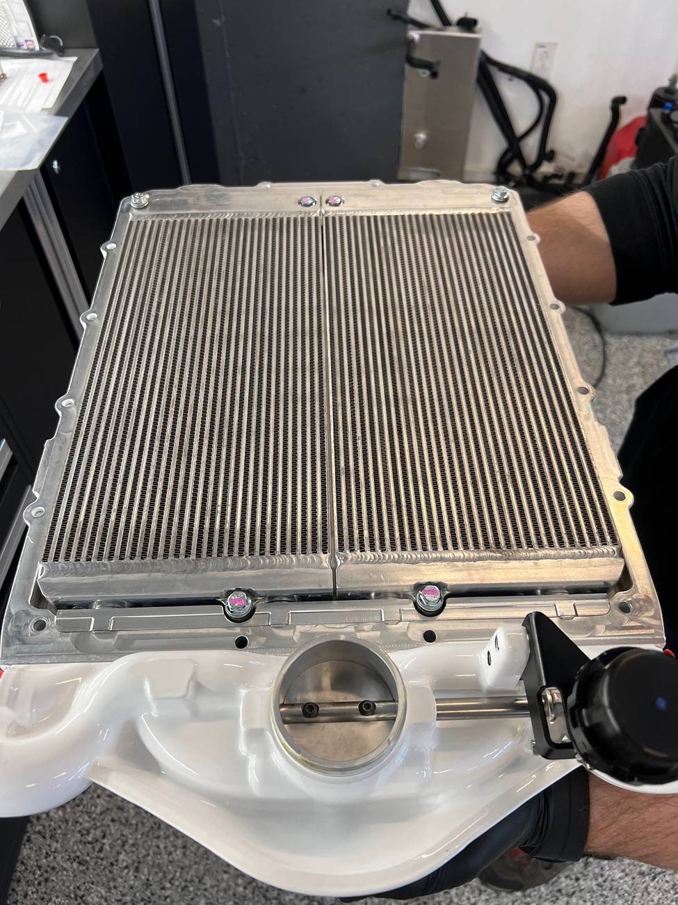

After my FI interchiller setup, when I mash the IAT2 goes DOWN not up. When cruising and the blowe is largely in bypass, the IAT2's still hover just above ambient (once it's fully heat soaked) but once I mash the go lever, I can watch the IAT2's start dropping........quickly.
It's a weird phenomenon that I've tried to make sense of, but I guess with the motor at low load, the air charge doesn't have enough density or dwell time to get fully cooled as it flies by the intercooler core. Once the air load goes higher and boost is created, it must somehow greatly improve the thermal transfer inside the intercooler brick.
I have yet to install a temp sensor on my IC system so to have all the information that's probably a next step at some point. I just don't have any external gauges outside of boost gauge anymore (Ngauge is gone) so I'm not sure where I'd send the output and I don't want to add to the instrumentation.
Point is, I'm seeing IAT2 drop under a pull, not rise.
FYI that happens on my 3.0L Gen5 Whipple with no chiller. IAT2 is lower at the end of the quarter mile than when I started. Key is proper brick size and the Whipple delivers in spades.
