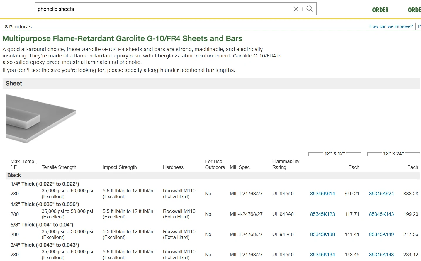

I also looked into what they would cost to make before justifying my purchase.
For reference:
Below is what a sheet of generic material can cost. Not sure if a set of coyote spacers (turned 45*) will fit on a 1'x1' sheet.
The eBay spacer was probably made from a 3/4" thick sheet. Expecting a high quality 15mm spacer out of 5/8" would be risky.
Phenolic is not the easiest to machine. It's abrasive and its heat resistance throws the heat back at the cutting tool.
For reference:
https://www.mcmaster.com/products/phenolic-sheets/
Yes, any plastic type material can be tricky to cut.
I work in a machine shop but unfortunately we are setup to make round parts or I would have made them myself. We even make parts out of PTFE.
For reference:
Exactly. At that thickness, price it's just more expensive.
This 100% and 1000% all facts and is the truth.
