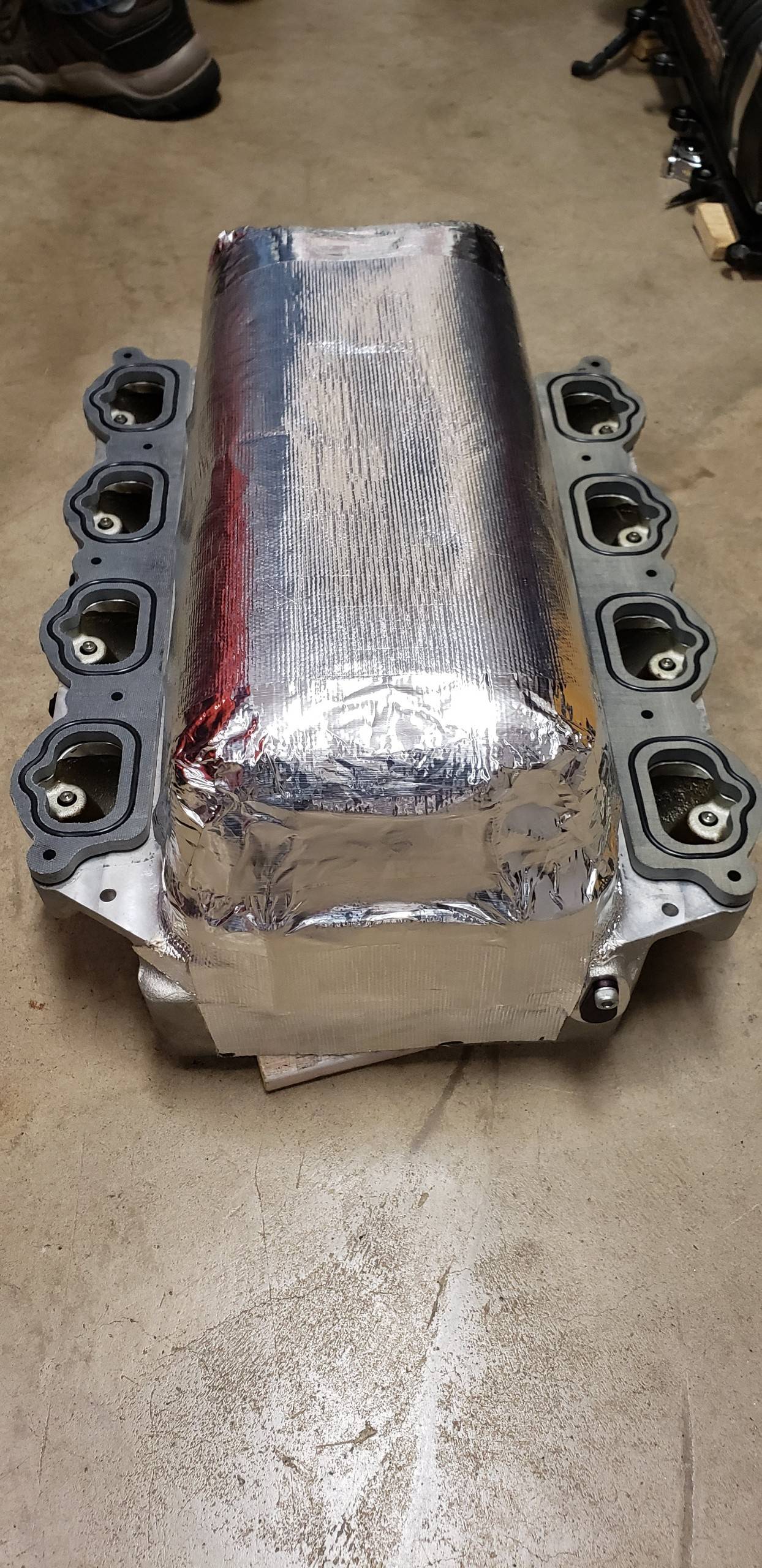

Upgrading to a 170 Reische T-stat, adding MFP phenolic spacers, and making a custom supercharger blanket from spare work material netted a nearly 30 degree drop for my gen 2 stage 2 whipple with standard heat exchanger and stock fans.
I believe Paramount Speed or Juggernaut Performance may be able to get you the MFP phenolic spacers.

echoing what has already been said.
Roush setup on gen2. stock IC using the dinky bosch 5gpm and 3/4" thick HE. spacers and heatshield products adhesive backed intake manifold blanket like @stang17 did.
20-30* above ambient/iat. Dropped to 20* under wot or heavy throttle. Never heat soaked. Hours on the highway, hour stuck in bumper to bumper traffic in 100+ heat. Didnt matter. IIRC maybe a 5 degree increase during a 2-4th pull.
After upgrading pump and HE, all the benefits listed but a new level of stability. IAT will rise higher than IAT2 now. IAT2 sits right around 15-20 above ambient. on throttle lift after a long pull temp spikes to maybe 5 degrees vs 15+. Recovery time is maybe 10 seconds?
Paramount should stock them. I picked up local at their Mansfield location. Would never install a PD blower with out after my experience.
