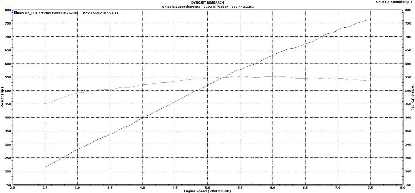

I've never understood the argument over PD's having better low end over centrifugal & even turbos (it's senseless). Think of it like this if you're sitting at idle & mash the gas you get an instant hit of power with a PD car yes, is it more than a Centrifugal or turbo yes. Ok here's where things get good, by the time these cars cross a certain rpm the Centrifugal/turbo cars equal the PD cars in power & torque it's usually around 32-3600 rpms rang. Ok from that point the Centrifugal/turbo cars are steady getting faster while the PD cars are slowly dropping off in power. Ok so let me ask you this question, would you want more instant power that you really have a harder time utilizing for first 1000-1500 rpms or would you want more power for the last 3000-3500+ rpms? Another fact, when you are changing gears your car is not dropping back down to the rpms where the PD car has more power guess what it's in the upper rpms where the Centrifugal/turbo has more power. This is not even considering the heat soak a PD cars has over the Centrifugal/turbo cars add that & there is a clear winner.
Im not just stating MASHING the gas as you say at idle and enjoying some wheelspin. Light and part throttle, the car feels like a low revving pushrod engine. It actually has useable driveable power down low for everyday use without going WOT.
As for PD car's dropping off in power at 3500ish rpm? My power curve is a straight line all the way to 7500 rpm.
IAT's also better than stock. I usually see a few degree's lower than ambient driving around. Sitting in traffic it might go 10Âş over ambient, but quickly drop when i start rolling.
I think you need to do a bit more research on the newer PD blowers on these cars. Can you make more power with a centri/turbo? Yeah, sure. At this level it's really negligible. There's some PD guys on 93 making 700-750whp. I'd be up there as well if I didn't have a Lund tune running 16Âş timing... But anyways better driveability around town, and just a pleasure to drive. I really cant stress enough how well the pedal feel is now and driving around(out of boost)

No power dropping off here!

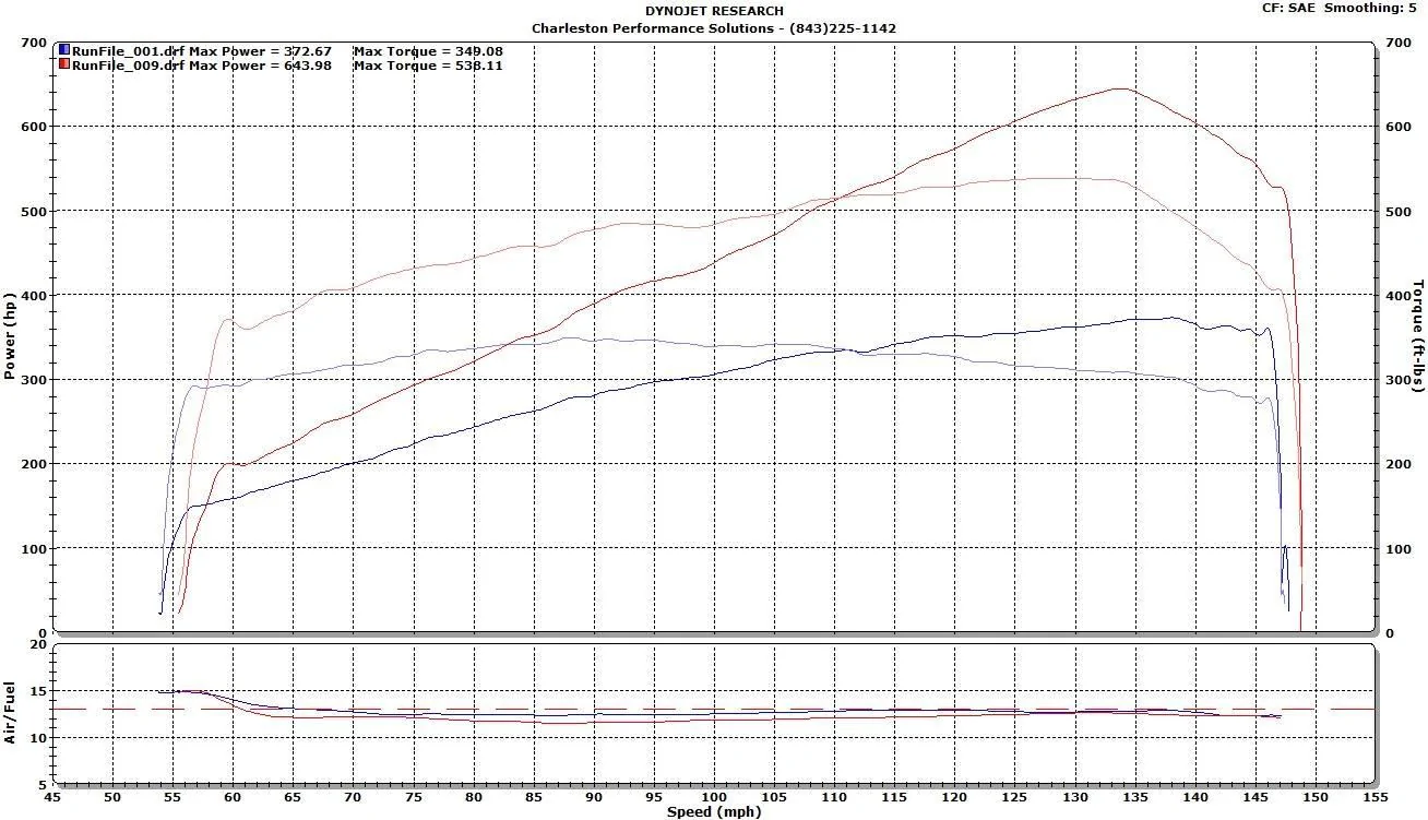

Ive been reluctant to post this here because of all the power dropping off threads ect. Rest assured, thats not what is going on here, this was an intentional roll off the throttle at around 6600, 6700 as I had an extensive amount of software and hardware inside the car monitoring everything, this car was running out of fuel due to not having the supporting mods needed for the power it could make. When a fuel pressure needle starts going backwards, you get out of it.
I am posting it here however to allow insight on how differently the blowers make power. This is a paxton with a 3.8 pulley and ID1000s, otherwise the car is completely stock. fuel system, exhaust ect ect. this was a 50/50 mix E85 and what I suspect was 91oct. In order to compare it to the dyno sheet above you have to consider the x axis is MPH and the correction factor is SAE which for obvious reasons reads lower the pull was started at 3k and I rolled out at around 6600 rpm.
The other pull is the same car bone stock.

Aw man look what I've started, it's turning in to a witch hunt. First let me be clear [MENTION=16505]Obsol3te[/MENTION], what I said is Centrifugal/turbos meet a PD car in power usually around 3500ish rpms, not that the PD drops in power there.
2nd I like PD I really like Whipple 2.9 it is a bad ass on this lititle 5.0 & DOES carry to red line in a certain efficient rang or should I say power level. But after that it will start to taper off, that's why I said 90% of people will never drive these cars to the max meaning if you make 750 whp with your whipple you are a happy camper. But if you start spinning the Whipple harder & faster out of its efficiency rang you will see heat soak & lose power.
