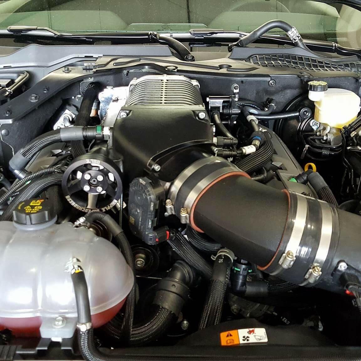

Stage 2 Whipple FTW! Here you can see our car with the stage 2 kit with ID1000s and JMS BAP making 850+. Shoot me a PM if you need any pricing!:headbang:

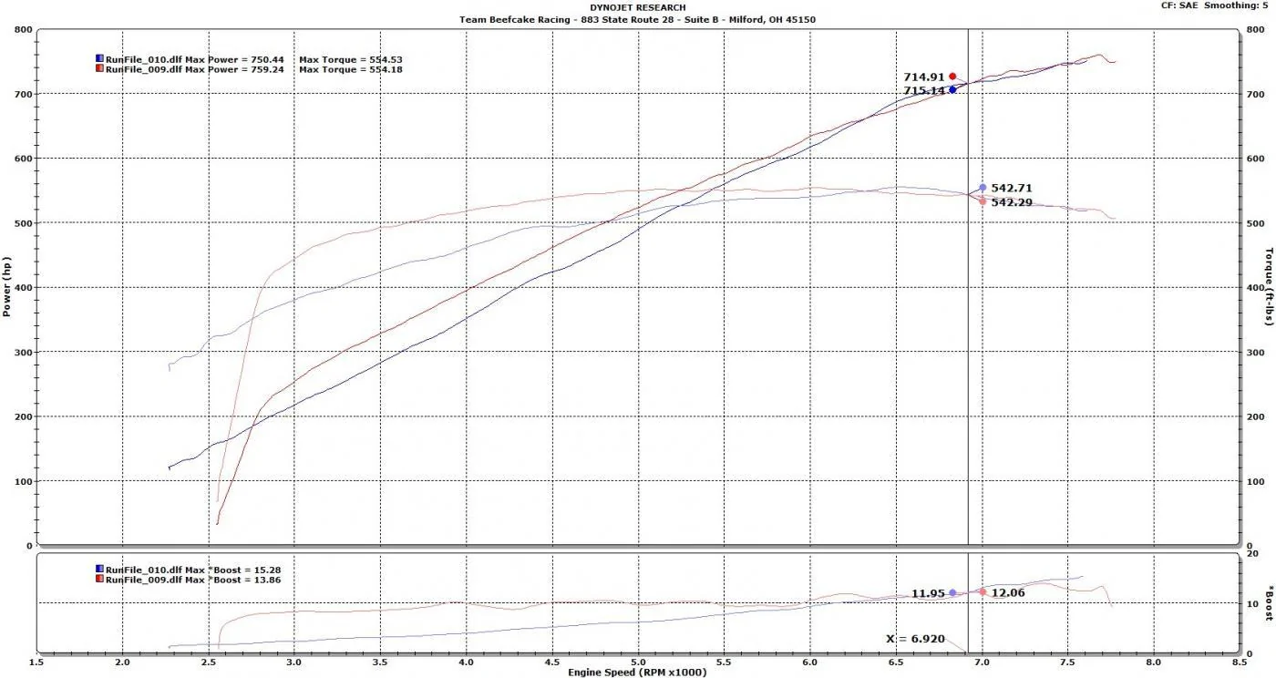

Funny that Beefcake mentioned his installs. I was going to post the dyno charts from his recents Vortech and Whipple installs from his threads but I wasn't sure on the rules about that. They just show a good representation of the power curve difference between the Whipple and a Paxton 2200/Vortech JT. Not exactly the same peak boost but you get the idea.
http://www.mustang6g.com/forums/showthread.php?t=60173
http://www.mustang6g.com/forums/showthread.php?t=61020
i'll do you one better, and overlay tom and joes graph, i highlighted where the boost is almost identical, and if you look at the numbers, they are so crazy close it's ridiculous.
the whipple is stronger down low, but there is more boost there.
thats why i always say it comes down to driving style, and how you want to drive the car.
some people want more low end, some want more stock like low end.
at wot, both kits run very similar from that 5k plus, which you'll never go below at wot.
you just have to decide your driving style.
both are custom setups, both have our e85 fore setups, and ngauges with lund tunes.
you'll spend a little more on the whipple to get that low end,
again, pick your driving style, and let us do either setup for you :)
i know lots of guys claim 50+ installs, but at the end of the day, were one of the few places you'll see actually posting consistent installs, and graphs.
we do more blower setups than anyone out there.
we have another whipple stage 2 coming in next week with their tune, and we have a 3v whipple install going on this week.
Well that makes it a whole lot easier. Thanks.

Just did another Whipple and have more coming in for install. This was a stage 2 with Whipple tune and fans among some other non power bolt ons. We still love the OEM quality of these kits.
But you'll be happy with any kit you pick up, all make more power than your engine can handle or have the capability to do so. Our Whipple kits are our most popular option to customers but we offer all the packages and under one roof:)

Well now your painting a different picture, but your clearly indicated PD compressors start to drop off at midrange levels around 3500 rpm which is not true on this motor. look at the dyno graph posted power keeps climbing to 7500 even 7800 rpm in whipple 2.9 case. Hell just look what lethal just posted with their 850whp 150 mph 1/4 2.9L whipple, and that's a stock motor with long tubes.
