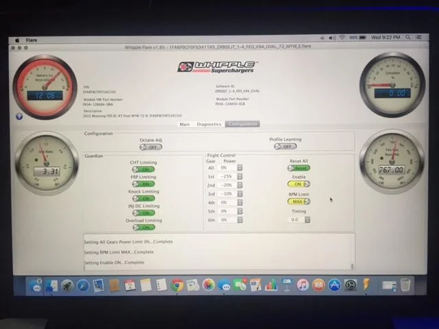

Not with Whipple's Flight Control that is standard on S550 complete kits :thumbsup:
All kits will run really good but you have to think about how you want the car to make power. A Whipple will offer near instant boost and torque, and with the Flight Control software, you can adjust power output by gear which makes controlling that torque more manageable. The nice thing about the Whipple as well is that not only does it deliver instant boost and torque, which makes driving around town much more fun and passing on the highway easier, it makes HP similar to a centrifugal where it keeps climbing and climbing all the way to redline without showing signs of dropping off.

I dunno it it's ironic, funny, or what - all in a good way - but we have some Centri's like Beefcake's offerings (and probably others) using a wastegate to make a Centri act more like a PD (and I'd add the Procharger i1 which is not yet available for S550) and now, with Whipple's flight control able to configure a Whipple PD to act more like a Centri.
