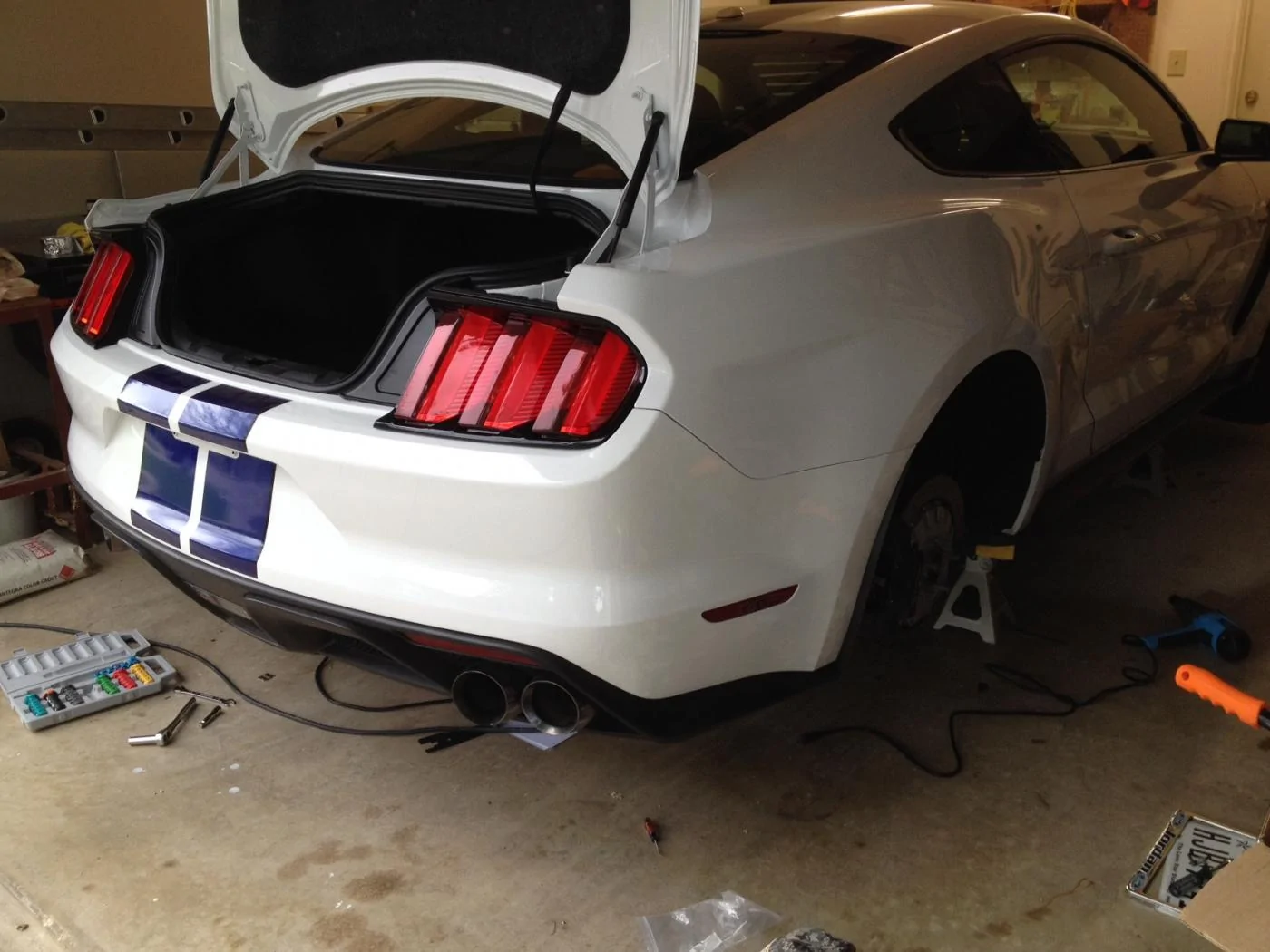

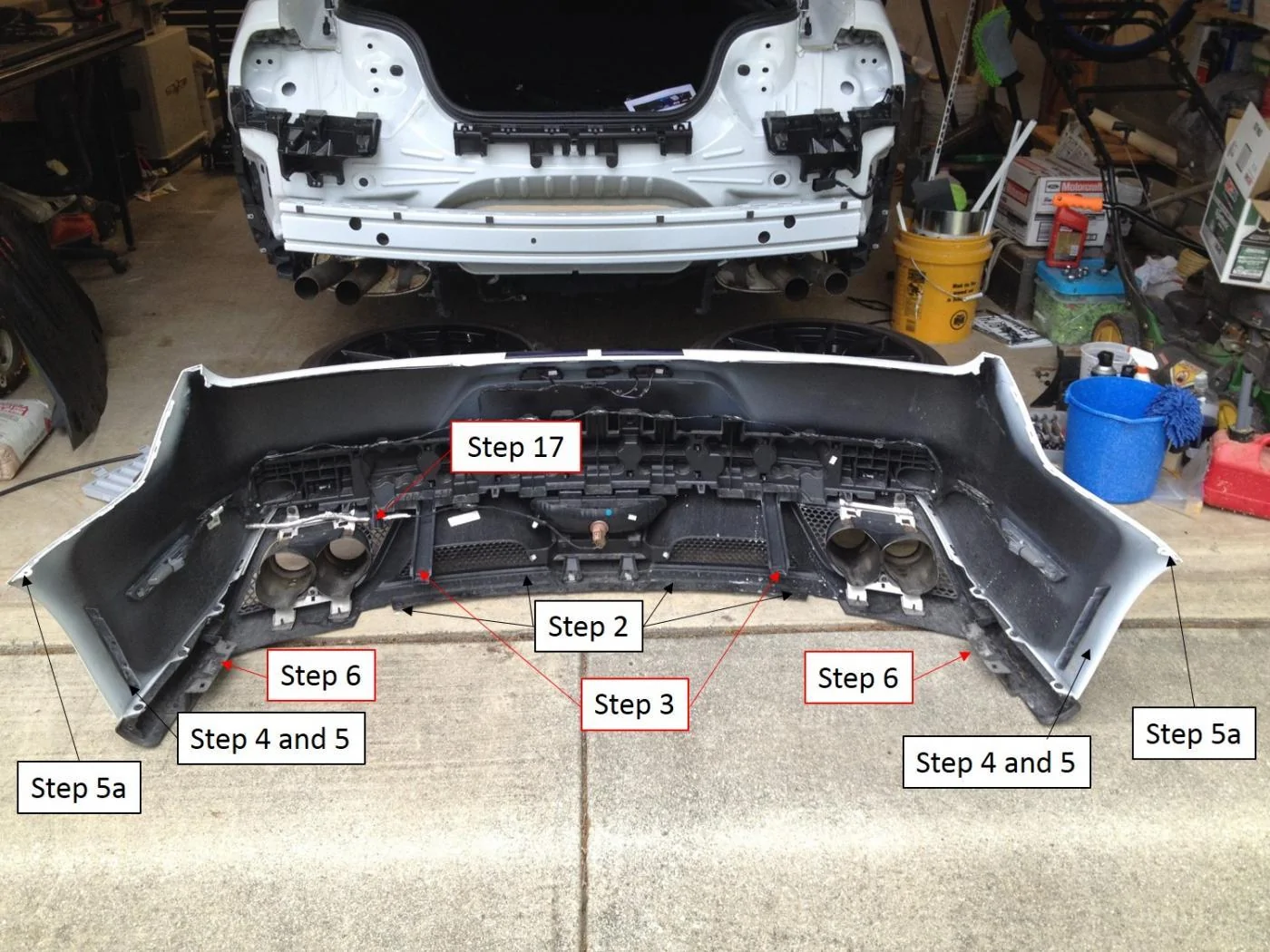

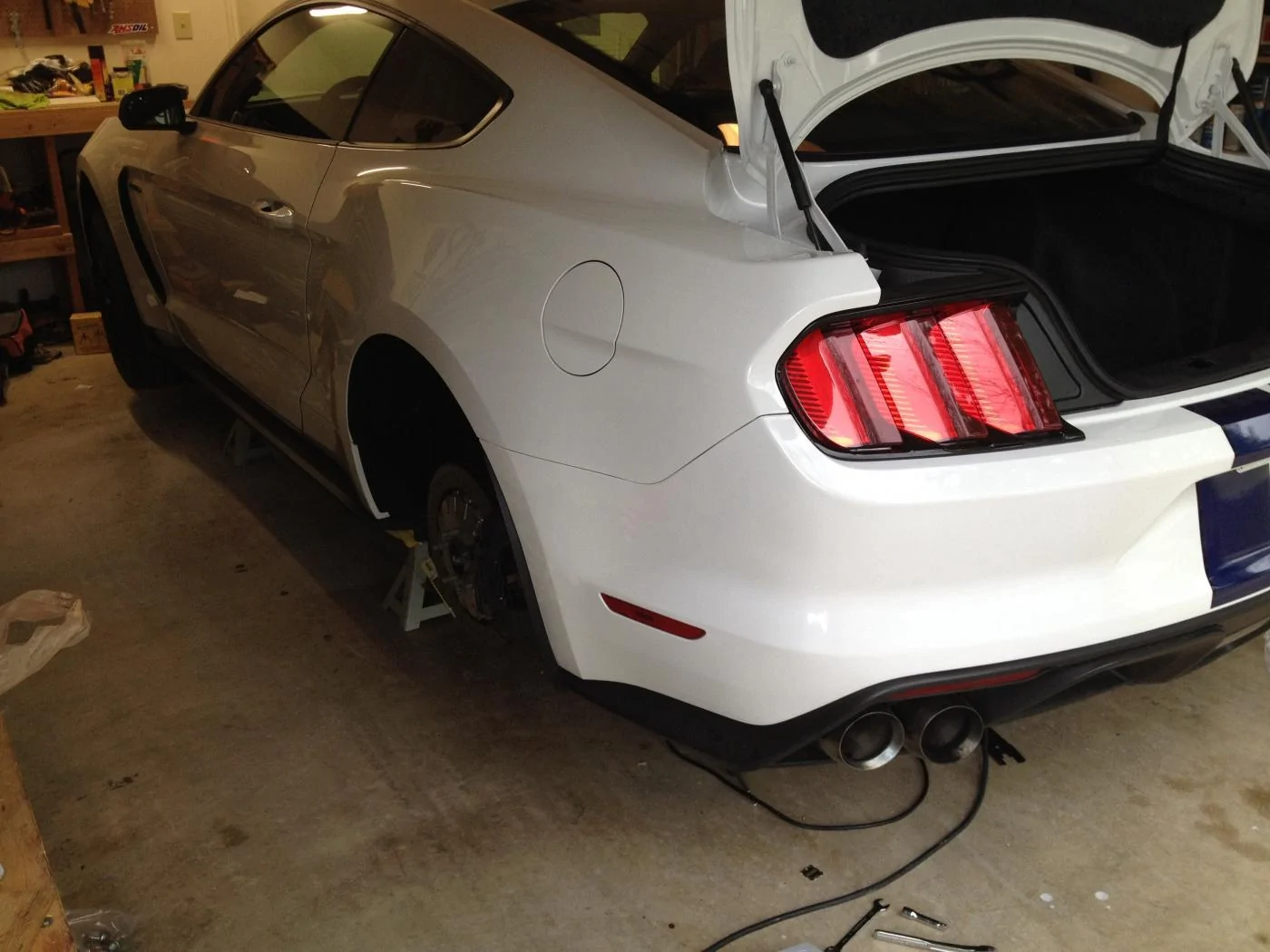

So, I did this last weekend while replacing the right tail light - which was damaged when I took delivery of the car. Dealer finally came through and provided the part after much debate - even though I had time stamped pictures at delivery.
Anyway, here are some pics that might help with install. Step numbers on images are references to [MENTION=11290]xXANCHORMONXx[/MENTION] steps. Big thanks to him for sharing the relevant steps to fix the gaps!

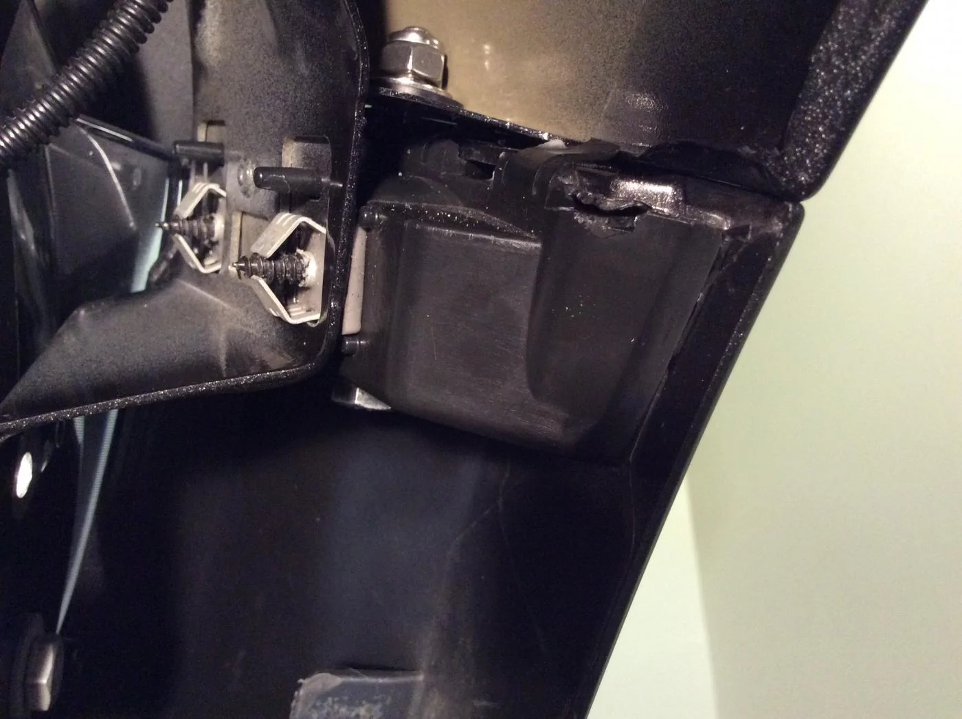

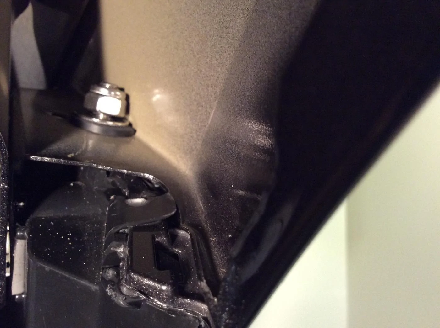

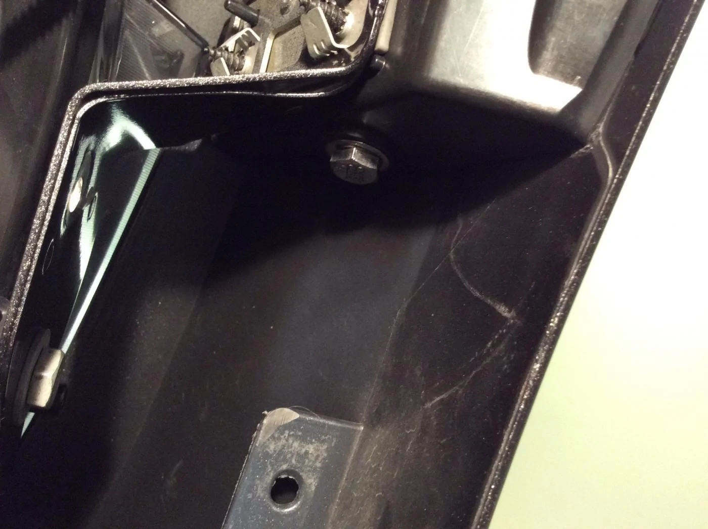

If i may add for those looking to solve the front fender to bumper gap, here is what i did to fix mine.
Removed front passenger wheel and plastic liner to gain access to screw that holds the two pieces together.
As you can see in the pic, i drilled a new hole and install a long stainless steel bolt and nylon nut through that existing plastic piece which already has a screw
holding the bumper to fender together.
The plastic part on mine was broken, so i had a big gap which is now fixed by doing this simple trick.
No way was i going to go to Ford with this issue and risk having them remove the bumper.
All is good now.
