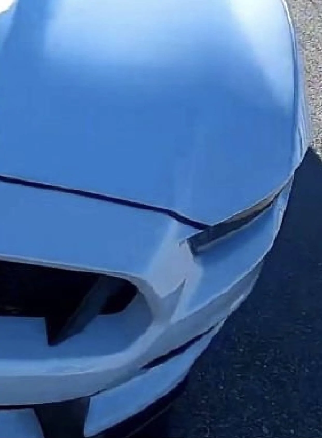

Is this too much panel gap?

Car fax checks out, but wondering if this is this a concerning amount of panel gap between the bumper and hood that could mean it’s had any previous damage?

Bad picture. Looks like the hood is open actually.

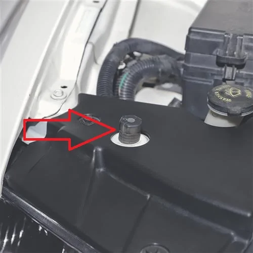

Easy adjustment with the hood bump stop on that side. Could also have them adjust the hood some too unless it's a private seller.

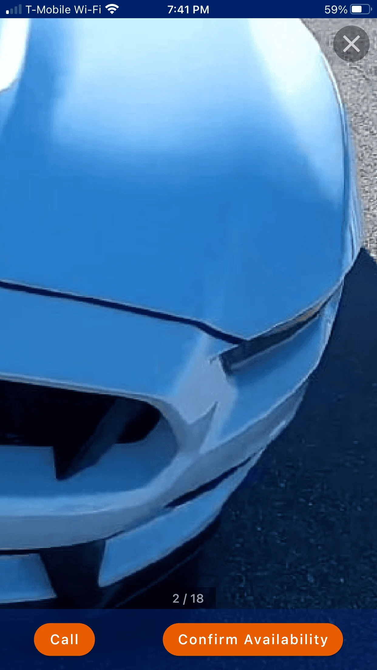

Terrible photos from the seller but, here are two more. I thought the hood was popped as well..

Pictures are bad as others have stated. Aside from that, there is a rubber gasket between the hood and the bumper cover on all S550's. On some depending on picture angles, it can appear as a "gap" or may look smaller/larger based on exterior colors and if the rubber is exposed more or less.
I don't think there's an issue with the appearance of the gasket.
If panel gaps bother you, I generally suggest you don't buy a Mustang S550 without seeing it first. They almost ALL have issues to one degree or another.

That’s a big gap even for the hood. On my 2018 GT the gap at this same location was much smaller.

6 characters on custom plate might limit me to “DATGAP” which could still be a contender.. PPI is being scheduled as it passed the OASIS check

You can try to adjust the hood using those rubber thingies.
