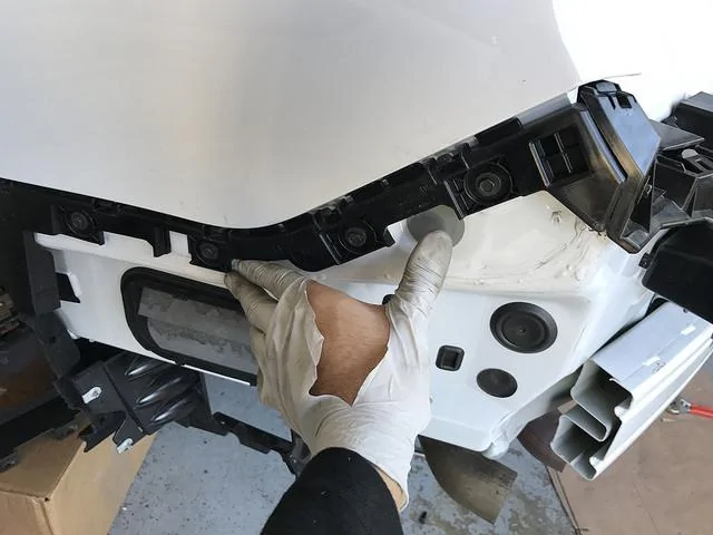

Those black plastic brackets on mine were all loose. Two screws were just installed and not tightened at all.
I pushed the brackets up tight and then tightened the screws. Shouldn't move again.

So it has begun. Up until two weeks ago mine were fine. Today I have a good almost 1/2"+ gap on the driver's side and just under 1/2" on the passenger side. Looks like I will be taking the bumper off next weekend.
Has anyone noticed if their trunk lid center section is off on the driver's side? The black plastic center section where it meets the taillights just above the bumper. My passenger side is completely flush and the driver's side is sticking out about 3/8". Saturday at Cars and Coffee there were 7 GT350/Rs. All but one had the same issue. Some were worse than others but on all of them the driver's side was sticking out and the passenger side was pretty much flush.
I'll take a pic tomorrow and post it up along with my new panel gap.

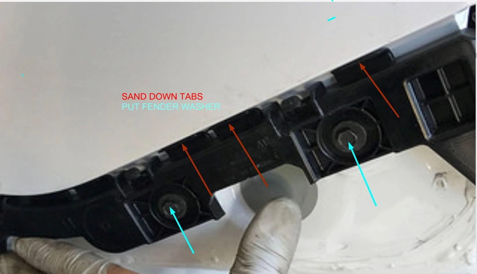

read this someplace.... the tabs by the red arrows needs sanding down too close that part of gap
Also install fender washers under screws, Clean paint under hanger [scotch guard] and put a few drops of ABS Epoxy to keep hanger from moving

Question - for those who have done this...how's it holding up? Any issues or additional tips? Thanks!!

I do believe the guy that originally posted those pictures of doing this when asked sometime later said the gap came back just not quite as bad. That he was just going to leave it alone and live with it.
