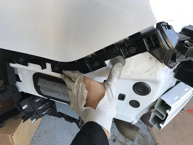

Good write up but one possible issue. What if the whole black mounting piece is what is sliding down over time?
I see what your saying. The brackets in pic 1/2 were both low before adjusting them. Judging by the markings on the screws they did not move but were not installed properly.
Also the tab were I put the screw in does not do a very good job of holding the bumper up which is why the screw was added.

Gotcha. I only say that because when I got mine, the gap was fine, and it has increase over time, so I wouldn't know for sure which component was moving due to the the extra weight of the GT350 specific bumper. If I do this I might put a dab of epoxy on each bracket as well.

That's the beauty of it, the screw only goes into the plastic tab. It goes no where near metal.
You'd probably be ok with the screw but the bumper is heavy. A lot heavier than it looks
Cool, didn't want to put a hole in the metal Haha, still hate holes but I could handle it in the plastic. I'll probably try a couple screws and a little fastener. Basically sandwiching the tab between a top plate and nut block.
Thanks again for the write up. Got it saved in my files. Someday when I get tired of it, or it gets too bad, I'll give it a go.
That is exactly what i did on mine. I ended up using my floor jack and a 2X4 cut to the right lenght to serve as a lever to jack up the bumper while the epoxy was curing.

Just curious - how is your tail light to bumper cover alignment (where bottom of tails meet cover top) and the gaps in between the tails and the center trunk lid panel? What about the gaps near the side of the tails where it meets the 1/4 panel sheet metal - any issues with trying to realign after correcting the bumper cover?

I had my car at the local ford dealership for another repair and they offered to fix my bumper sag while it was there. I showed the body shop manager this repair method and they did it!! Looks way better and I expect it will hold just fine.
