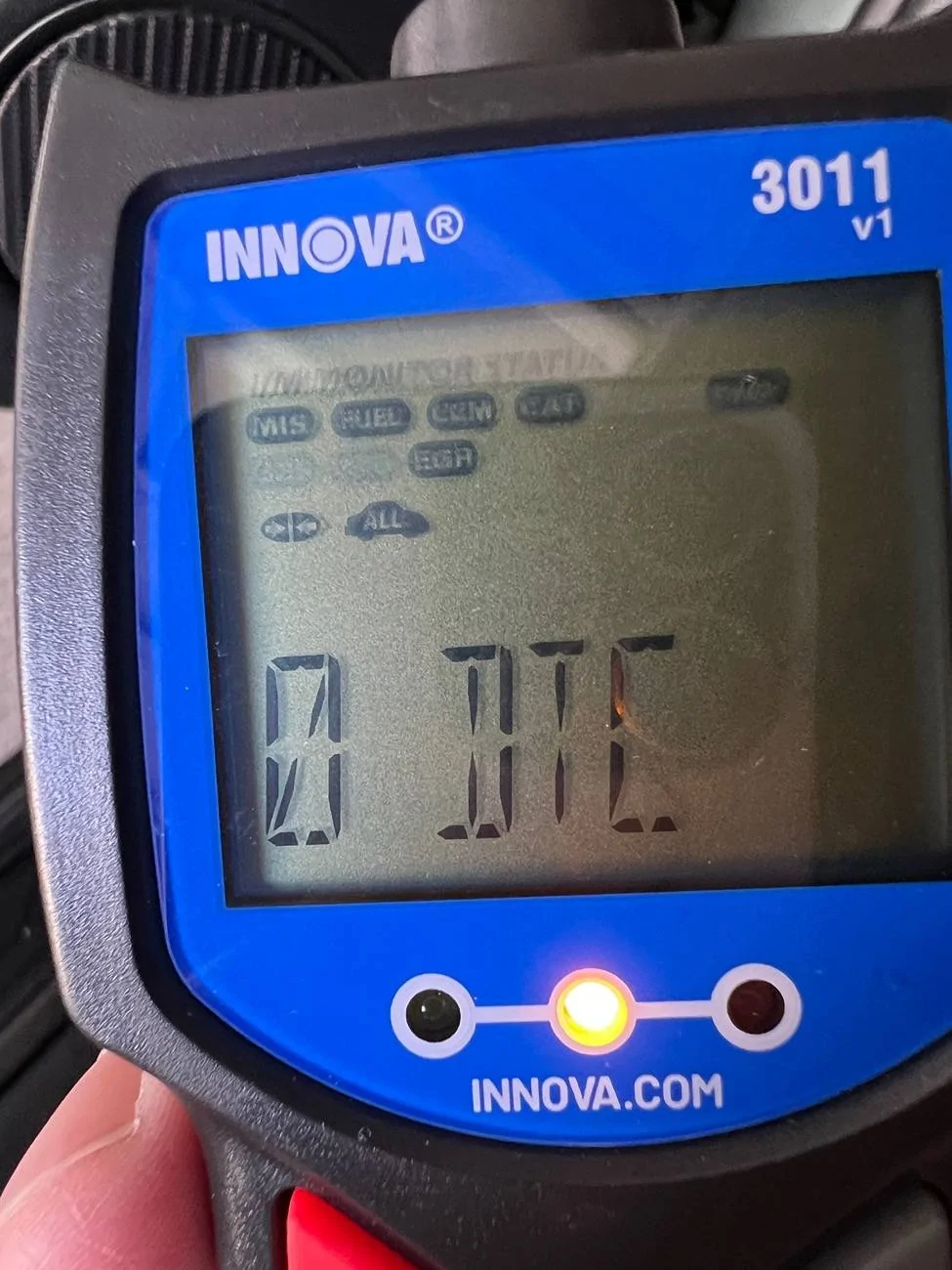

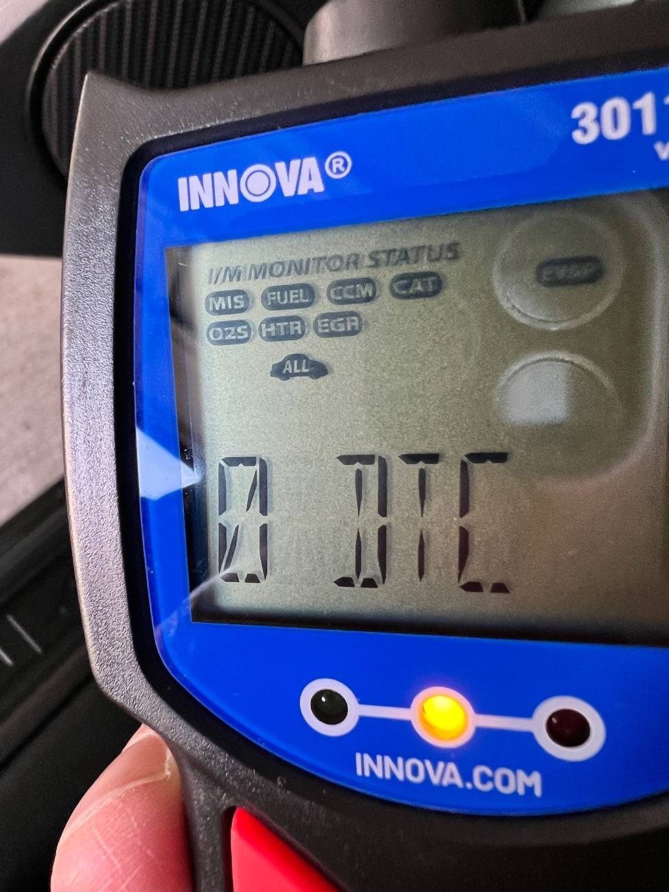

@ORRadtech , I cleared the code by swapping out some evap lines, purge valve and doing the Ford drive cycle, however 2 monsters still haven’t come online. Both the 02 sensor and 02 heater monitors.
It’s the 2 on the bottom row of the upper left icons. (They flash).
As soon as I get those monitors to come back online it’s pass smog
