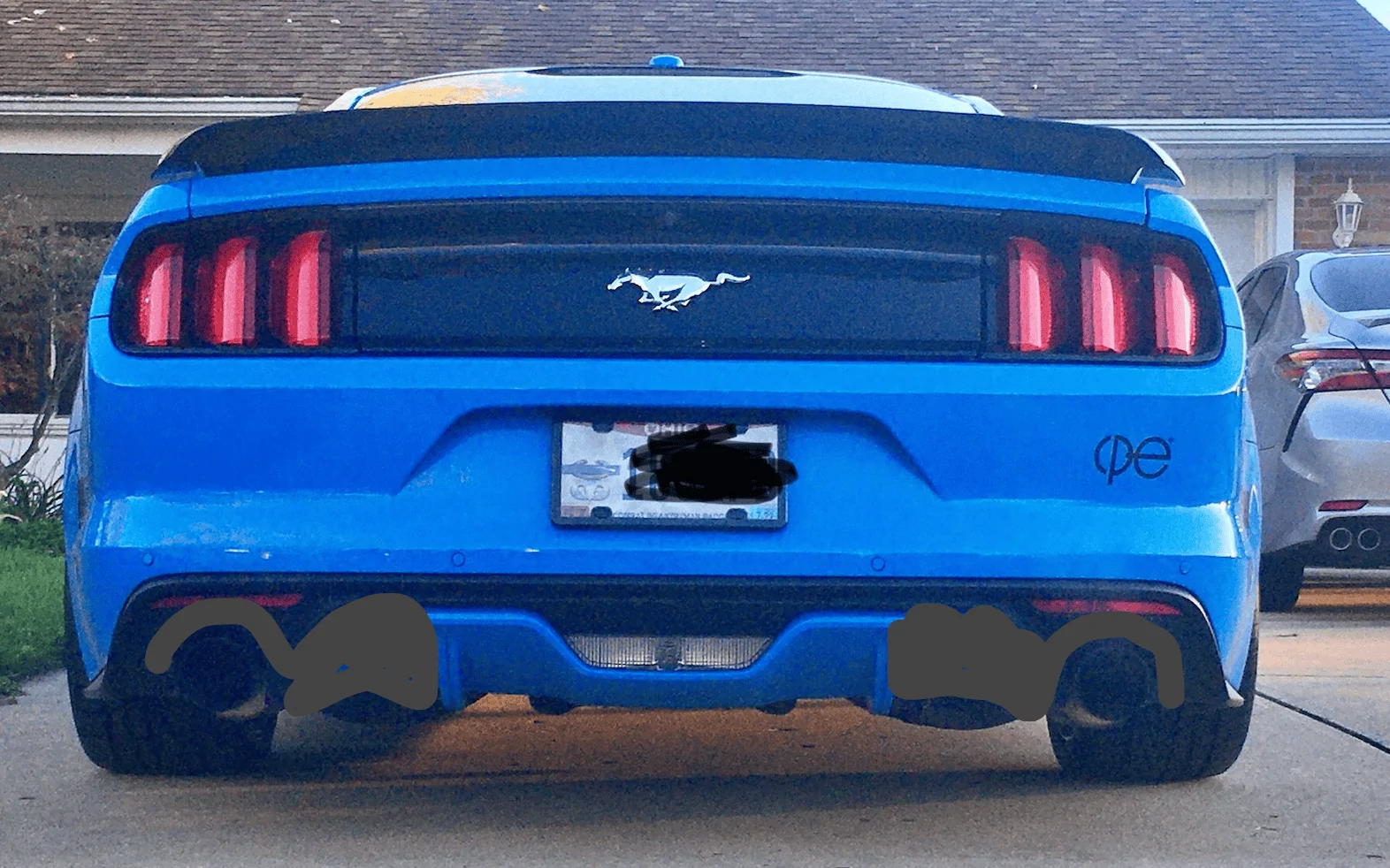

im talking I started getting black residue on the bumper, around it. lemme show ya.
the brown on pic, my bumper was getting sooted up in this area, a heavy dirty coat. degreaser Nine removed it all, easy. but yeah, once I went back to stock downpipes and tune was proper, zero residue ever came back. once I had a device to check trims, I was dumping like 20% more fuel or whatever to compensate for extra flow was all out of whack, it was fixed though.
