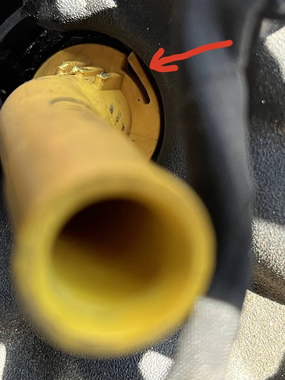

Was able to get part from local dealer, Got it in. Everything looked gorgeous under the valve cover, chains tight and clean. Everything looked perfect. Startup was super lumpy though. I expected it because I had cleaned the crusty ring around the throttle body butterfly. But even so, it ran rough longer than expected. I let it get fully warm, drove it around a little, and it seems fine now.
Question is: Any value in doing a crank relearn? I did not replace the cam sensor. Only the phaser solenoids. Is there any potential problem with doing a crank relearn?
Also, just adding to the thread for any future thread viewers:
If you are struggling with the dipstick tube - know that mine was kind of dirty so I didn’t see it at first. But, there is a clip that will prevent you from rotating it enough to remove. You’ll see it in the pic below. Just use a small screwdriver to release it and the tube will twist right out.
