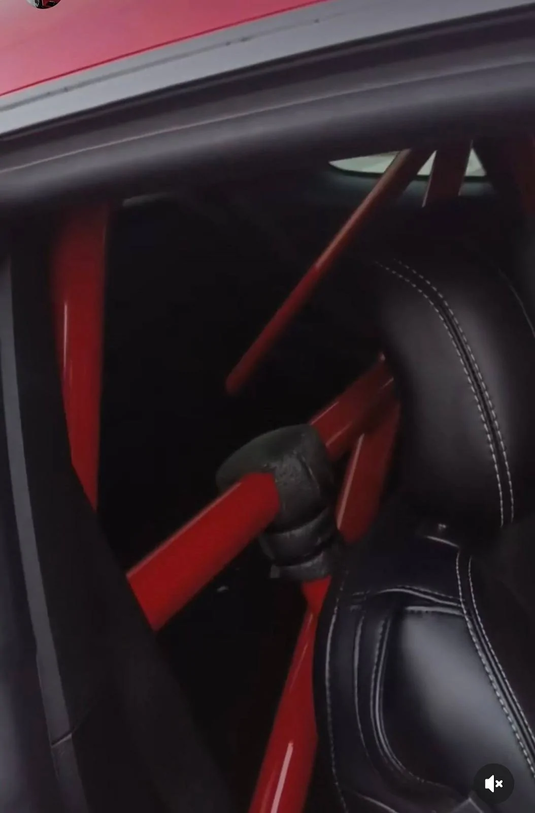

posted without comment...LOL.
Danger Will Robinson!
The harnesses go through the middle of the headrest bars, not the outside, since they can slip over the side during a nasty rollover. This is as described by Joe Marko, the owner of HMS Motorsport in Mooresville, NC... when I did the same thing that you did and he saw me at an HPDE and took the time to help me rerun the harnesses through the middle of the bars.

2020 Mustang GT PP Convertible
well here's the funny thing, I called Scroth directly and they took about 30 minutes to talk to me about the harnesses, I connected them just as Scroth recommended. hmmmm
Yes that is interesting! Joe was very certain that I had done it wrong..
Here is Joe talking about it in a video where he has the harnesses run through the middle of the bars:
Okay I see where he has the belts inside the headrests there. That's an easy fix since I have the harnesses out for non-track season. That's how I divide my driving seasons now, track and non-track. Addicted for sure.
Ya know… I saw that but figured that was probably just after he installed and that he probably wasn’t running it that way. I should’ve said something. “See something say something” when it comes to safety.
Good catch

Presently there are no plans for a "nasty rollover" I just made Intermediate.
I understand thatI don’t think anybody plans for it. After being a corner station worker/flagger for over a year, I have seen bad incidents in all run groups that were not pace related.
can’t really prepare in the event you are following a car and they start leaking oil or coolant. Going at 30mph at the wrong turn can result in serious damage. Also I hope it never happens to anybody but freak accidents are possible.
better to have done it right and not need it than to need it and it not be done right.
Just want you to continue having safe fun is all
Queue the Boromir meme: One does not simply plan for a nasty rollover...
I watched in horror as the brakes failed on a Mustang GT going over 125mph into turn 8 at Carolina Motorsports Park last October. His car went tumbling into the trees. Fortunately for him he had a 4 point roll bar, racing seats and harnesses and was not seriously injured!
CMP management has since removed a bunch of trees and added a ton of sand after turn 8 to help prevent this again.
The moral of the story is: don't try to make the turn if you are going too fast. Going off track sideways is a recipe for disaster! Your wheels will dig into the dirt and flip the car.
If you find yourself going too fast, just go straight off into the sand so that it can bring your car to a halt.
Congratulations on making it into the intermediate group!
And since you are intermediate, I'll pass along the best advice that I've ever been given: The first time you go around the track at each event and you are warming up your tires and waving at the corner workers, remind yourself where you will go in each corner if disaster strikes. Know which corners are your friends and which ones are not, and drive appropriately. Some corners at most tracks have plenty of runoff while other corners are there just to make your day that much less fun.
