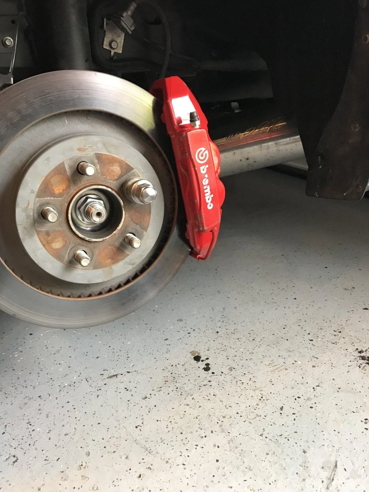

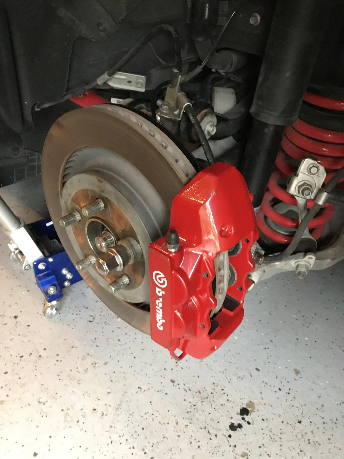

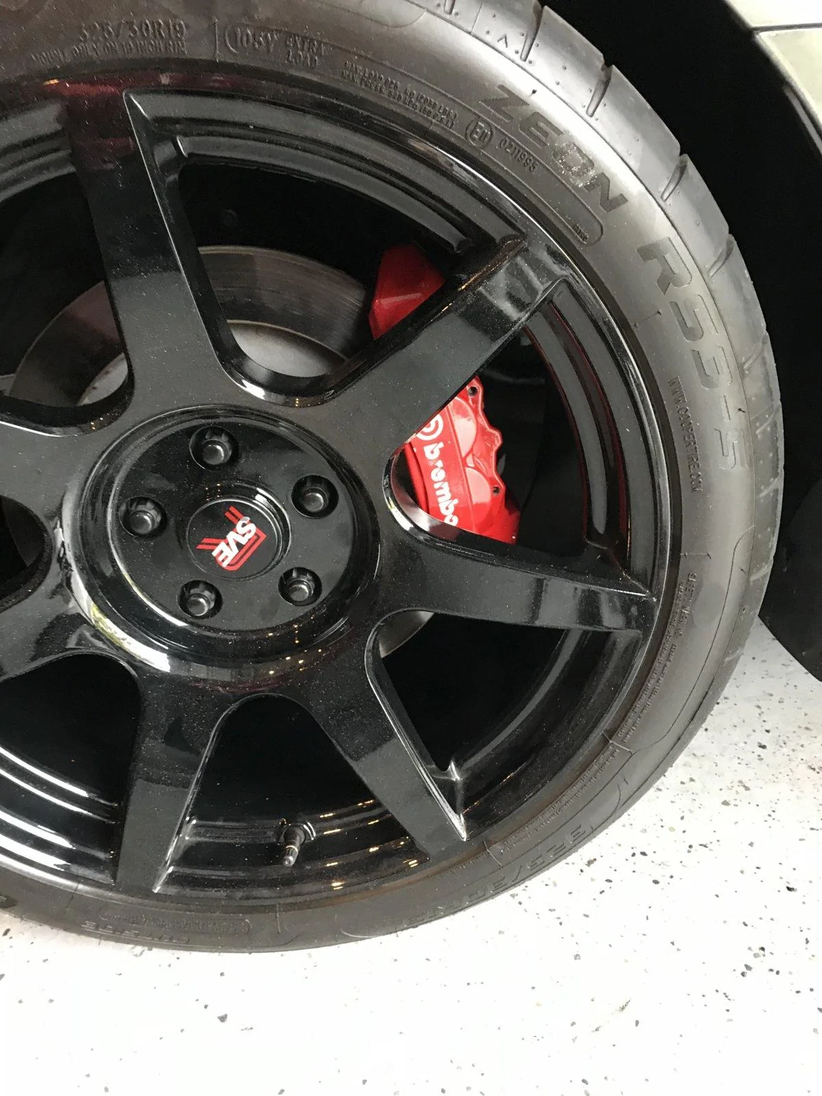

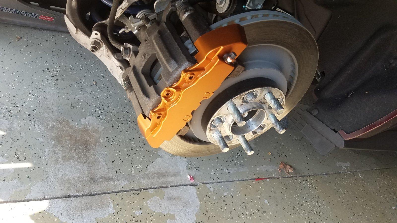

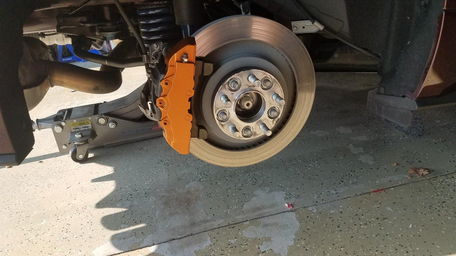

Something I tried just for the fun of it. Ebay calipers covers, a dremal for cutting sand paper to fine tuning, paint for color of choice,and not shown, a "brembo" decal.

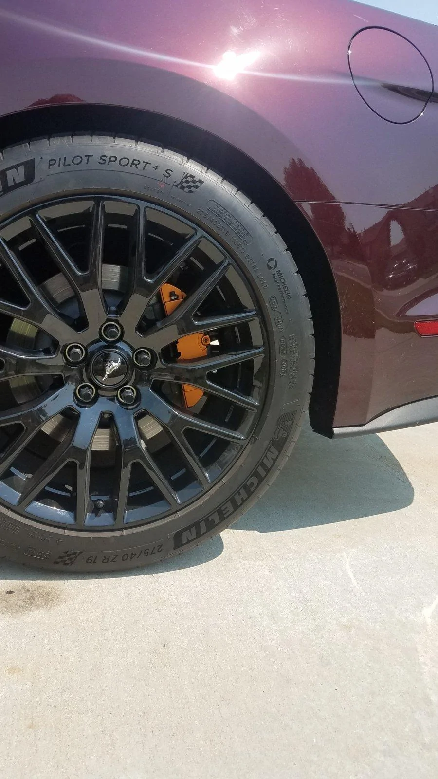

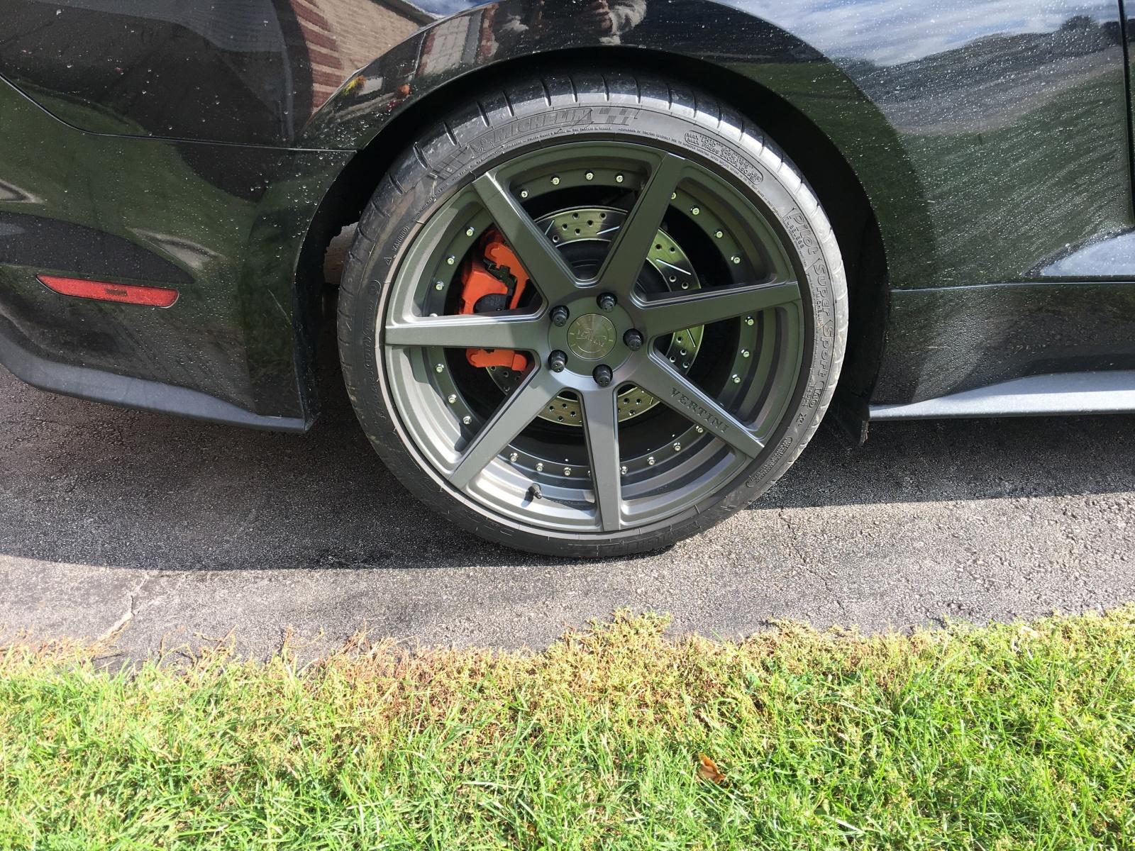

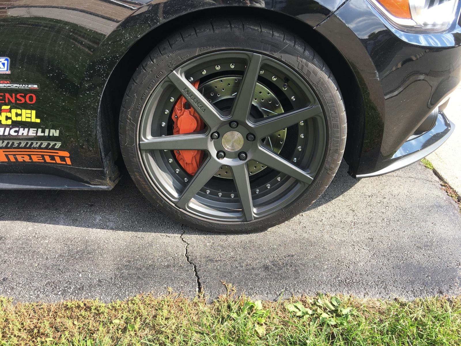

Another option:
(Yeah - the car's dirty. One thing at a time.)

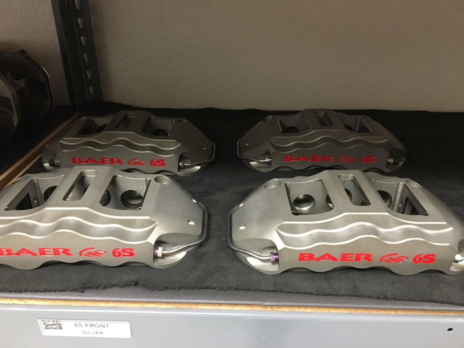

Baer
Wilwood
Stoptech
Steeda
Ford Performance (GT350) for the Rear
All depends on the price you want to pay.
On the cheap, you can paint the stock ones, throw a brembo sticker on there and clear coat it.

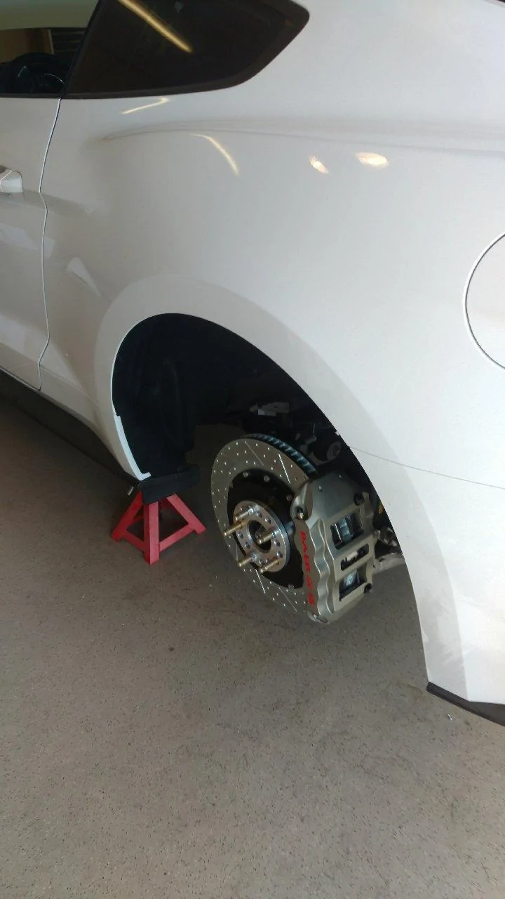

I modified a set of gt350 calipers to fit the stock PP rear brakes. For the e brake I’m going with a mechanical e brake set up.
How did you fit those?

I had the caliper legs trimmed down about 1", re-taped and retreaded so they could fit the smaller rear GT rotors, the stock banjo bolts and brake lines bolt right up to the GT 350 calipers without any modifications.

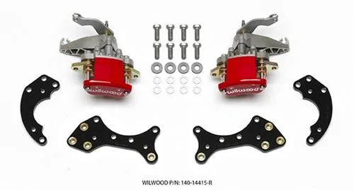

The GT 350 uses an internal parking brake set up, so for a parking brake I ordered the willwood MC4 mechanical calipers with brackets, I am sure I will need to modify the kit to fit but I don't really see a problem in making it work.
I am waiting on the MC4 calipers to arrive, i'll post some pics and feedback once they are mounted.
This is the mechanical parking brake I ordered
