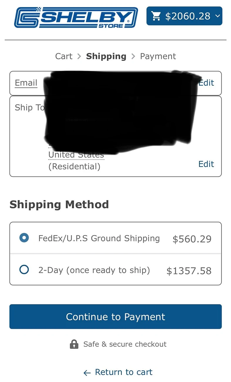

Shelby 4 piston rear kit. 1500.00 for kit, but they want like 560.00 for shipping, which is ridiculous. I can drive to Las Vegas for less.

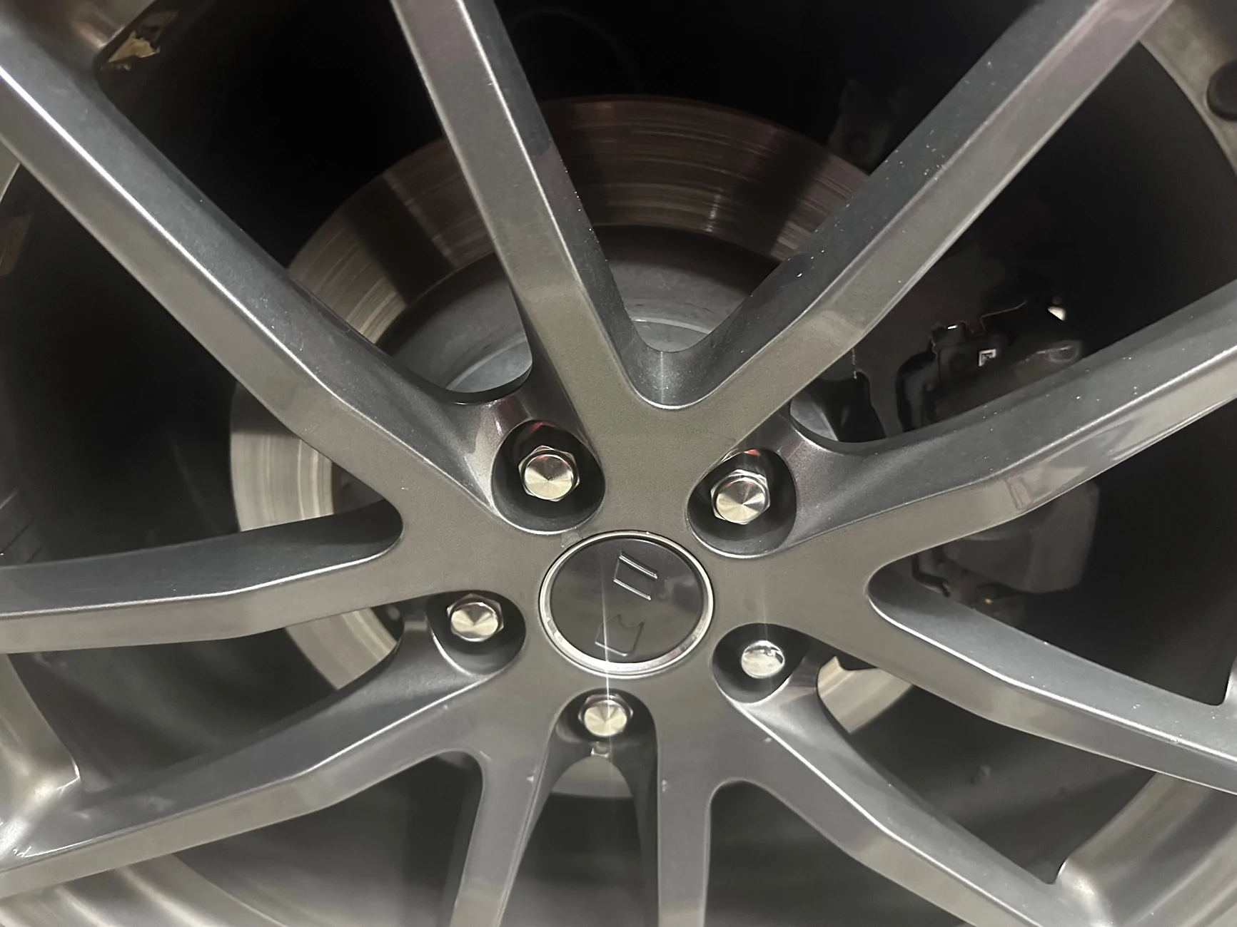

Brembo 6 piston front, stock GT rears. This is on a Roush stage 3.
I am looking for better performance and noticed my rear brakes have been getting a bit warm and have groves in the rotors. I do not power brake and the car always has traction control off. 13k miles. Regardless of what I go with, the rear brake system needs to be changed (whether it be stock with better pads or something that can handle a bit more abuse). Hard to tell with the picture, but dragging a screwdriver or fingernail on the rotor is very noticeable on both sides.
