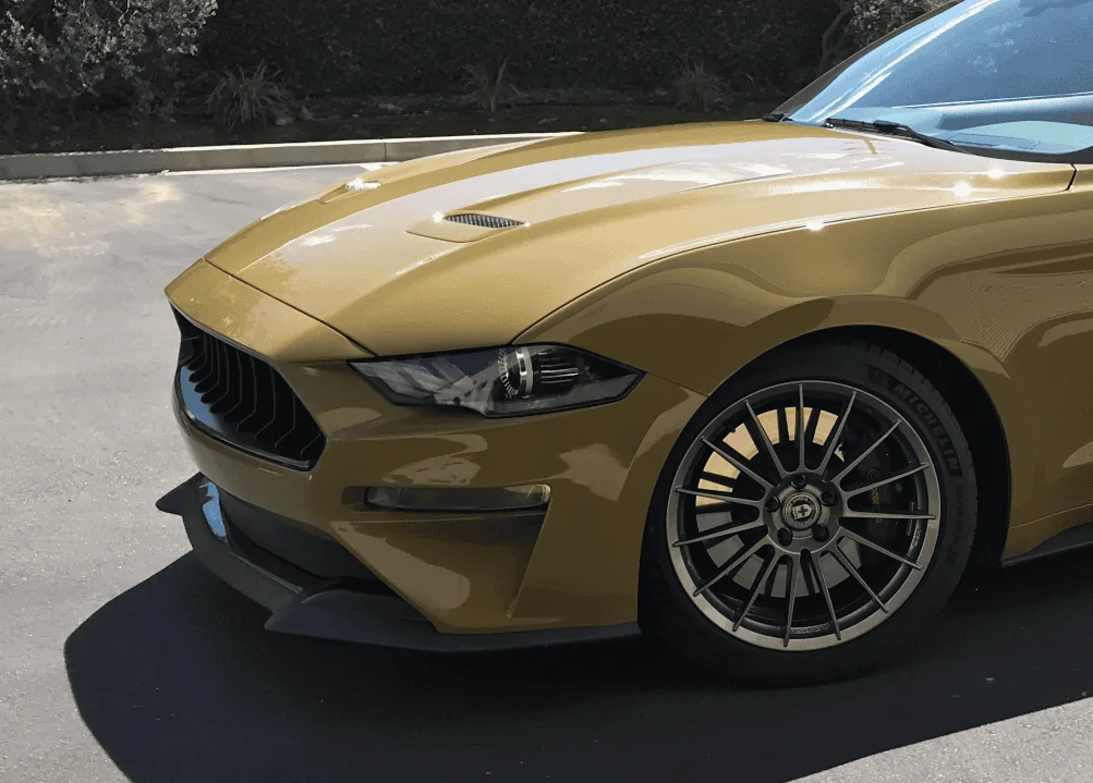

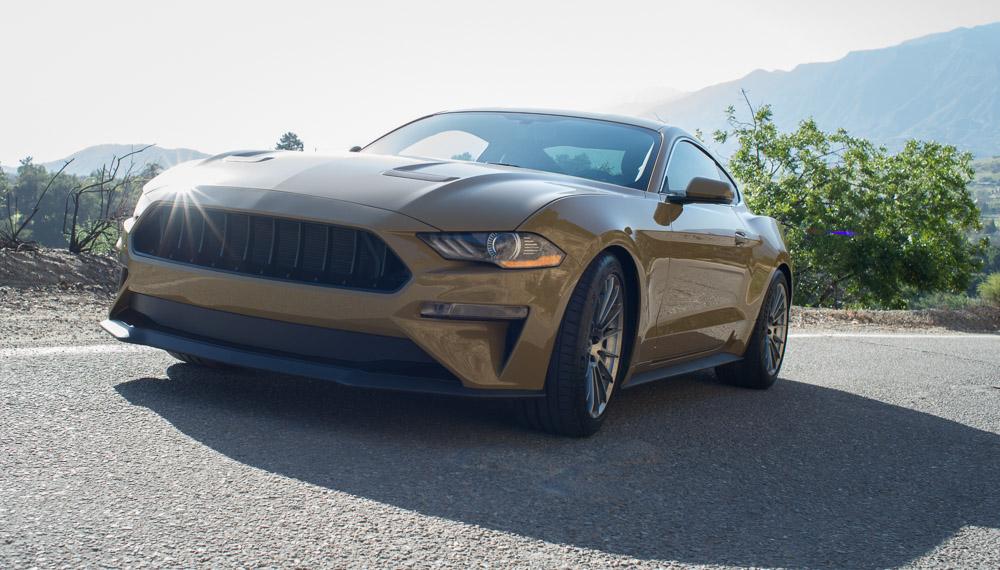

How about opening the headlight buckets and changing the amber signal to clear like the euro headlights?
Great job so far, very unique :thumbsup:
Cool idea -- can that be done? Have you seen others do that? Here's a quick photoshop of that --

You could go for an Anchor Room blackout kit if you wanted to go for that instead, maybe not as smooth looking as the shop above, but better than the orange.

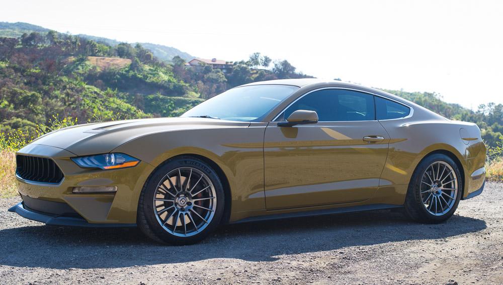

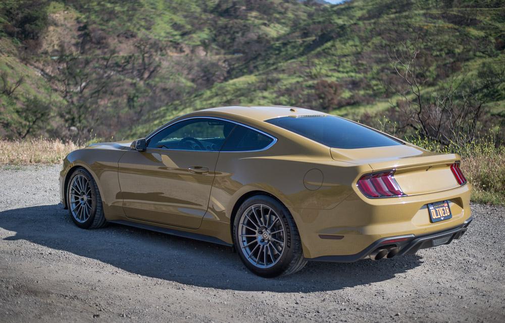

Ok I have to admit first pics I hated it but its growing on me...good job op

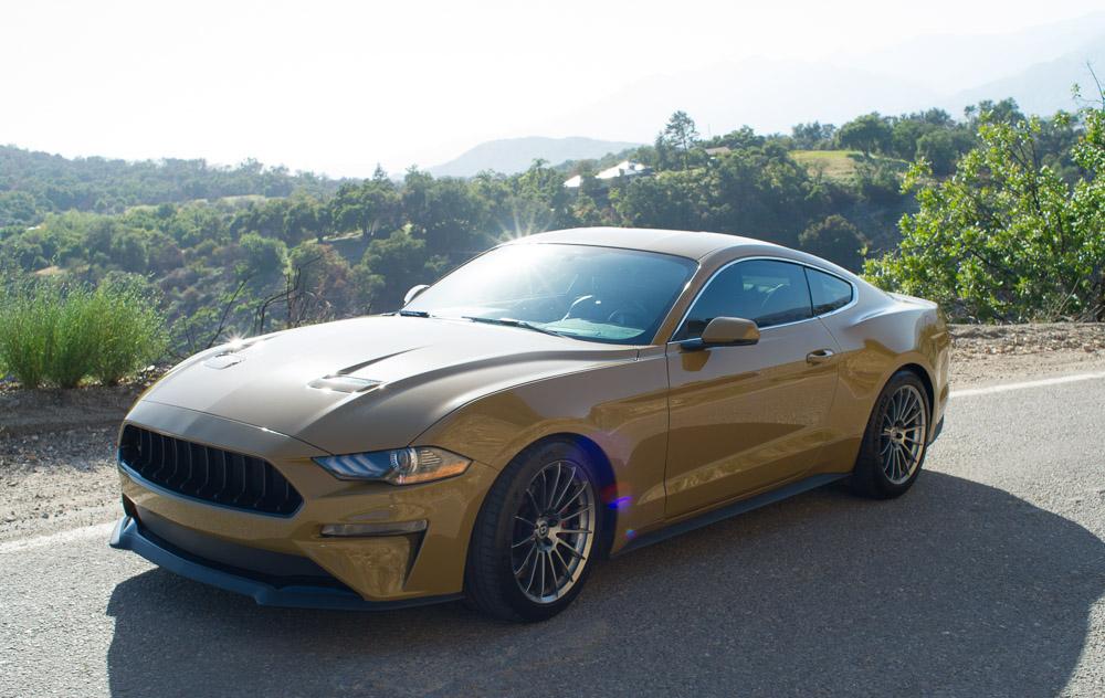

Have your thought of continuing the gloss black theme into the front splitter and side splitter as the texture grey plastic finish don't work too well, think it would look even better if those were gloss black too.
Otherwise at first I was like meh, now I am like, very nice! :)

That color looks good on a Jeep. Sorry to be negative but I can't stand that color on a car. Good thing my opinion means jack squat :) If it makes you happy, all that matters.
Yes and yes. I did this to my 17. you have to order (or cast your own) clear lens then either send off your headlights or install it yourself. Which is a massive PiTA with these headlights. Time consuming and a lot of work/money for something no one but you will really ever notice. Takes weeks with out using the car so this type of mod is best to do with other things being done. Like when you were painting the car.

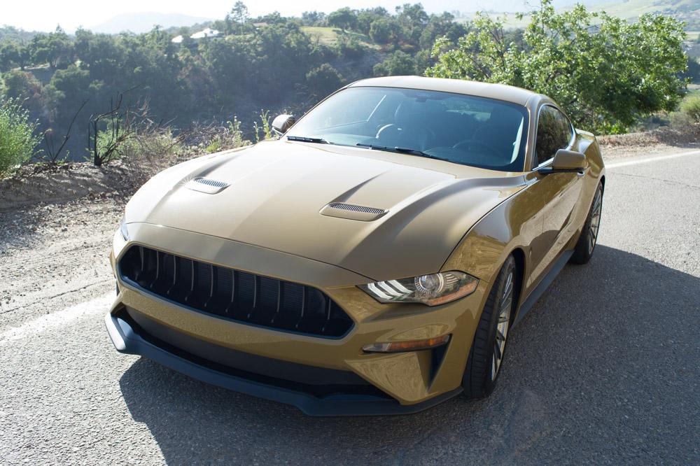

With the custom grille. lowered one inch.
I see you left the panel above the front splitter black. Could you do a front end shot. This car is now a one of only one !:cheers:
Yes, you can disassemble the clear lens from the bucket. For the 15-17 headlights it is a PITA but after 6 heat cycles per headlight in my oven I was able to separate the parts and eliminate the amber lens. Then you need to remove the left over adhesive and re-seal the parts. Full weekend project.
For 15-17 you need to pull the front bumper off to access the headlights.
