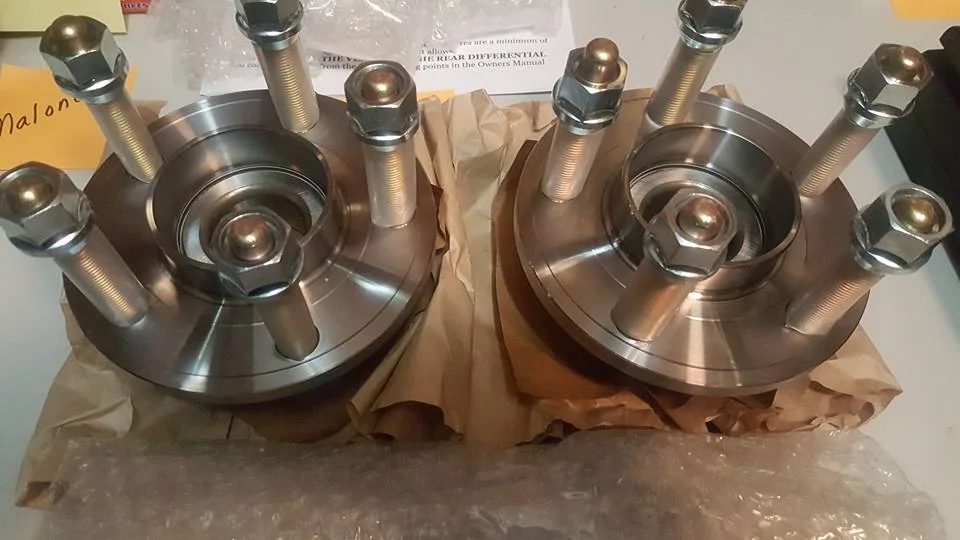

After doing some research, the vendor discovered that the 15-17 OEM hubs do not work on the 2018's. So in order to fit the particular size tire and wheel setup I'm after, I need to get the GT350 hubs. So those will be on order soon.

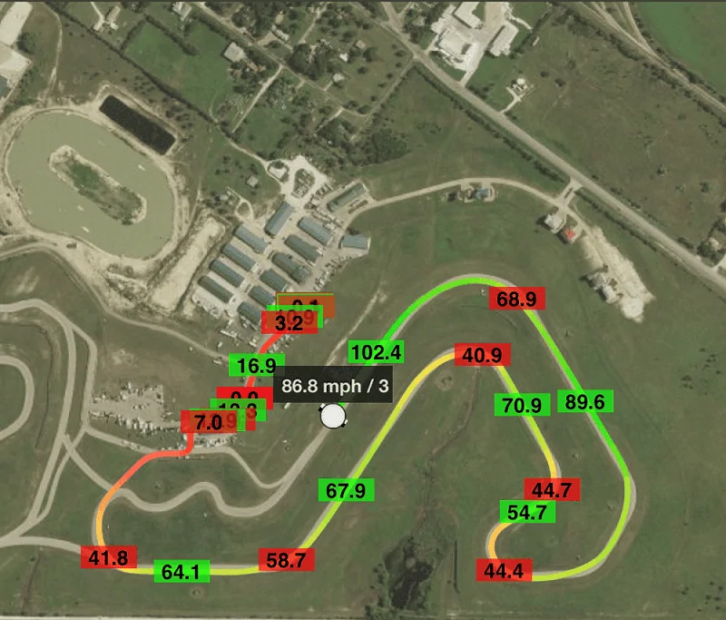

Throughout the sessions over the weekend, I played with the tire PSI after each one. So happened to find the sweet spot of 35 PSI hot, to maximize grip on 20min sessions. So it is without a shadow of a doubt to lower your PSI to about 26-28 while cold on Michelin 4's tires.

[ame]
Heres on of my sessions, learning the lines of the track.

Cdnspeed
Oct 14, 2017
121
63
Canada
2017 Base GT/PP
I'm curious about the updated knuckle on the 18' could you snap a pic of it when you get a chance?
