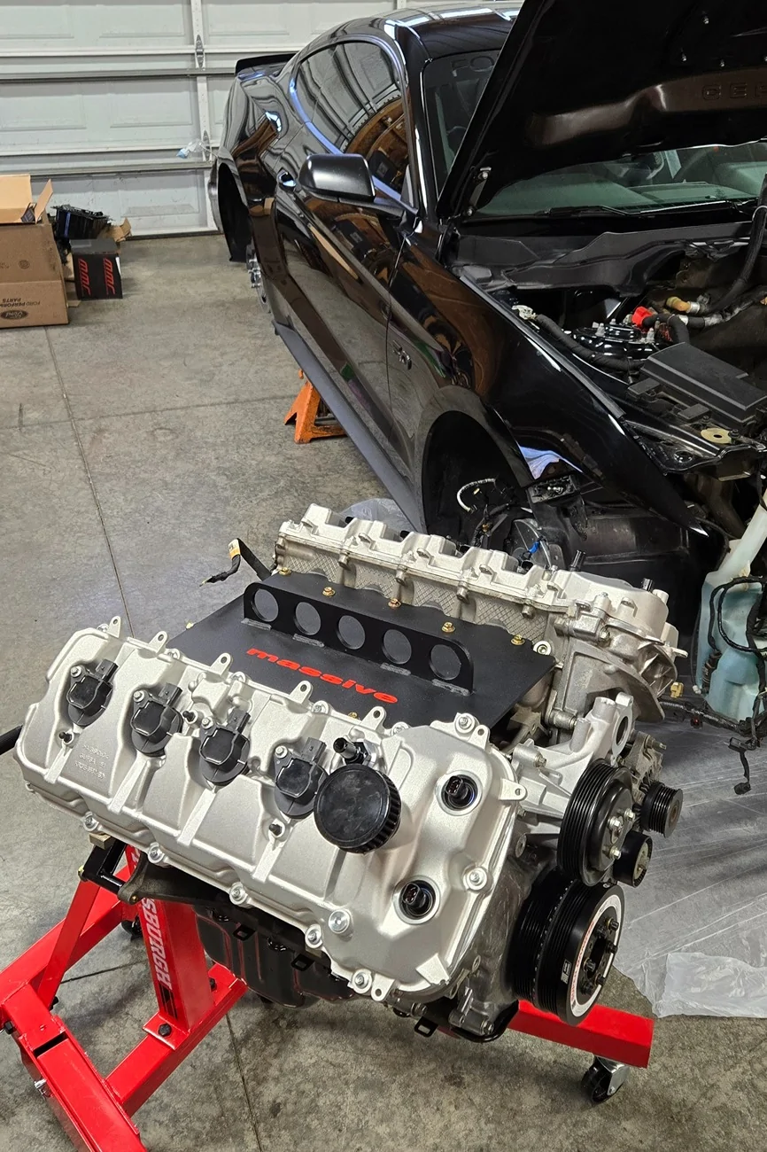

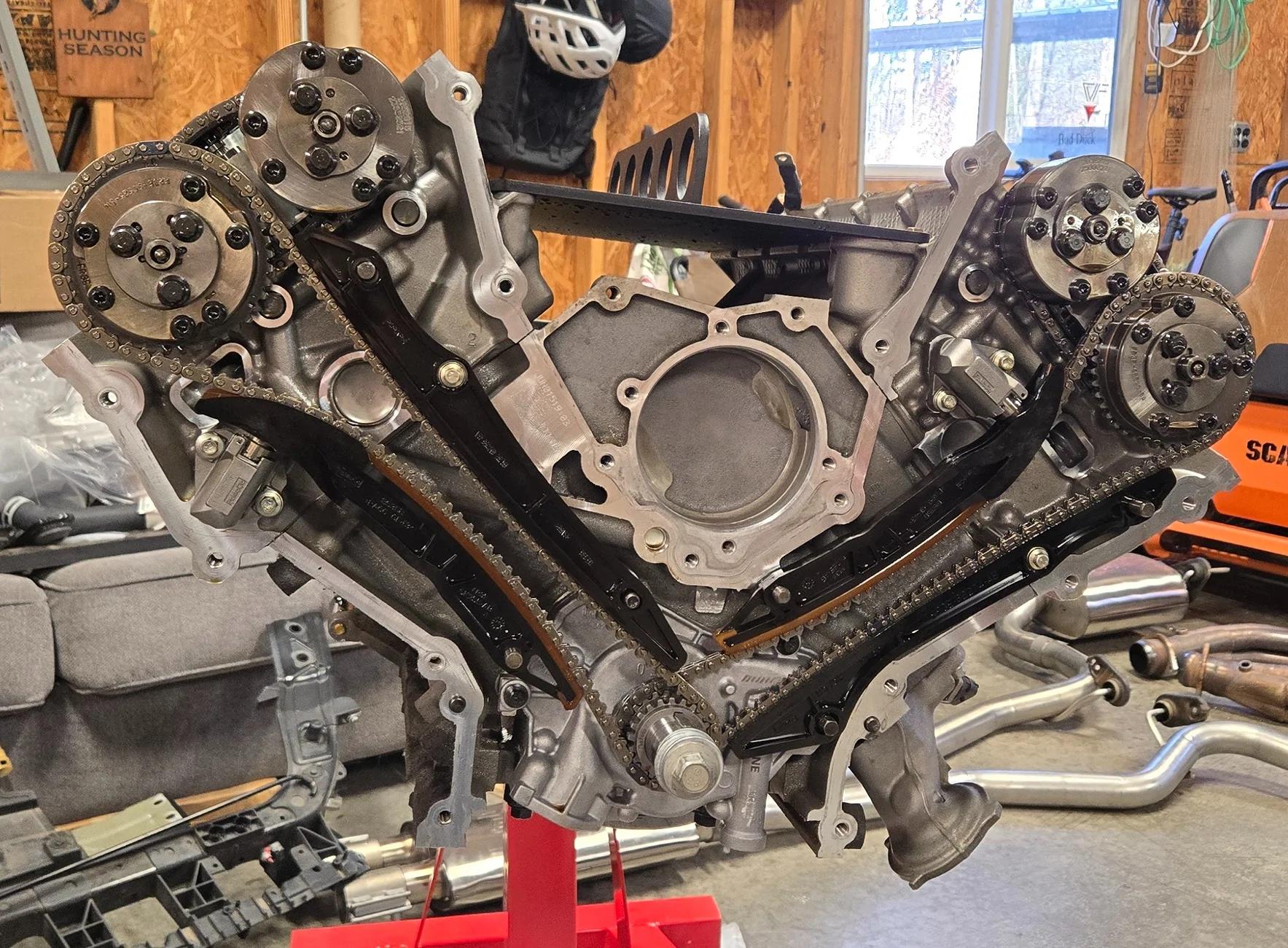

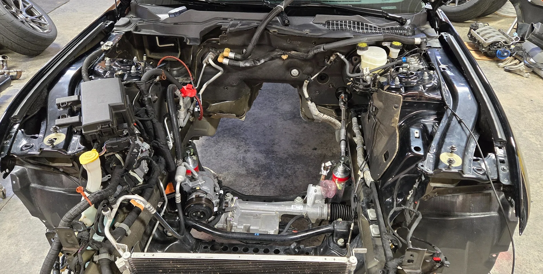

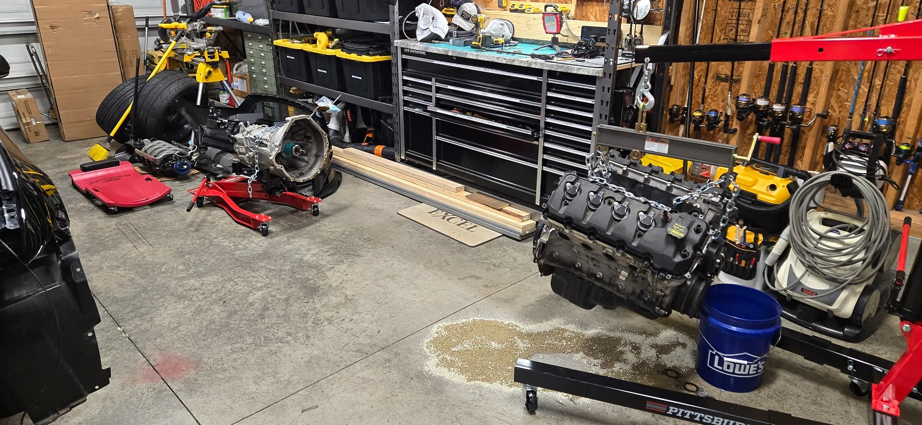

No, not building the motor right now.
Just fixing some oil leaks, cleaning things up, and some items to prepare for FI. Opg and CS being a few of them.
Was going to leave the engine in the car and do it all, but a leak at the oil pan gasket was the last straw. I have all winter, so out it came.
Pulled it out the top, with the trans.

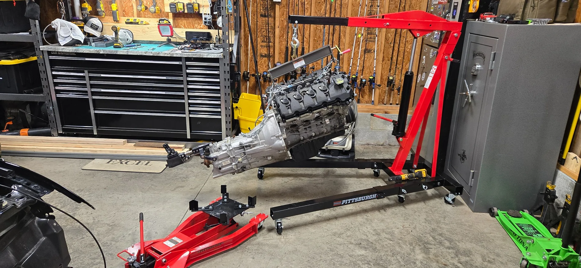

Attempted to pull it with the LTH's, and I could have done it with an extra hand... But it was way easier to zip off the motor mounts and headers once I had the engine half way out.
Afterwards, the combo came out pretty easily and I separated it and got it on the engine stand. I wish I could get the ac condenser to lay under the car or more out of the way, but otherwise with the whole front end off the car there was plenty of room to work.

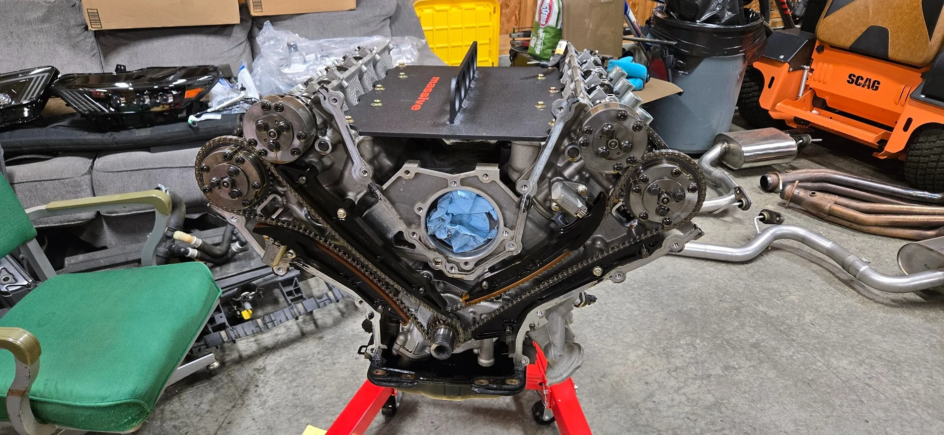

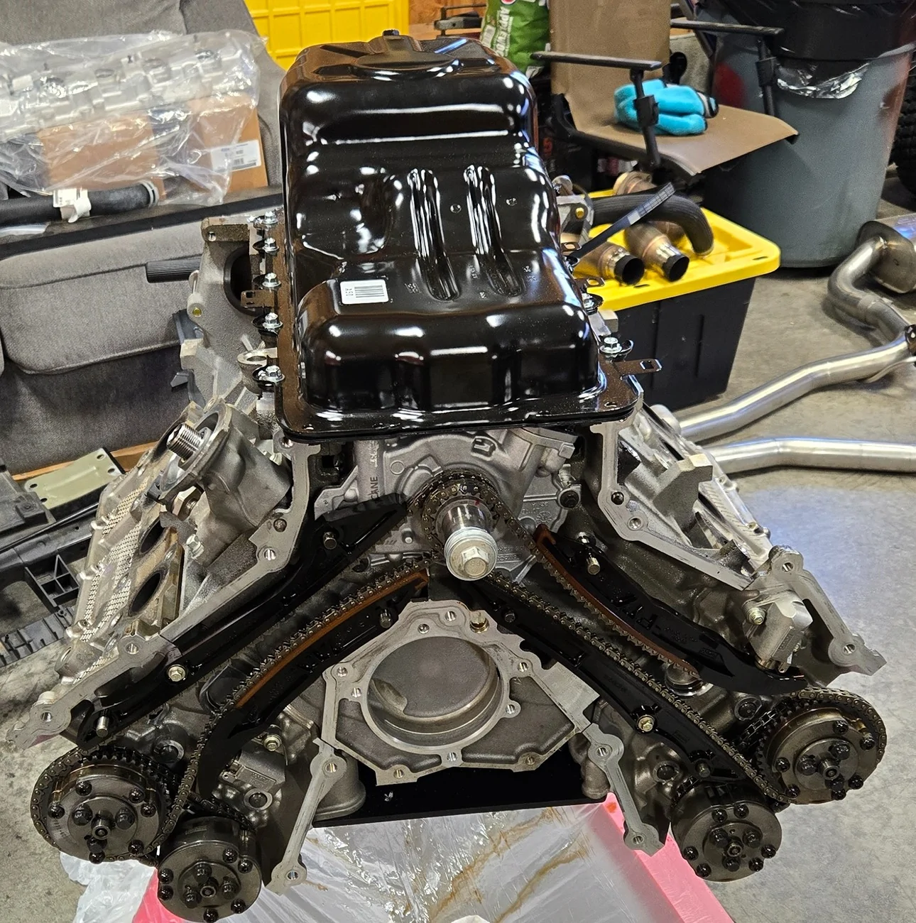

Well, it was a productive Saturday here in my garage.

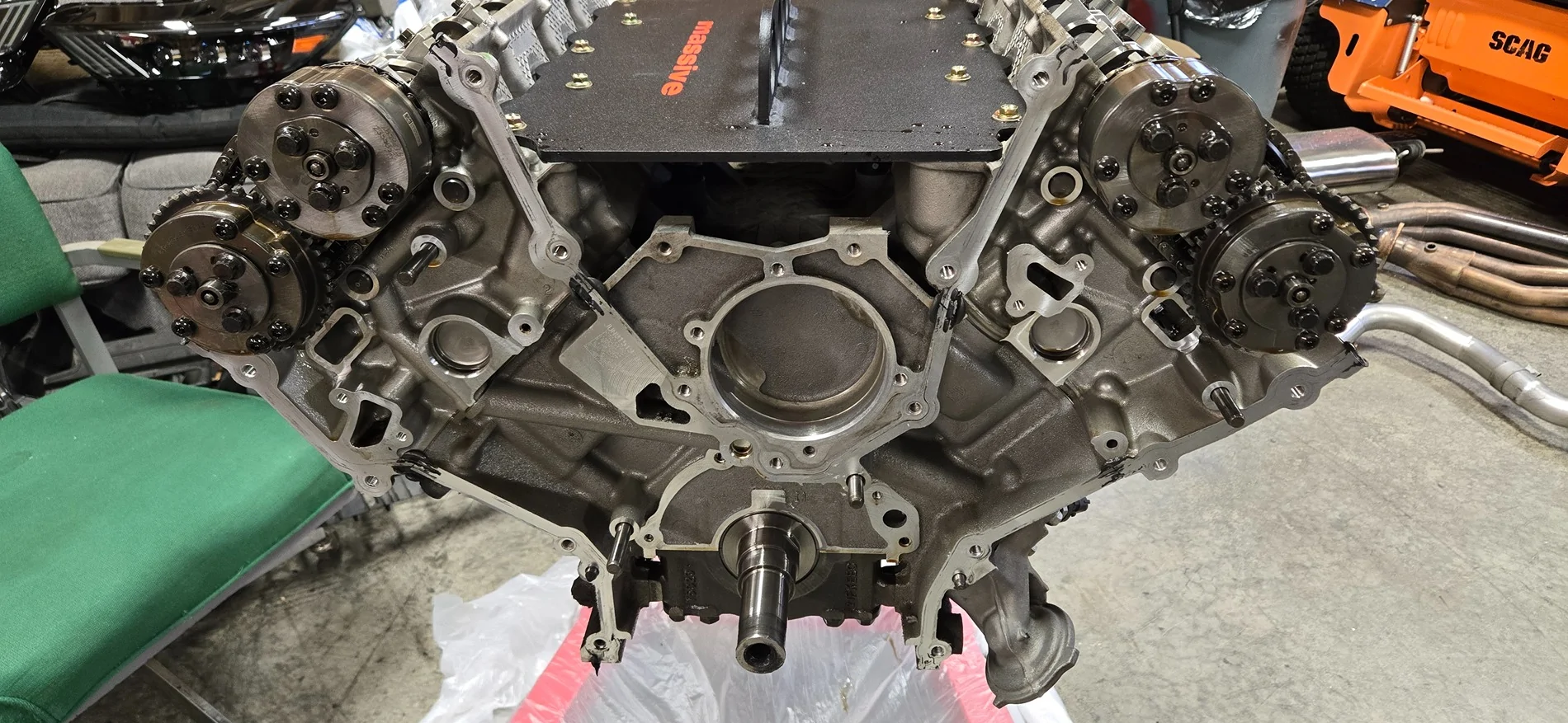

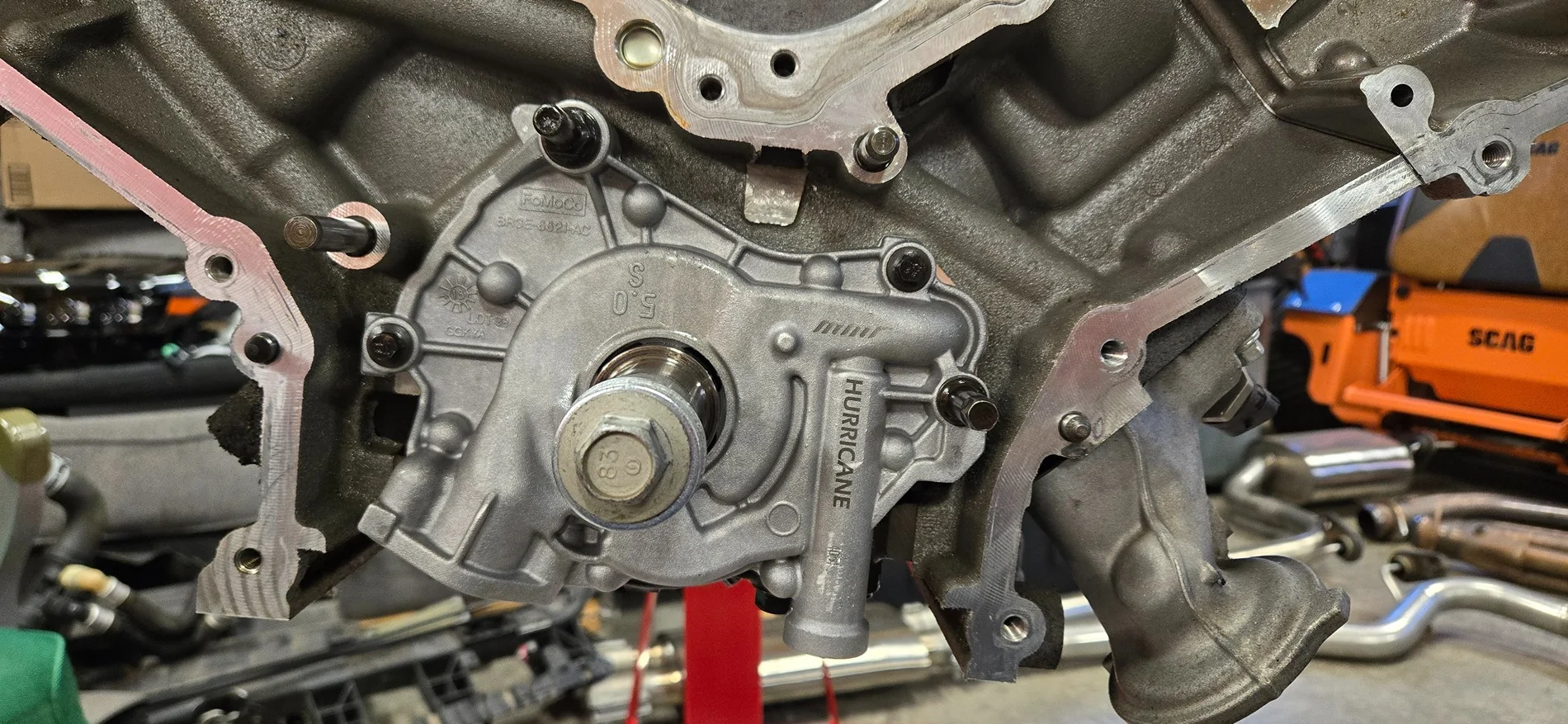

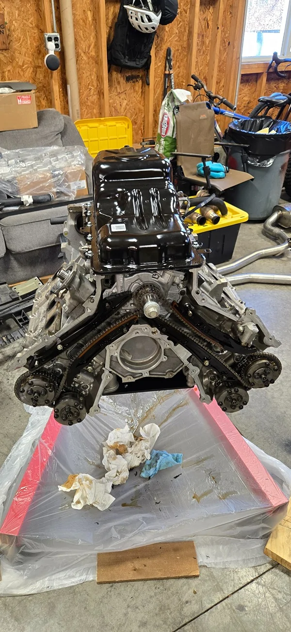

Started out the morning tearing down the timing on the front of the engine, and removed the factory oil pump.
Without going into details, I checked the Hurricane pump out very good.
Clearances were good, and I lubed everything up.
Still can't believe they said it was ok to install it dry and start the car, but I digress.
Got the new pump installed, and spun over the crank a bit to insure everything was good and no tight spots or issues. All is well.

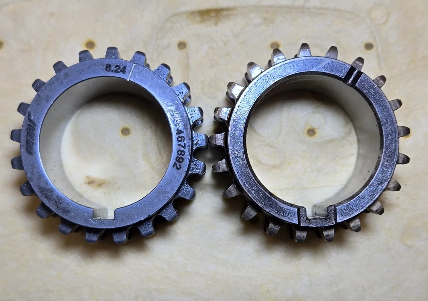

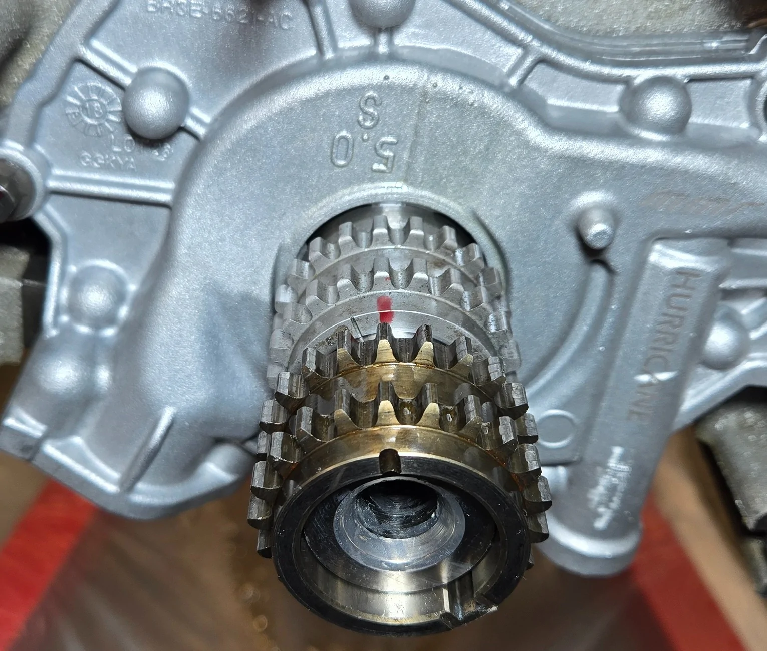

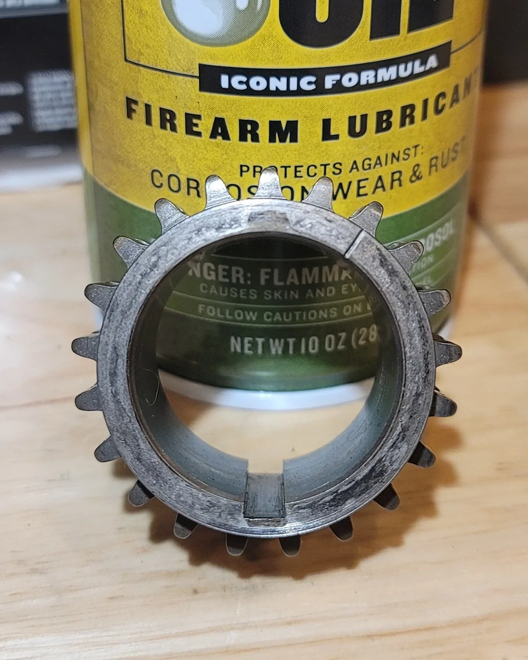

Moved on to the MMR Crank Sprocket.
I do not know why, but as I was about to install it, something told me to compare it to the stock sprocket. Glad I did...
The Timing Mark on the new sprocket is one tooth off.
I honestly couldn't believe it.
Another pic, with the new sprocket installed, marked correctly (red sharpie), and the stock sprocket in front of it:
At this point, I was a little irritated. As a prototype engineer / machinist, these kinds of things are honestly unacceptable. But it is what it is.
I used my red sharpie mark, and began installing the chains / tensioners.

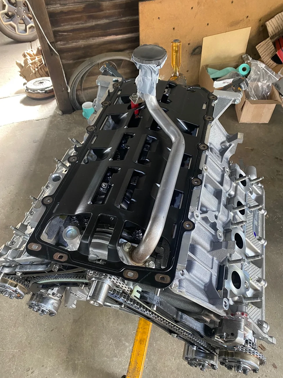

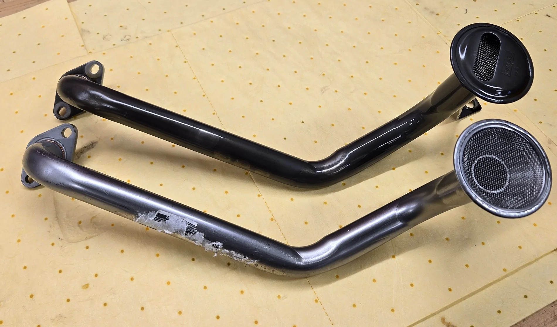

After that, I was ready to install the new MMR 2011-2017 5.0 Coyote High Flow Oil Pump Pick up tube 455550.
I unboxed it, and found that the factory Ford sticker was half mangled and hanging off of the side. So I finished cleaning it off, before installing it.

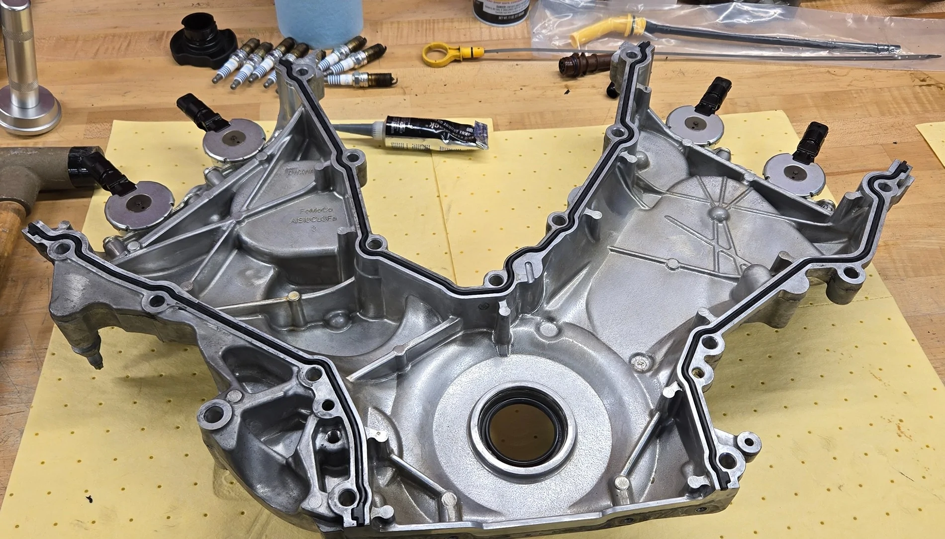

After it was installed, I finished cleaning the mating faces for the front cover and the oil pan.
Then, the new Ford oil pan & gasket M-6675-M50A1 went on along with a little silicone.

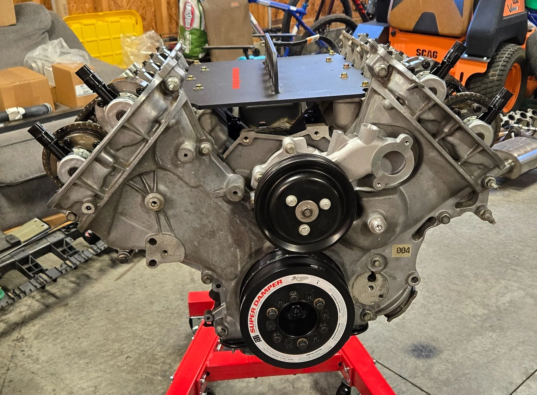

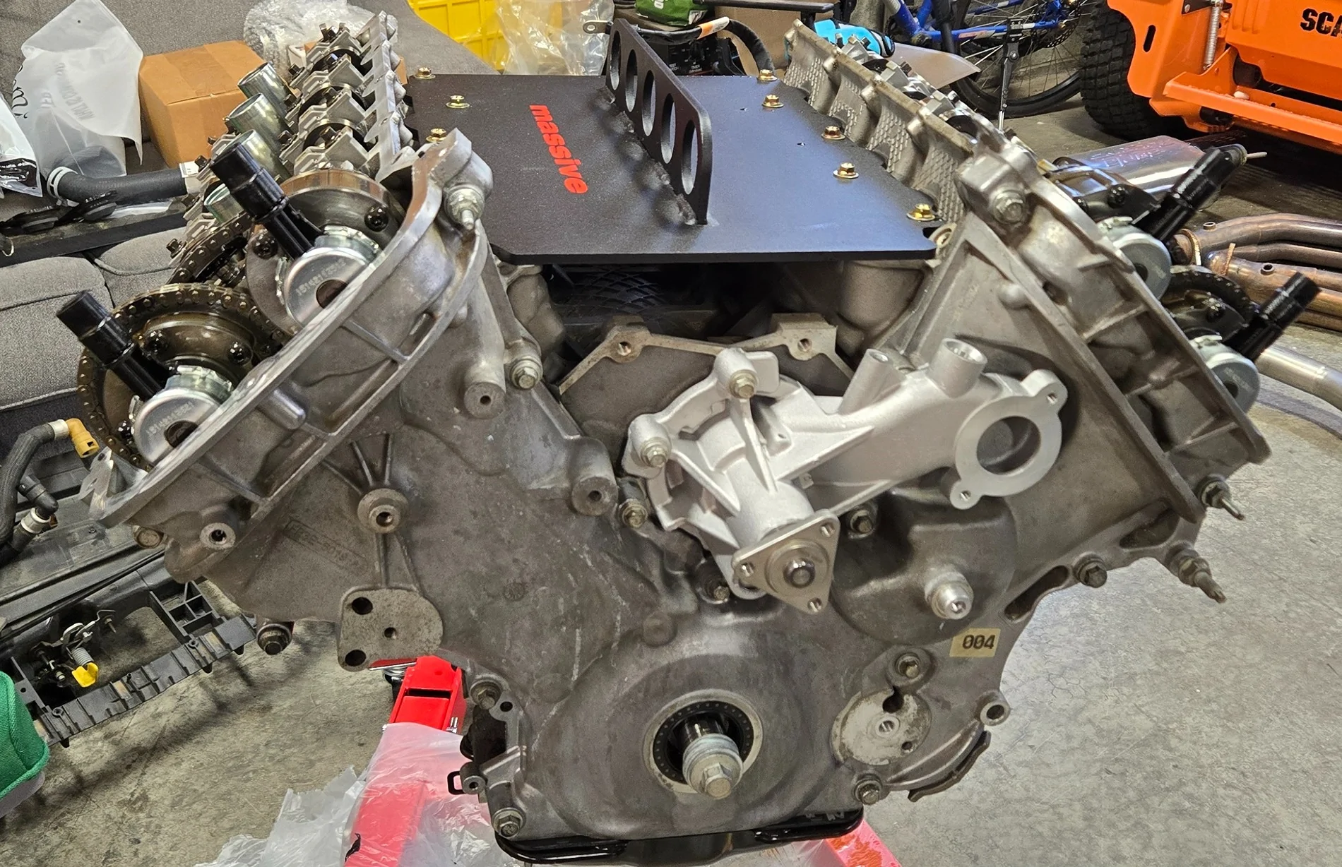

Cleaned up the Front Cover, installed new gaskets and a new front main seal
Then the new US Motor Works water pump (metal impeller) went on, along with its pulley.
Also the ATI Super Damper. I picked up the installation tool when I bought this (from @beefcake)
and that made it a very easy install.
That is it for today.
The new FP aluminum valve covers are next, along with the engine accessories.

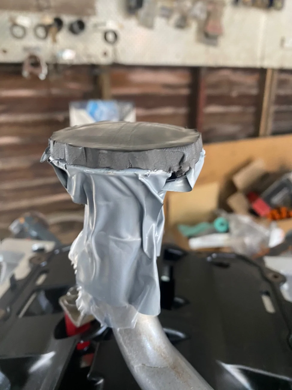

just something to note. I run the same pick up on my sleeved gen2. I had to tweak the leg on the pick up to get it to sit properly with in the factory ford spec clearance bottom of the pan.
taped it up , bit of modelling clay , then plastic over it.... simple to get the clearance right.

@eisenhauer01 man that really stinks about the MMR sprocket. Clearly a quality issue by thier vendor that they missed. Good thing you caught it. I assume you simply put a new mark on it. Here is a pic of an older mmr cs I had laying around.

@eisenhauer01 Good thing you caught it. I assume you simply put a new mark on it.
Yeah I just used the red sharpie mark. I don't ever plan to sell this car, so as long as I have it and I'm alive, if it ever needs to come back apart I'll know what the deal is. I really wanted to make some progress today, otherwise I would have taken it into work and milled a new mark on it in the correct place.

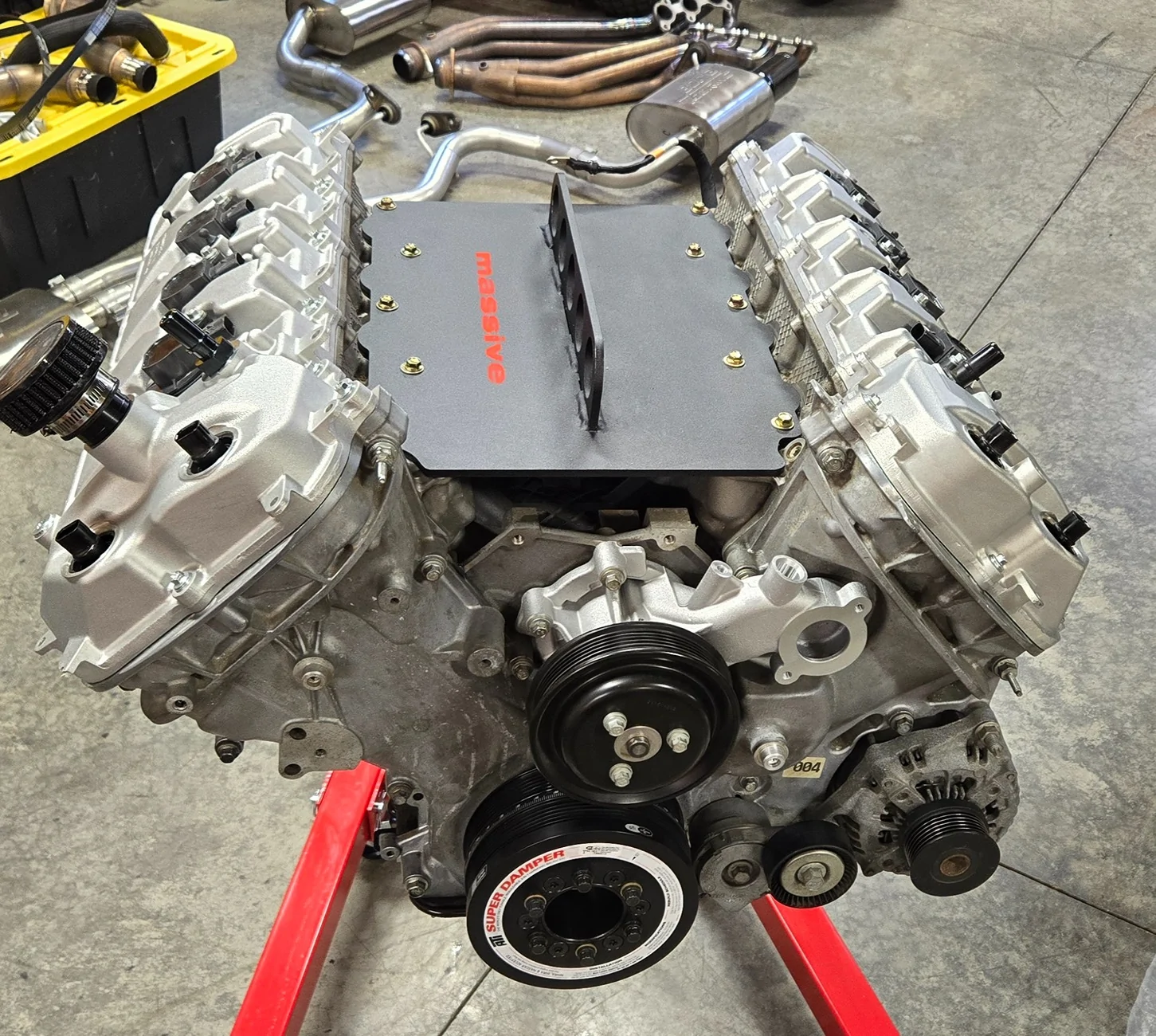

Another good day.

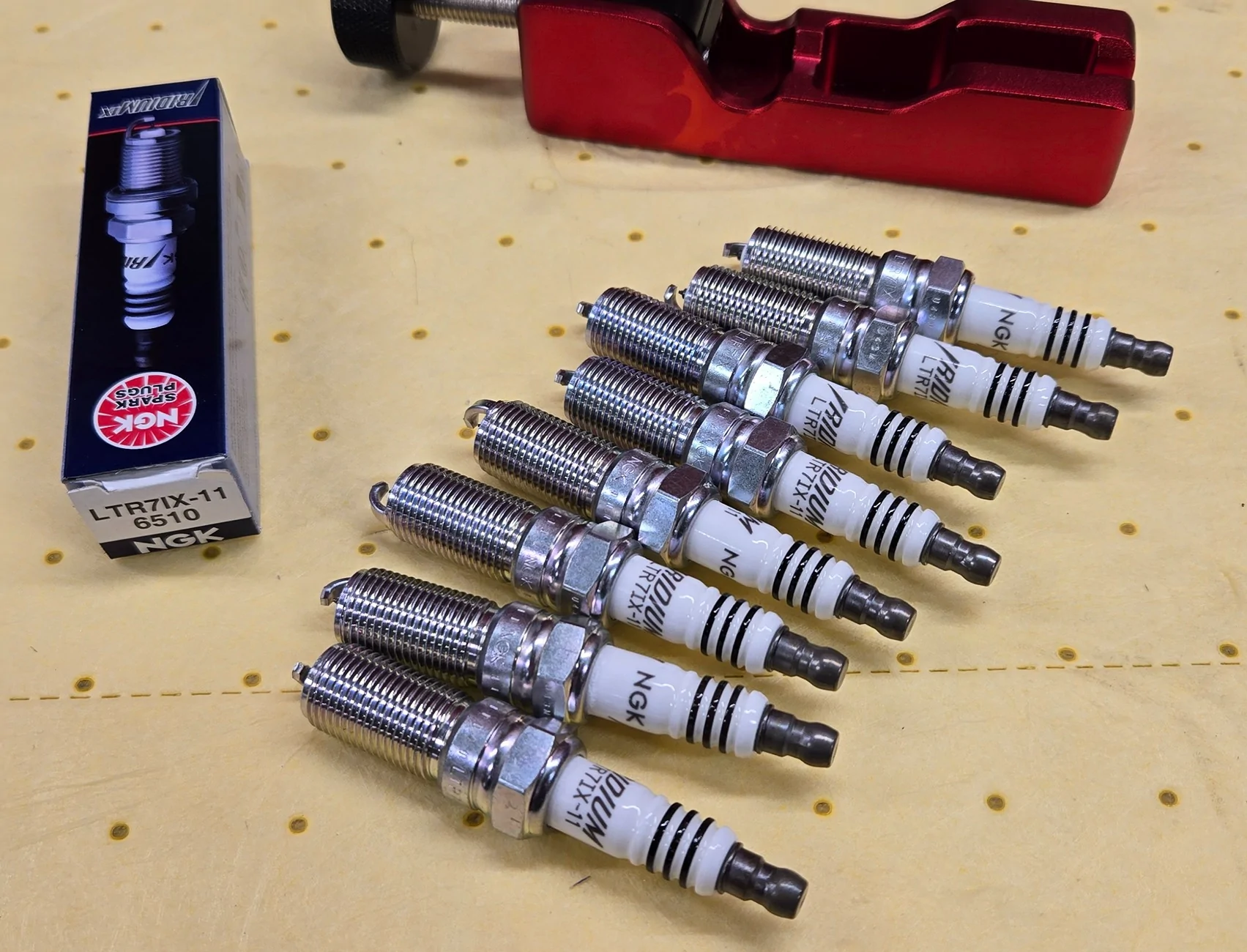

I gapped the new plugs, and installed them first.
Then I installed the new GT500 Aluminum Cam Covers, the alternator, coil packs, and idler & tensioner pulleys.
Then I worked on cleaning up the engine bay. It was a mess from years of seeping oil leaks.
I forgot to take a "before" picture, but it cleaned up really nice. The power steering and AC were black before I started..
I bought a case of some foaming engine degreaser that is made by WD-40, and it is really awesome! After letting it soak for a bit, I agitated all of the areas with a brush, then I used a small pump sprayer with water to wash everything off. It came out good. Big improvement.

It was perfectly fine to install the pump as is, but you would want to pre-prime the engine with engine oil before 1st startup. Still a good idea now as it can expose any leaks you have.

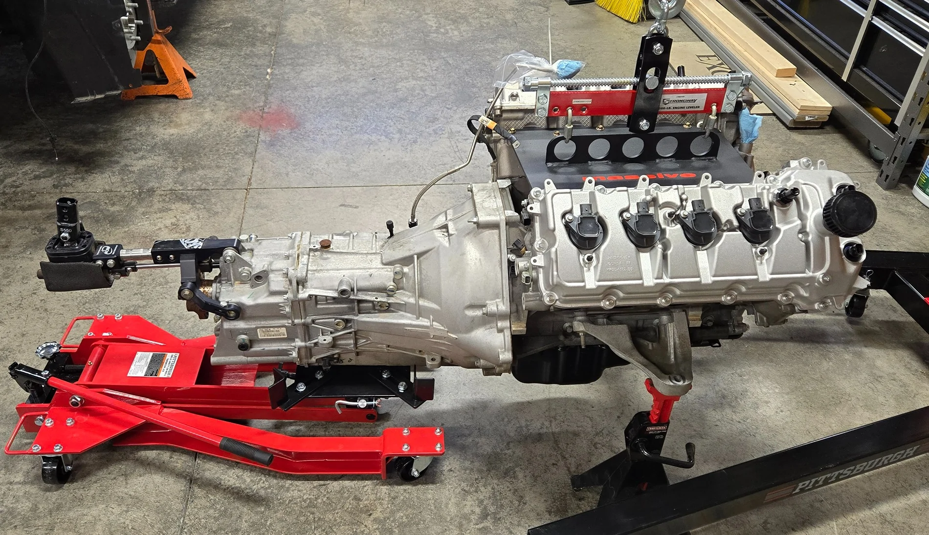

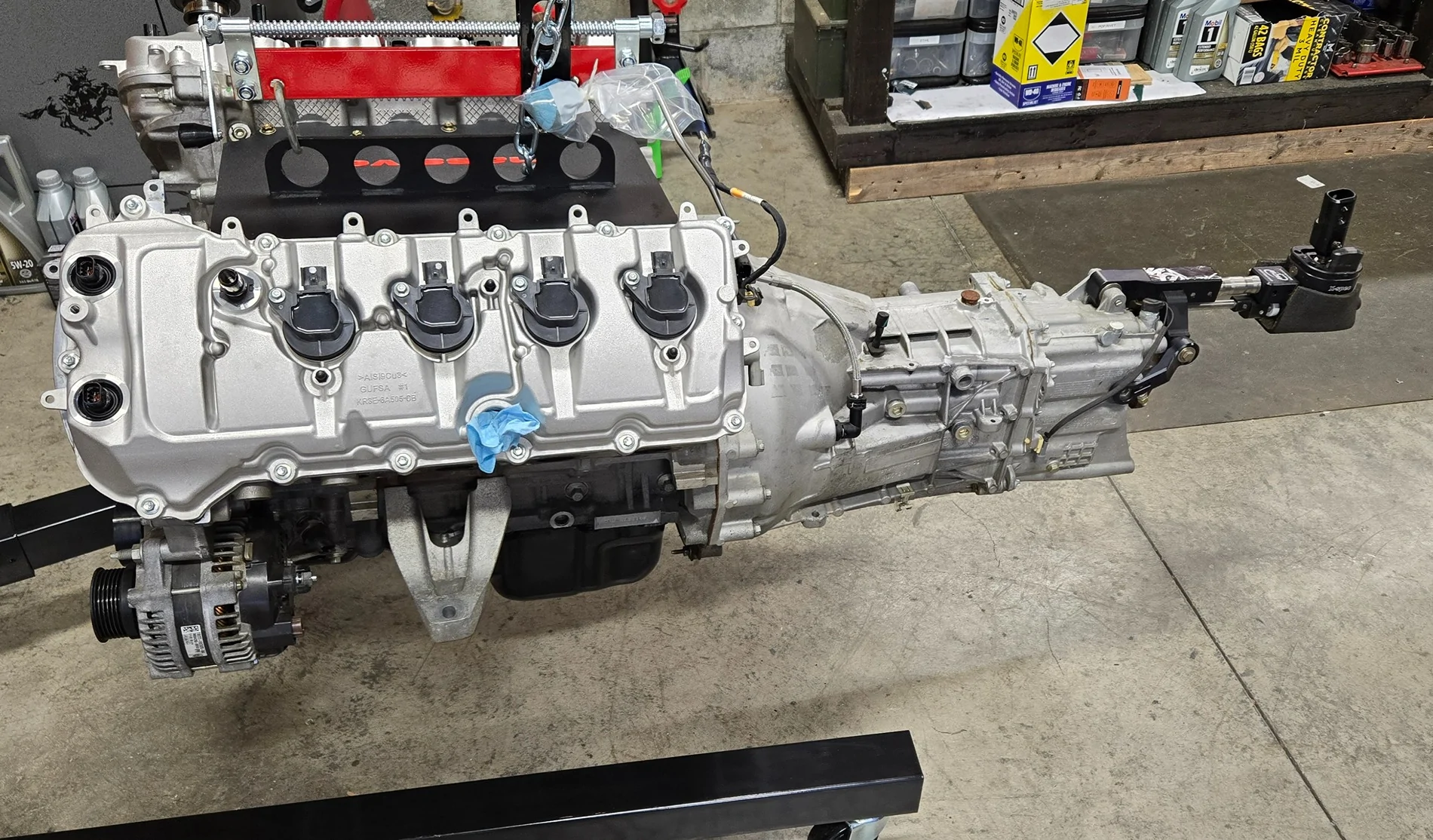

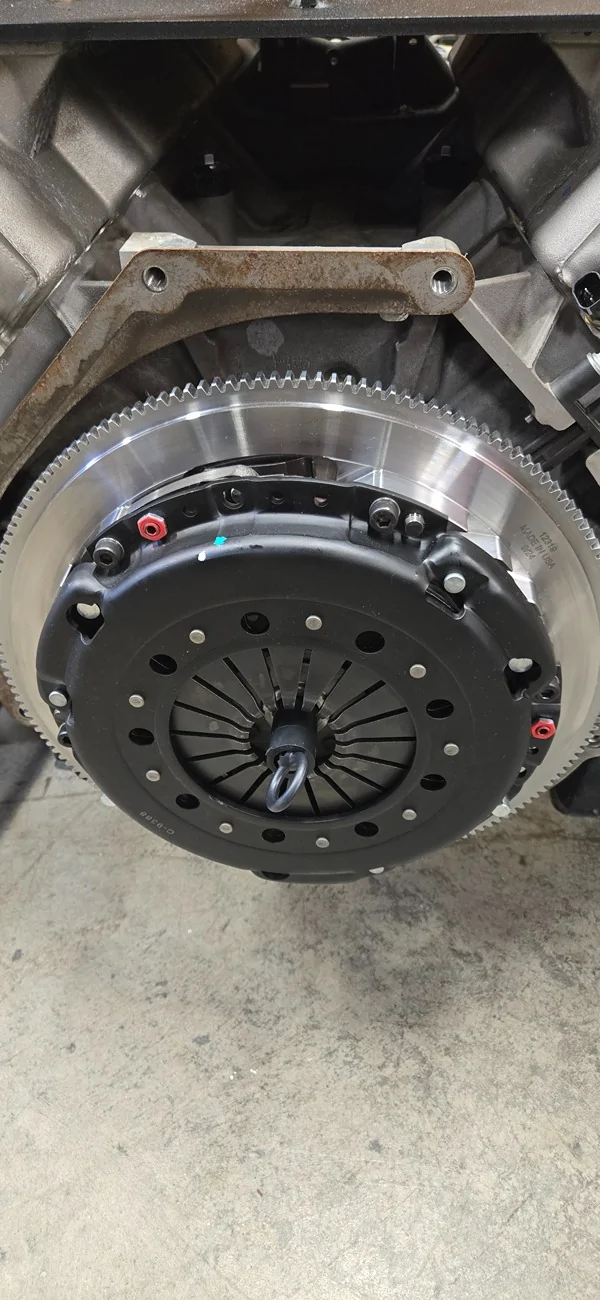

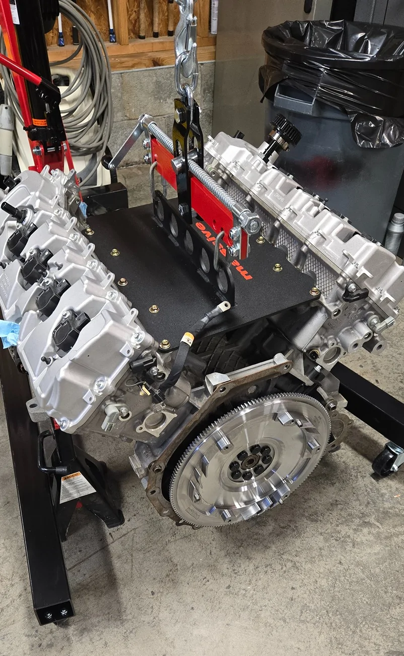

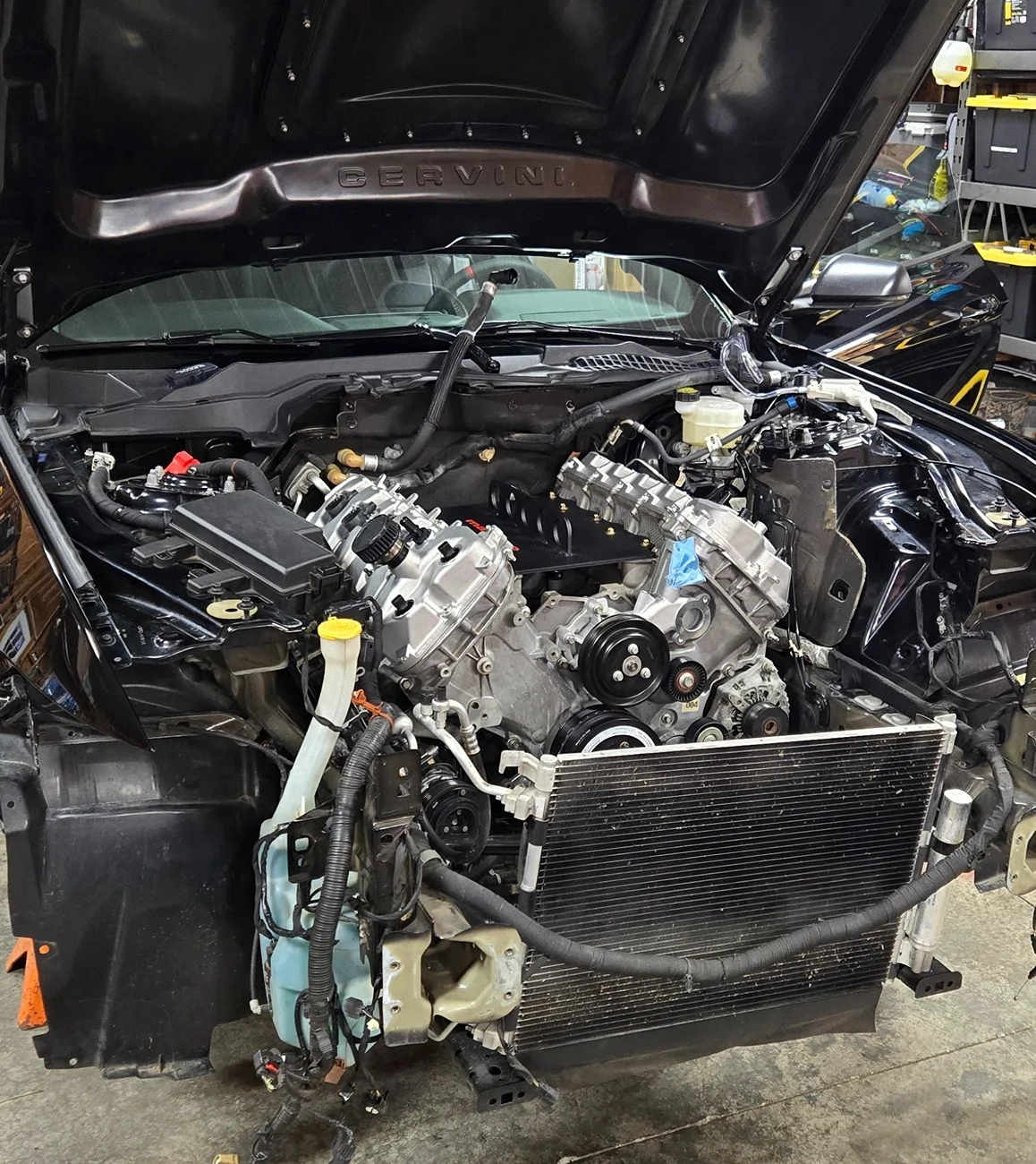

Got the engine off of the stand this afternoon, and installed the flywheel and clutch
Then got the trans mated up
The neighbor popped over and helped me fish it into the hole
Now it is sitting on its new Steeda motor mounts, waiting on the new Ultimate Headers to arrive so I can button up a few things before installing the Paxton.
It feels good to have the engine back in the car.
