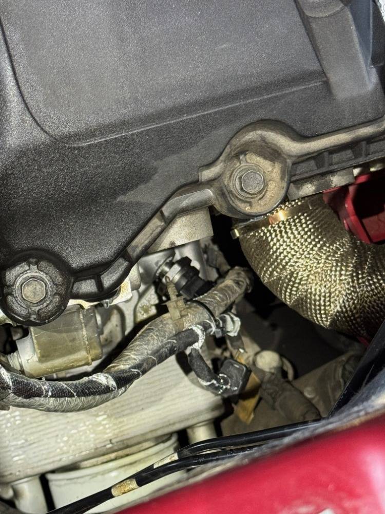

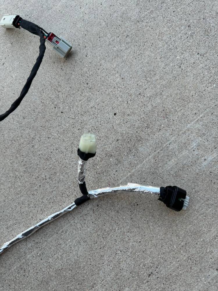

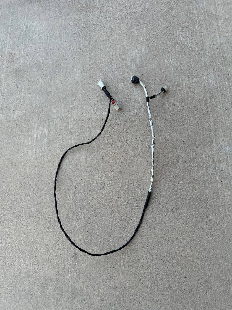

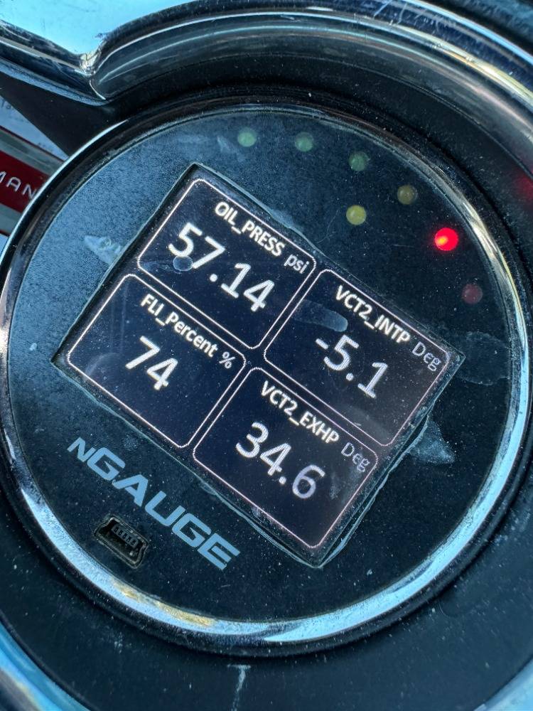

Test Harness Photos and NGauge Display Photo:

I would 1000% buy this and im sure many others would too. Out of curiosity, why does the center digital dash not read out the pressure then if all the data is provided through the ECU and the Ngauge is picking it up?
Digital dash should show the oil pressure once the kit and tune are installed (still need to verify). The non-digital dash does not have the programming to output the oil pressure psi only low/normal.
In that case I absolutely would want this so I don't have to jack around with "inferred" data.
When donyou think you'll start making them? Also I have a VMP supercharger and oil pressure is kinda important
There might be a way to make it work on the analog dash in forscan
