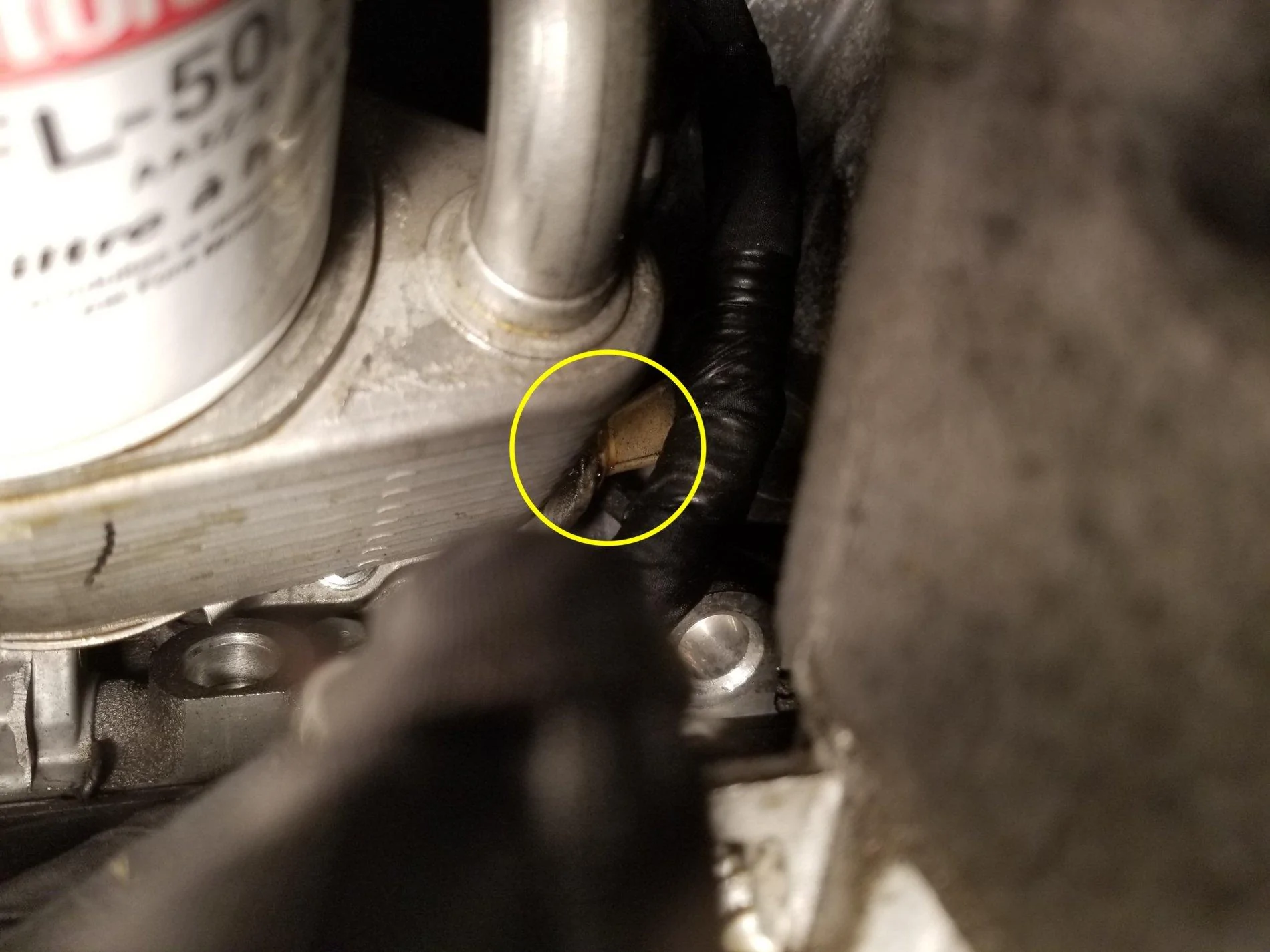

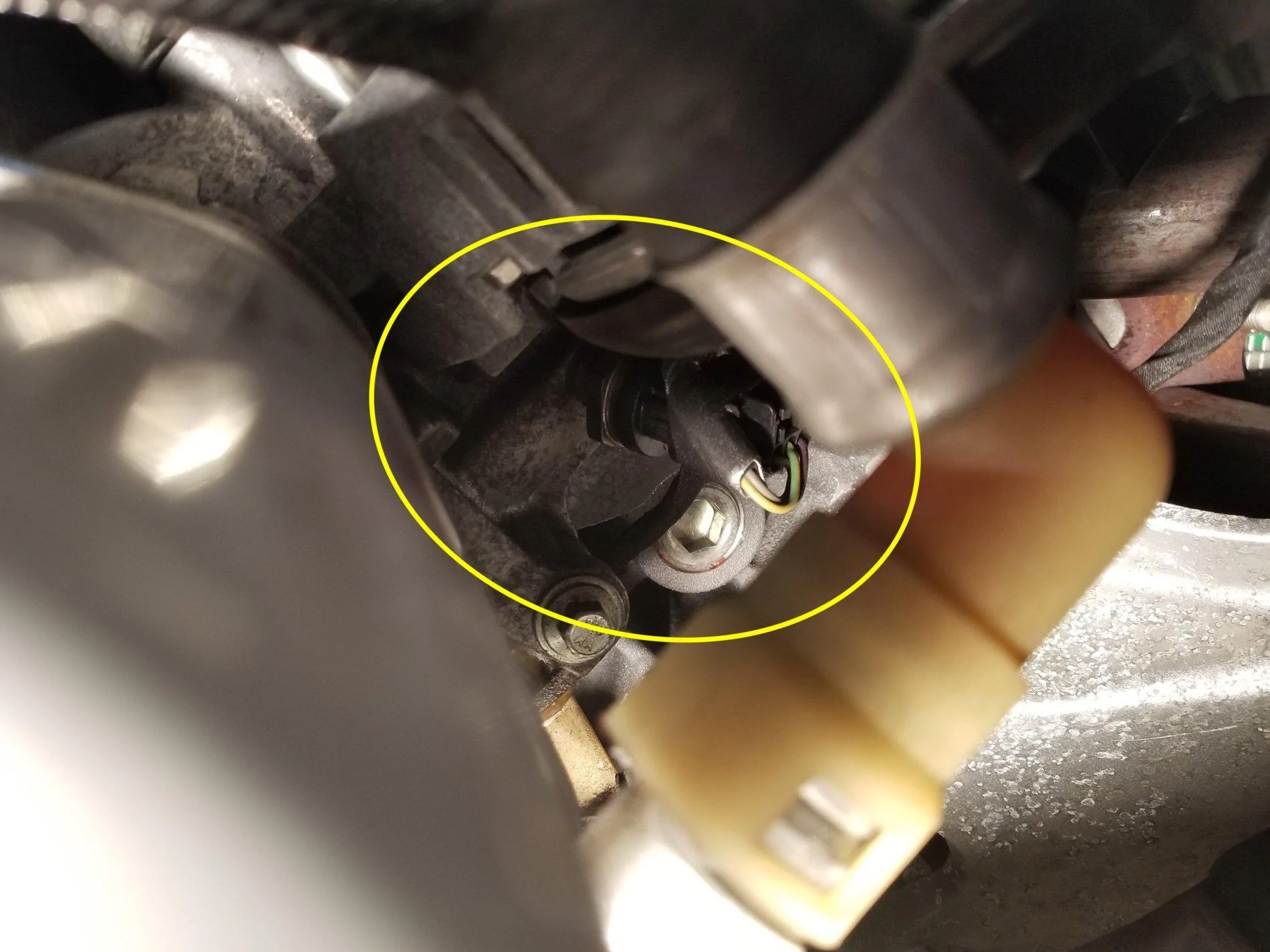

Finally getting under there. Removed the driver side wheel. It's really tough to see the source. Definitely not the filter, someplace above it, but cant get an angle to really see. Is this the oil pressure switch? If so, thats not the source of my leak.
Noticing plenty of oil at these two spots.

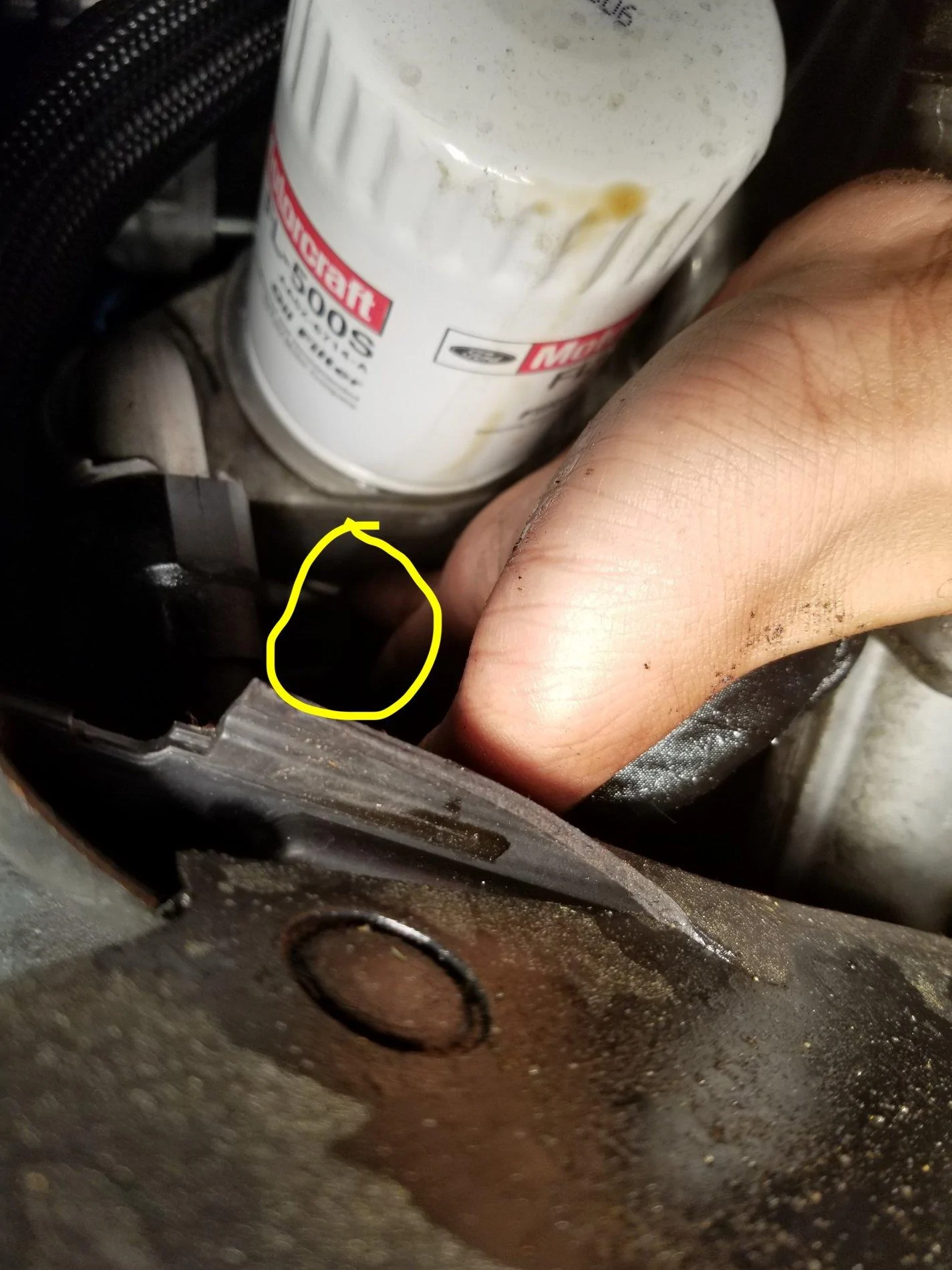

Hey OP, did you figure out what was causing the leak? I have a nearly identical leak coming from my car

Yes - It was the oil pressure switch, when the car is sitting you really cant tell. Thanks to the links provided by Grimace i eventually came across a post about a way to see for sure.
Get your eyes on the oil pressure switch with light if you can see and start the car, you will then see the oil oozing from around the switch, it runs over and around the oil filter to make it look like its coming from the filter area :)
The fix is easy, just remove and reinstall with the proper thread sealant or thread tape. It could be a PIA to get to. I had to configure sockets and extensions to reach from the bottom because procharger prevented me from reaching from the top. I did it a year ago, and no issues

Wow this is definitely gonna help me narrow down the leak, thanks a bunch dude! I was looking for possible causes but to no avail. It's a deceiving leak because it looks like it's coming out of the filter area but when you look closer it's something further up
