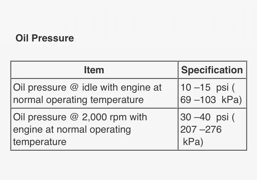

For an S550 GT 5.0 Coyote, this is right from Ford:
That PSI info is based upon the standard recommended oil for the 5.0 Coyote.
Also to note:
Oil PSI is always dependent upon operating temps, oil viscosity and RPM.
