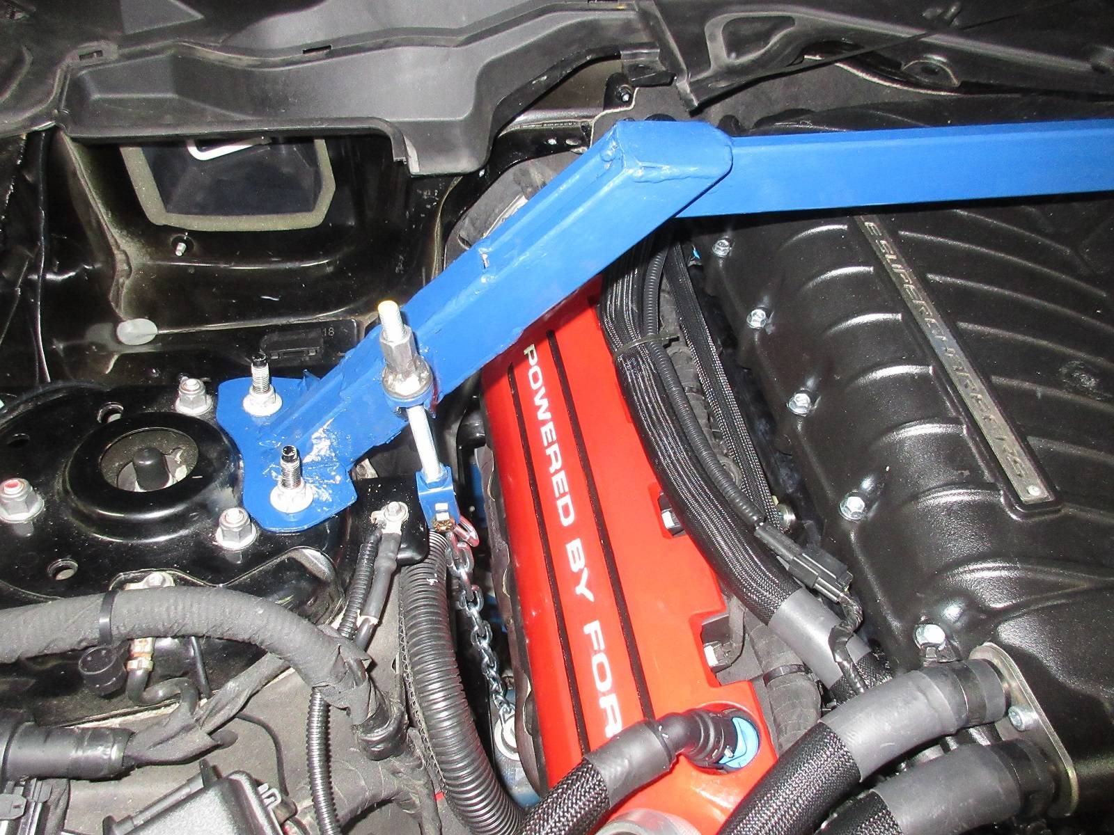

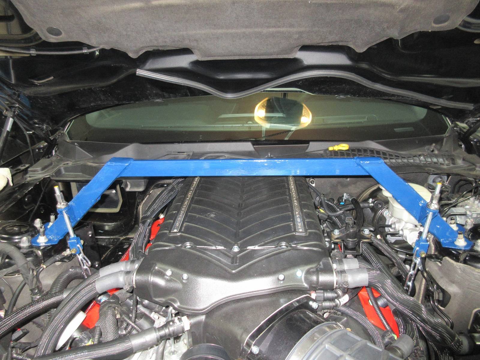

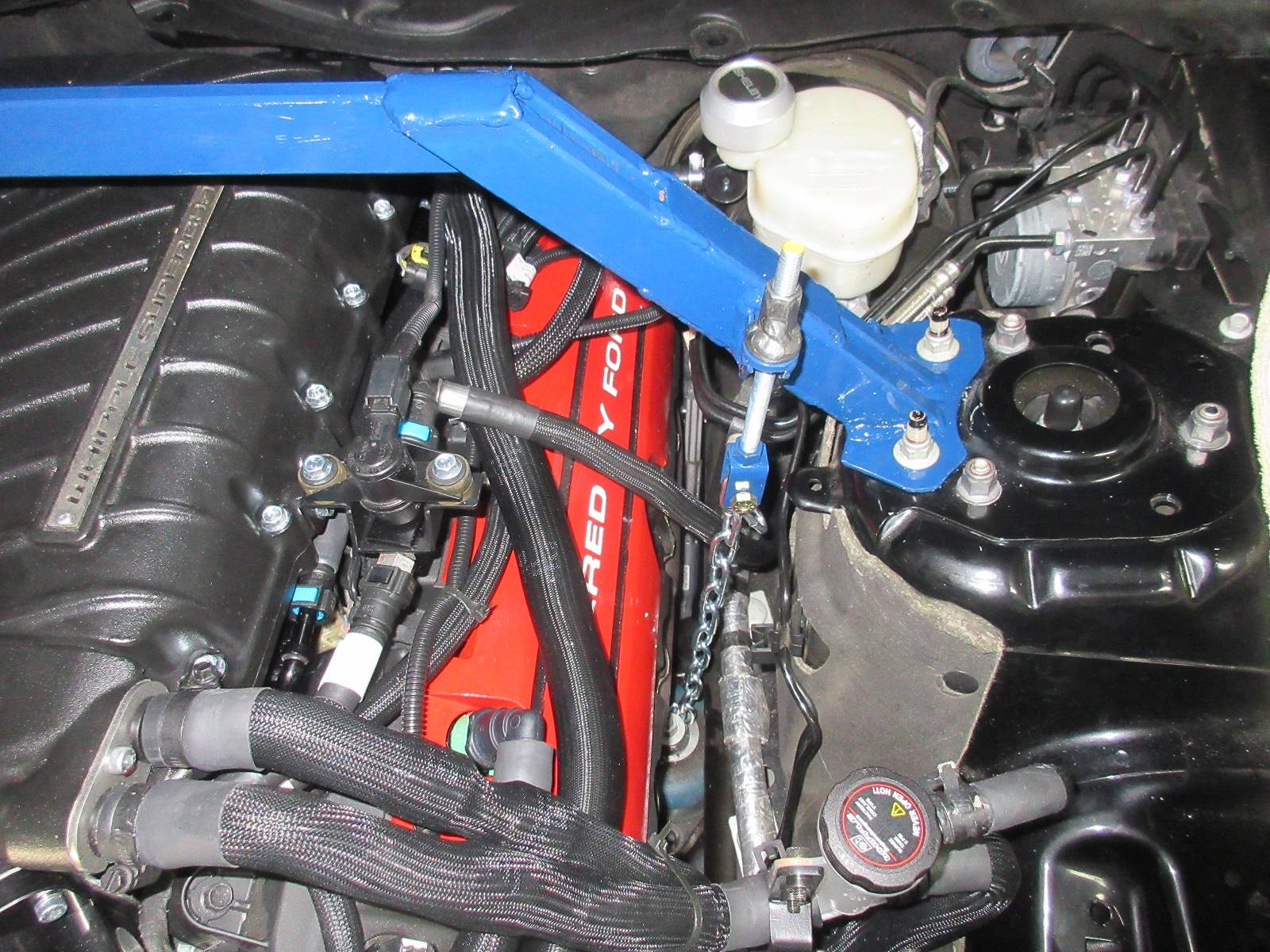

Yes,
I actually did this on my GT350, after I replaced my OEM OPG's as well.
After studying the situation here is what I had to do.
I made a home-made engine lift/support tool, and raised the engine as far as safely feasible. (I believe it was about 2").
I then loosened the all front subframe bolts, and dropped the front subframe as far as the loosened bolts would allow.
This gave me enough clearance to feel with my hands and place a new rubber pan gasket into the groove in the oil pan and place the RTV at the 4 corners where it was needed.
