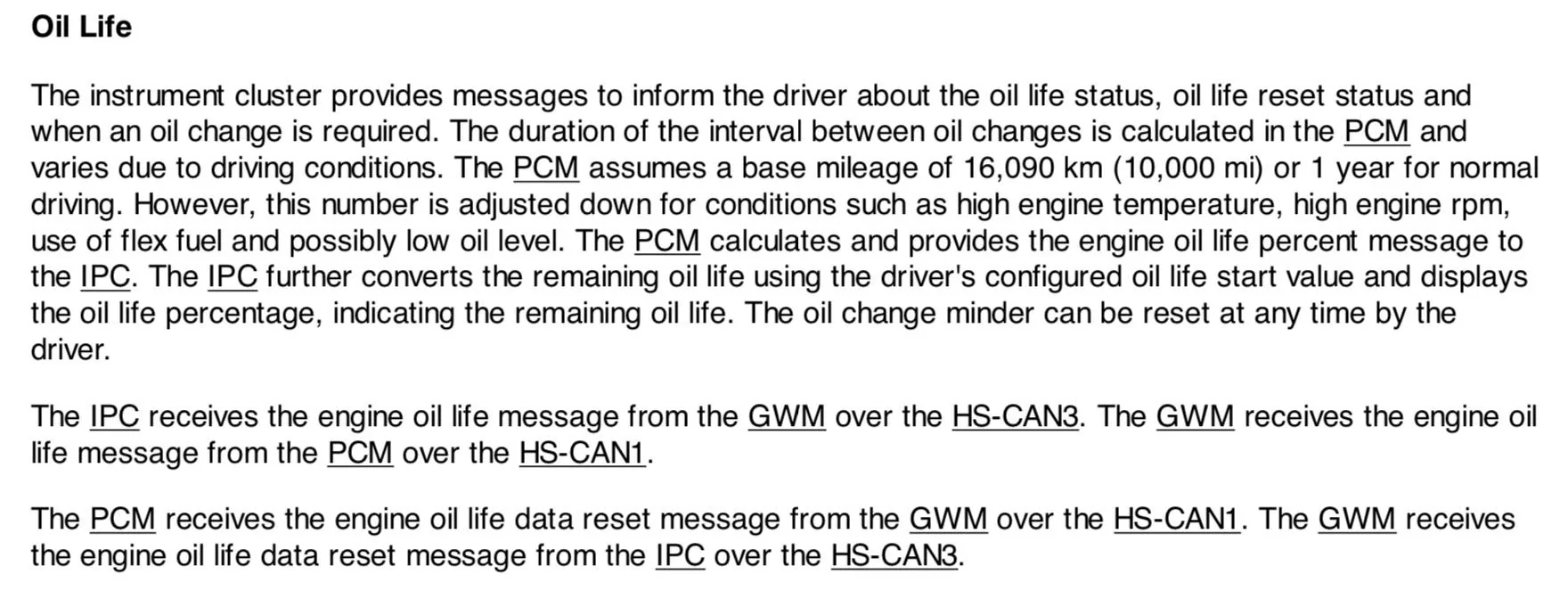

Here’s how the oil life monitor works, per the shop manual:
this is very interesting. i just assumed it was based on mileage alone, and was confused because i thought this most recent time after my last oil change, the "oil life remaining" percentage dropped more quickly. i have been using E85 on a flex fuel tune from Livernois. driving habits havent really changed much.
the PCM actually determines the % of ethanol and recalculates oil life based upon this, and other variables? im pretty ignorant on the electronics stuff.
i dont care much about changing oil frequently, i ran mine pretty hard on a track for a solid 60 mins and the oil life still said about 42% i think but i changed it anyways, the engine temp did get warm a few times. even at the cost of buying 10 qts of synthetic, still cheaper than the potential damage by being neglectful.

Yes, clearly it's not based only on mileage which explains why everyone seems to have different mileage traveled for a given percentage of oil life remaining. I've read that some guys have well over 5,000 miles with over 30% oil life remaining while I have only 2,248 miles on mine with oil life at 25%. It's similar to the Honda MM system where my short-trip car got a little over 5,000 miles with 15% life remaining and the other car that does long runs had gotten just over 10,000 miles with 15% oil life remaining.
