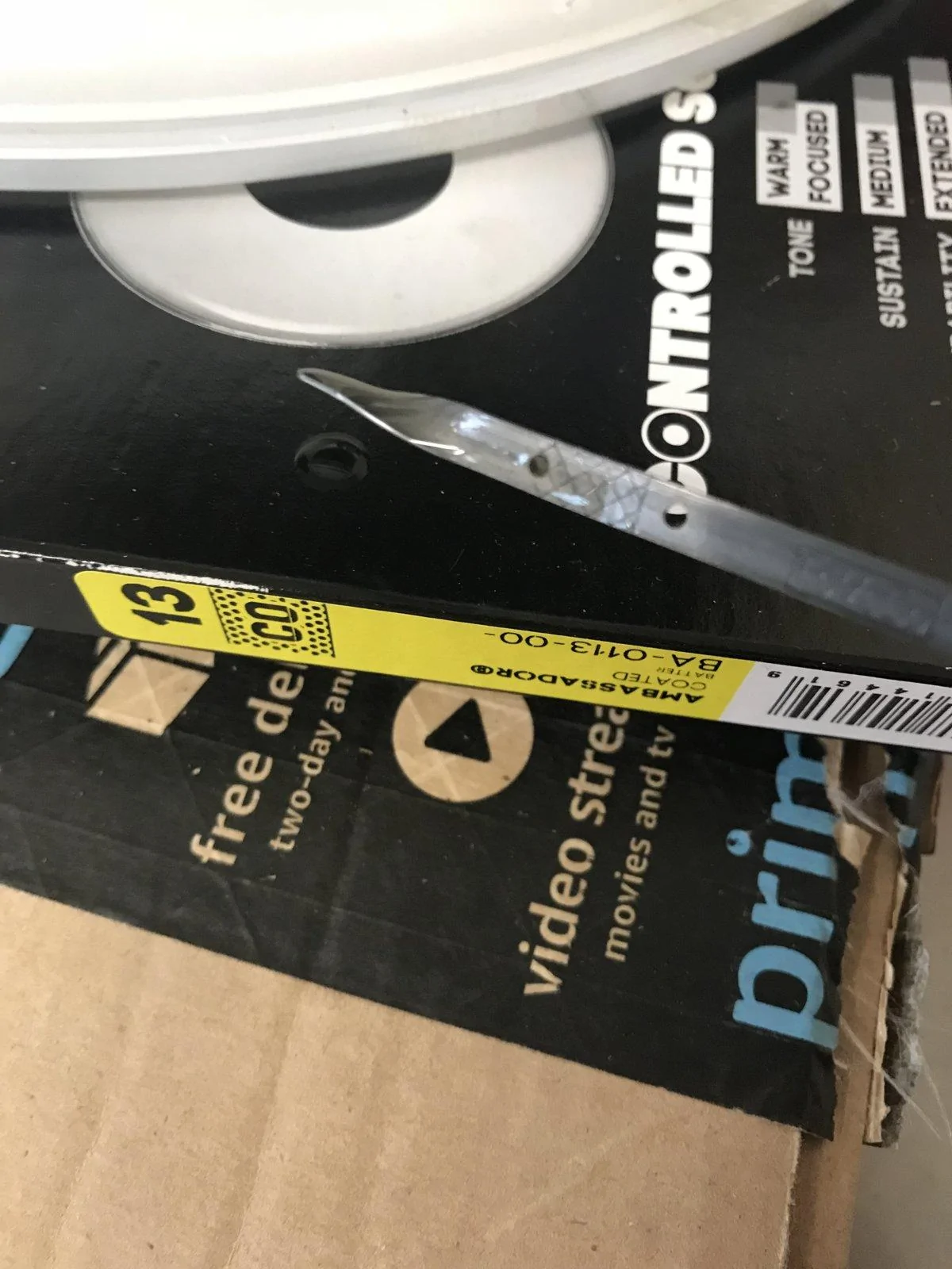

i read somewhere that warm oil expands and that expansion can skew the oil level readings.
I changed the oil in my 17 yesterday, ran it to 170 degrees oil temp and checked the level on the dip stick after 15 minutes. It was at the top of the hash- perfect and on the money.
It cooled down to about 45 degrees here last night and I checked it again after it was cold from sitting all night.
The attached picture is where it was after cooling off overnight. If I were to refill it based on the cold reading I would probably be overfilling it so it’s good. I wonder if this is why the manual specifically states to check it when still warm?
Again, just an observation- I have seen lots of people worried about oil consumption and wanted to highlight the difference between a hot an

Your oil is filthy. You need a change asap. Ha ha I kid. Looks like you have 20 miles or less on it. Lol
Actually it had about 20 minutes on it !!
I changed it and warmed it up before the pic (darn rain prevented me from driving it)

Hopefully no one would add oil when the level is still between the hash marks.
It's interesting to see that the level looks a little lower after sitting overnight. I agree with the poster earlier who said the car might not be completely level.
