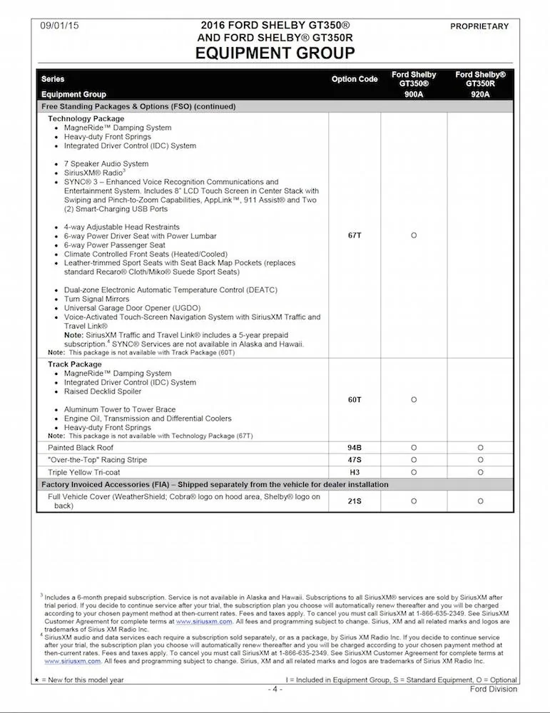

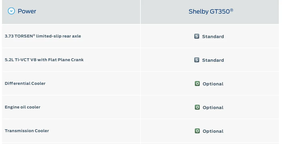

It's entirely possible that the decision to add the air to oil cooler to all gt350 was made late in the game (possibly after data collected from the track tours?) And all the other documentation hasn't caught up.
Would love to see this confirmed by Ford. Would be nice if Tech pack cars had the extra oil cooler supposed to be only on Track and R but nothing official? Don't want to spread rumors. Don't care about trans and diff coolers as not planning on track use but am a little concerned regarding oil even just for spirited non track driving.

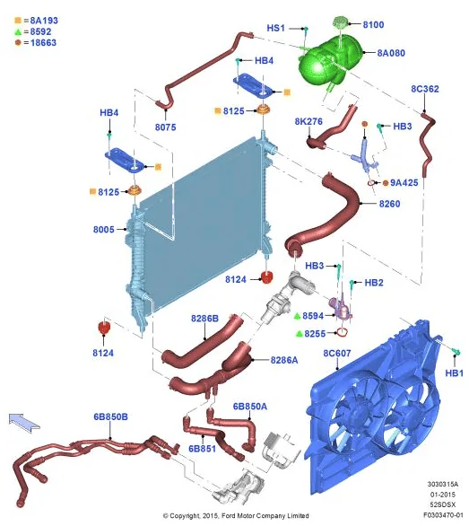

Is the exploded drawing in post #13 incorrect? I'm fine if it is, as I had hoped they did away with the sandwich plate cooler given the number of failures we had at the track with them. I'll drop the oil filter access door tonight when I get home and see what's up.
That drawing in post # 13 shows both types of oil coolers. If you follow the lower radiator hose 8286A in the drawing where it's modified with two small fittings coming out of the bottom, that's the one for a water-to-oil cooler. There are not fittings on hose 8286B which is the one used on the GT350. There are two types of aluminum fittings shown just left of the radiator fans. The sandwich plate used on the water-to-oil cooler is on the right, and the fitting that plumbs the two lines to the air-to-oil cooler in the driver side lower grille is on the left.
I put the car up on jack stands and opened the filter access panel to get a better look. You can see the aluminum fitting and oil lines in the photos below. This should clear up the confusion, and it also means they must have added air-to-oil coolers to all the GT350s.

Arsenalrocks took some pictures in another thread - they are blurry but may be the same fittings for the 2 hoses, and there is definitely a radiator behind the lower grill opening on the drivers side

It's an air to oil cooler, not water to oil.
Warmup is good because there is an oil thermostat that prevents flow through the cooler until the oil is warmed up. It's just like the 5.8L engines in the GT500s with the Track Pack remote cooler.
