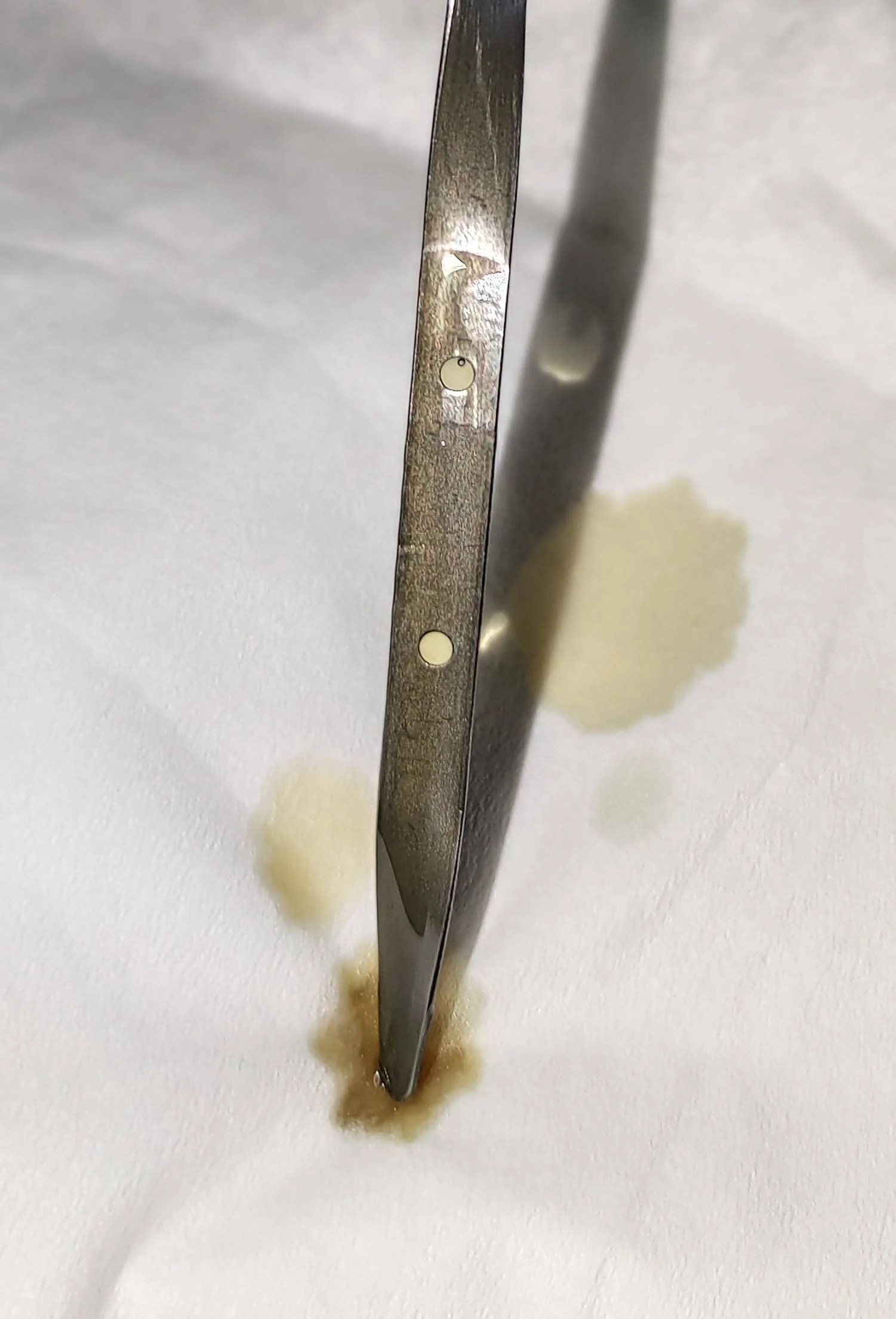

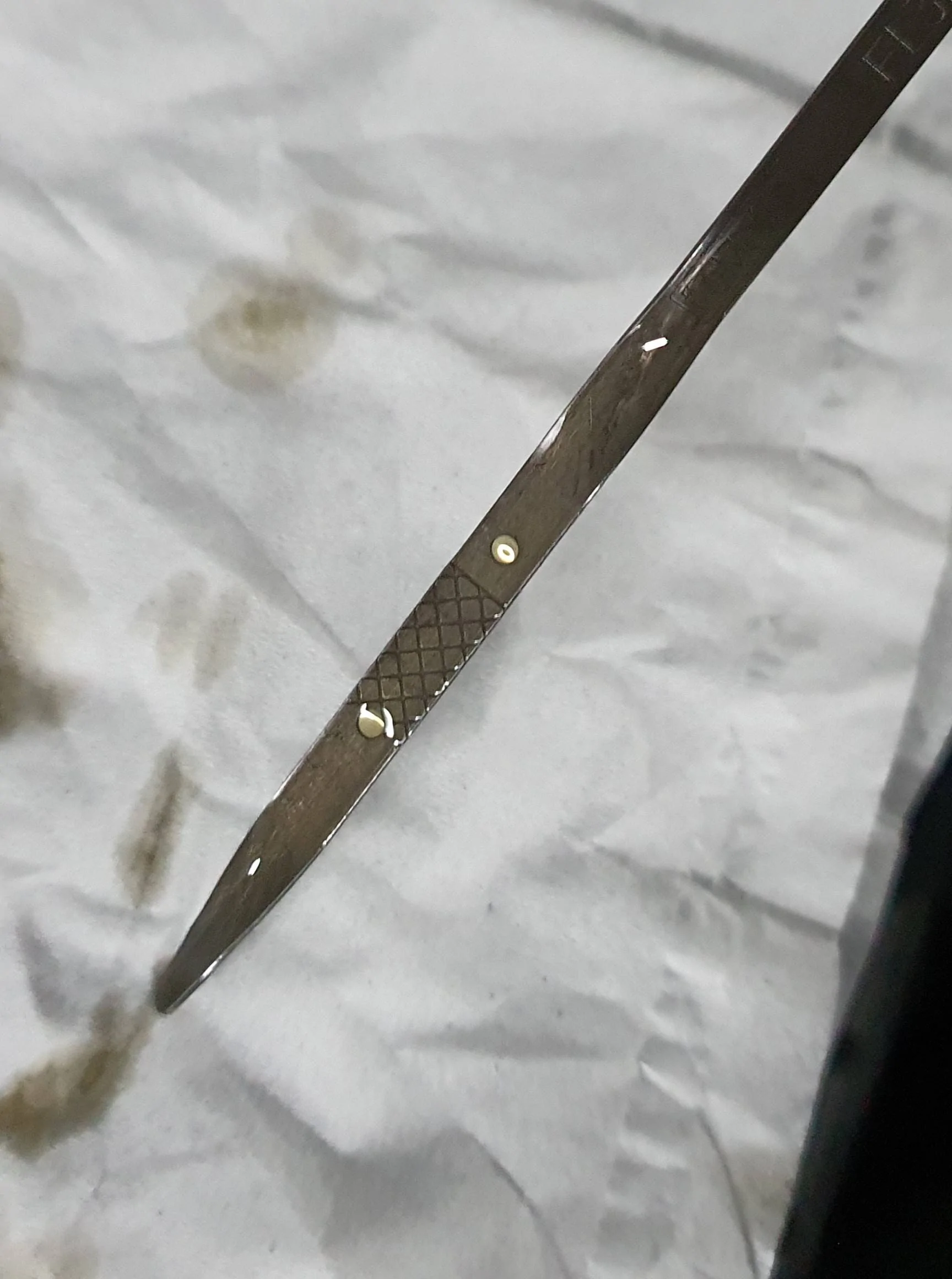

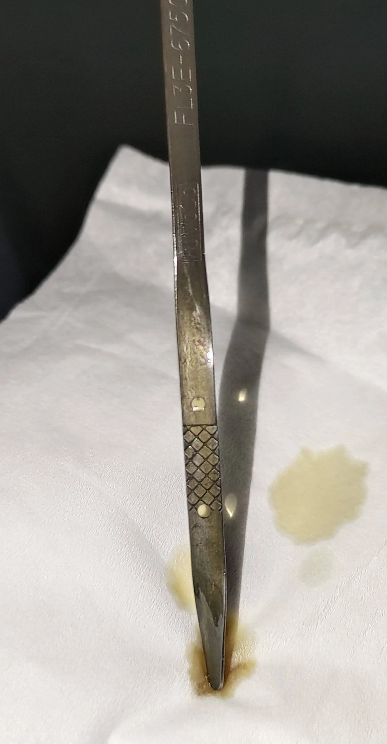

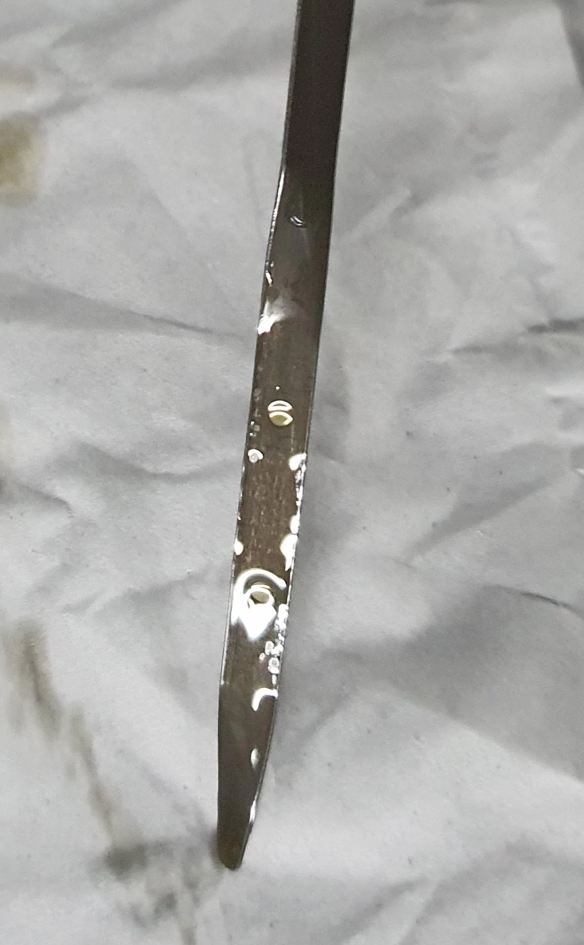

Is the car actually level when you check? If it's filled right to the top and the car is on a slope, either side-to-side or front-to-back, it can lead to readings that look high even when everything is fine. Having said that, if it is, as you say, just "slightly above the top hole" and if most of the driving is in town and in traffic or cruising on a highway, I'd leave it as it is.Hey Mate,
Quick question,
Just did an oil change, drove back home and checked the oil level. It's slightly above the top hole of the dipstick.
My location doesn't allow me to do my oil changes, hence I need to take it to a garage.
Should I drain a bit of oil to lower it or is it OK to run?
If its harmful, I may have to take the car on a truck to the garage..
Thanks!
If, on the other hand, it's actually quite a ways over the top hole, of If I was doing track days or quarter-mile events, then I'd go to the trouble of lowering it a bit.
As for getting a flat bed truck to move it, well, you made it home without a problem, so that's probably not necessary.
