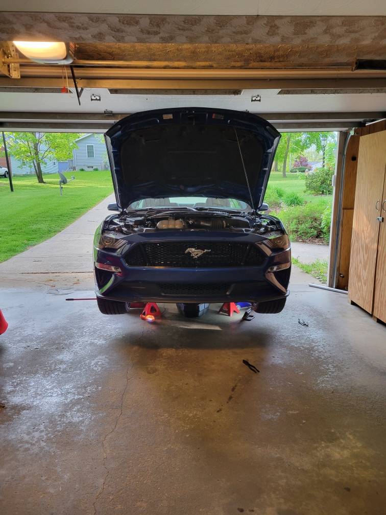

Actually you are going to want 10.5qts of 5w30. I just did the first change on my wife’s 2022 GT convertible. The OE Ford oil filter is a little smaller than the FL-500S oil filter plus I let the oil pan drain forever.
10qts will put you right at the BOTTOM safe range.

Thanks. I let it drain about 6 hours. I even lowered the car to the floor to get the last few drops out.
I like the way you think. 45mins got everything out to a drop for me. I made sure the car sat for 5 days so there wasn’t any oil in the engine, then I pushed it out the the garage door.

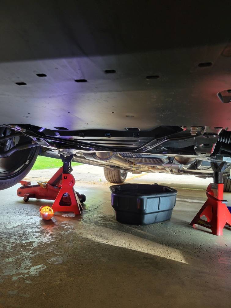

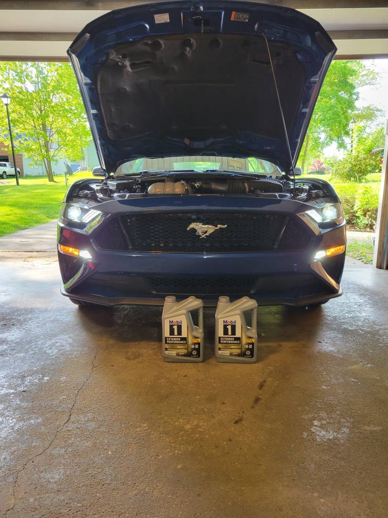

Notice the bathtub-sized drain tub in @Germansheperd 's post. If this is your initial change with the car, highly recommended something of this type. 10 quarts is a lot. It exists the engine rather quickly, initially almost straight out towards the back.
A LOT comes out and FAST! I kept the drain plug handy when the bathtub drain was filling up just to push into the oil pan to give the drain pan a minute to go down.
