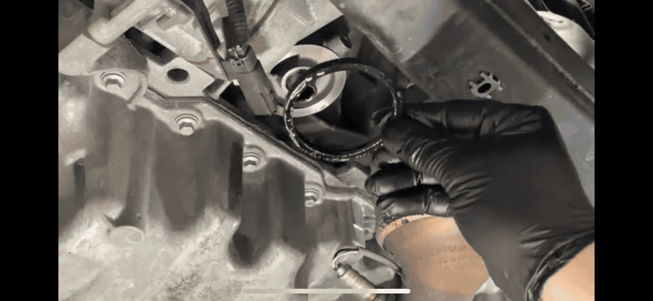

- ALWAYS make sure the o-ring from the used filter your removing came off the block, and didn't get stuck on ther like he shows in the video.

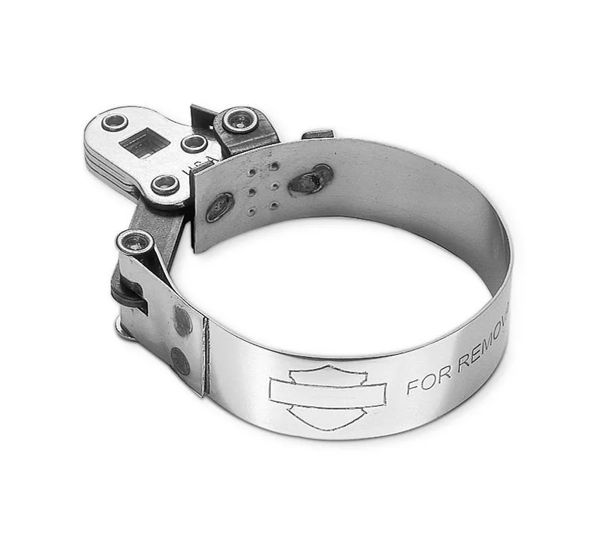

Only thing I will add is the filter wrench I use from Harley Davidson works great on the Mustang. A 3/8" ratchet extension fits into the square hole and you can set it so the extension comes in over the cross member and doesn't interfere with anything you're using as a funnel to direct the oil into a pan.

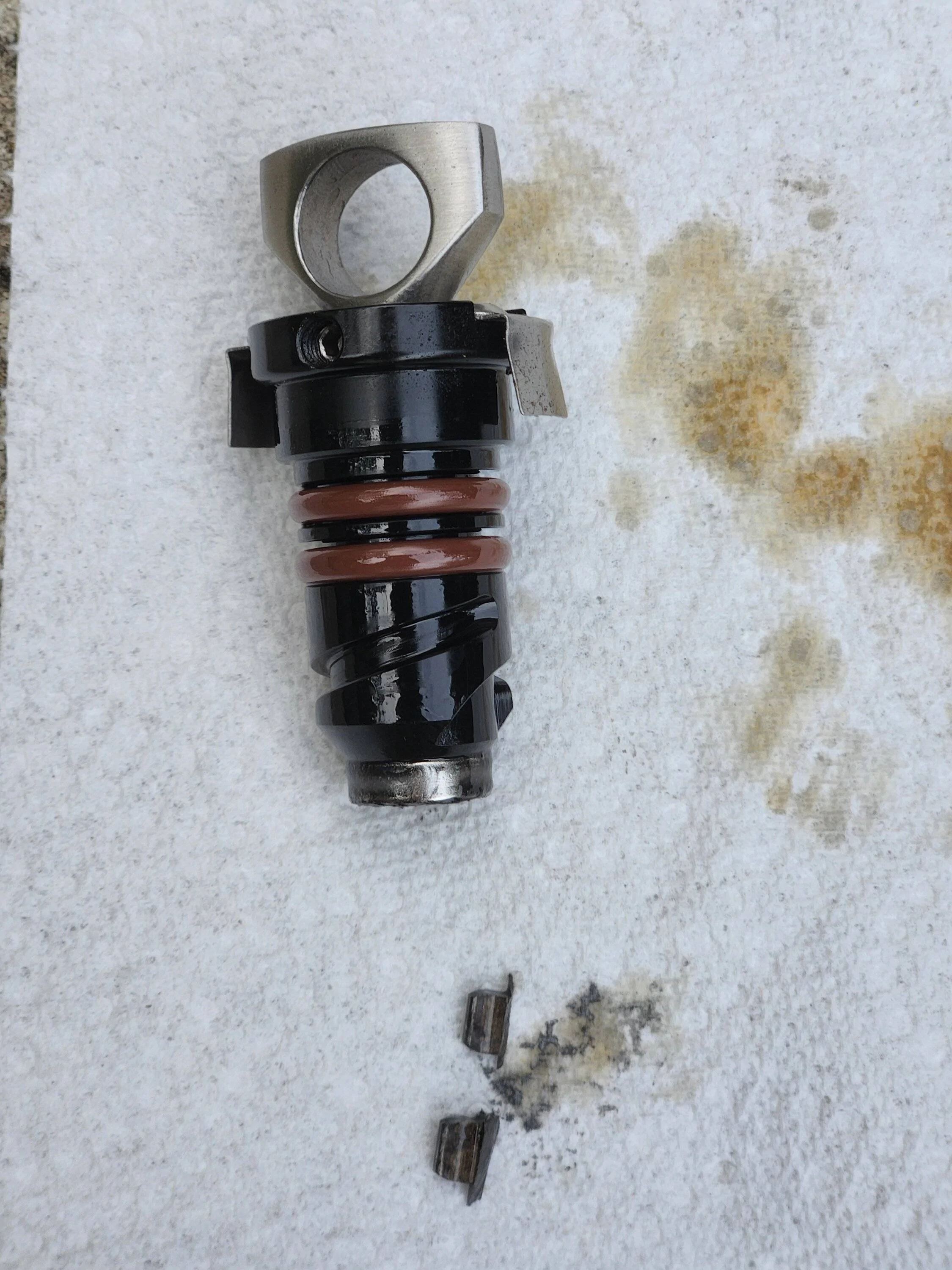

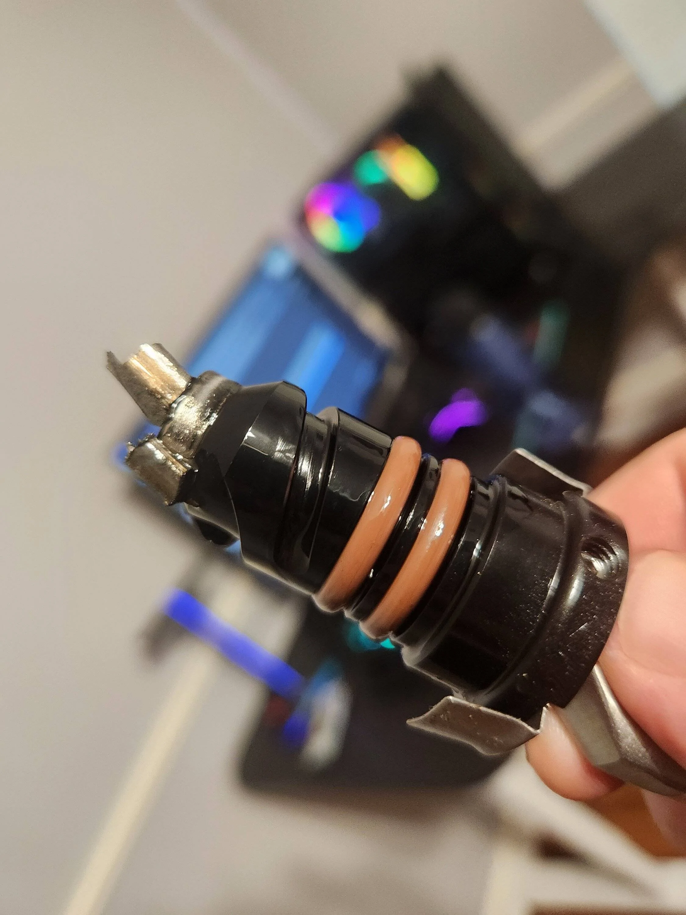

Do you really have to replace the oem plug every change or can you get away with reusing?
The factory Ford plug is a pretty stout piece of plastic. Other vendors have a like mindset with their oil drain plug (metal plug) gaskets: replace at every oil change. But almost everyone does not, or flips the gasket, re-using multiple times.
I can't speak to re-using the factory plug. I replaced mine with an aftermarket unit. But I did save my old one. Seems like a good practice to buy a spare factory unit and set aside.
Regarding the factory plug, I believe one reason Ford recommends replacing is how people handle it.
The factory plug doesn't unscrew like a traditional plug, but releases with one quarter turn. I believe most people instinctively have a pair of pliers and grab ahold of it, which is OK, but then apply force as to unscrew instead of simply turn a bit and release. Same with tightening. The factory plug has stops or "ears". For those that don't notice when tightening, or that tighten too much, they apply too much and unnecessary force on those stops and break them off or crack them in the process.
