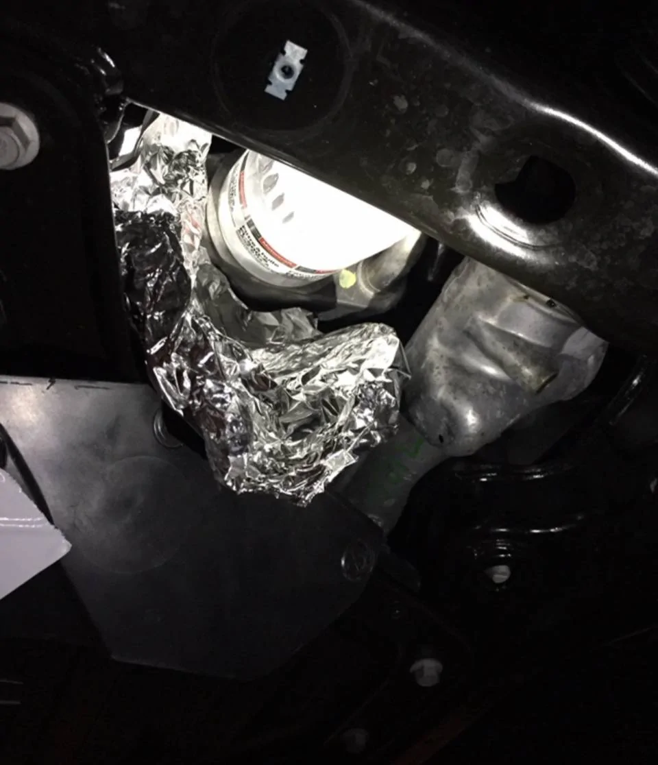

The first oil change was a shit show for me and the issues were all about getting the factory oil filter off. I built a funnel out of a half gallon milk container by cutting out the bottom and two of the four side. Worthless. Trying to get the oil filter cranked off took a set of very large channel locks. Once I did the oil spilled everywhere. Next time I'll use aluminum foil to cover up the wiring and connectors and just let it flow. Plus I went with a K&N oil filter and will use the nut on top to remove the oil filter the next time.

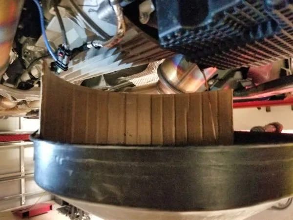

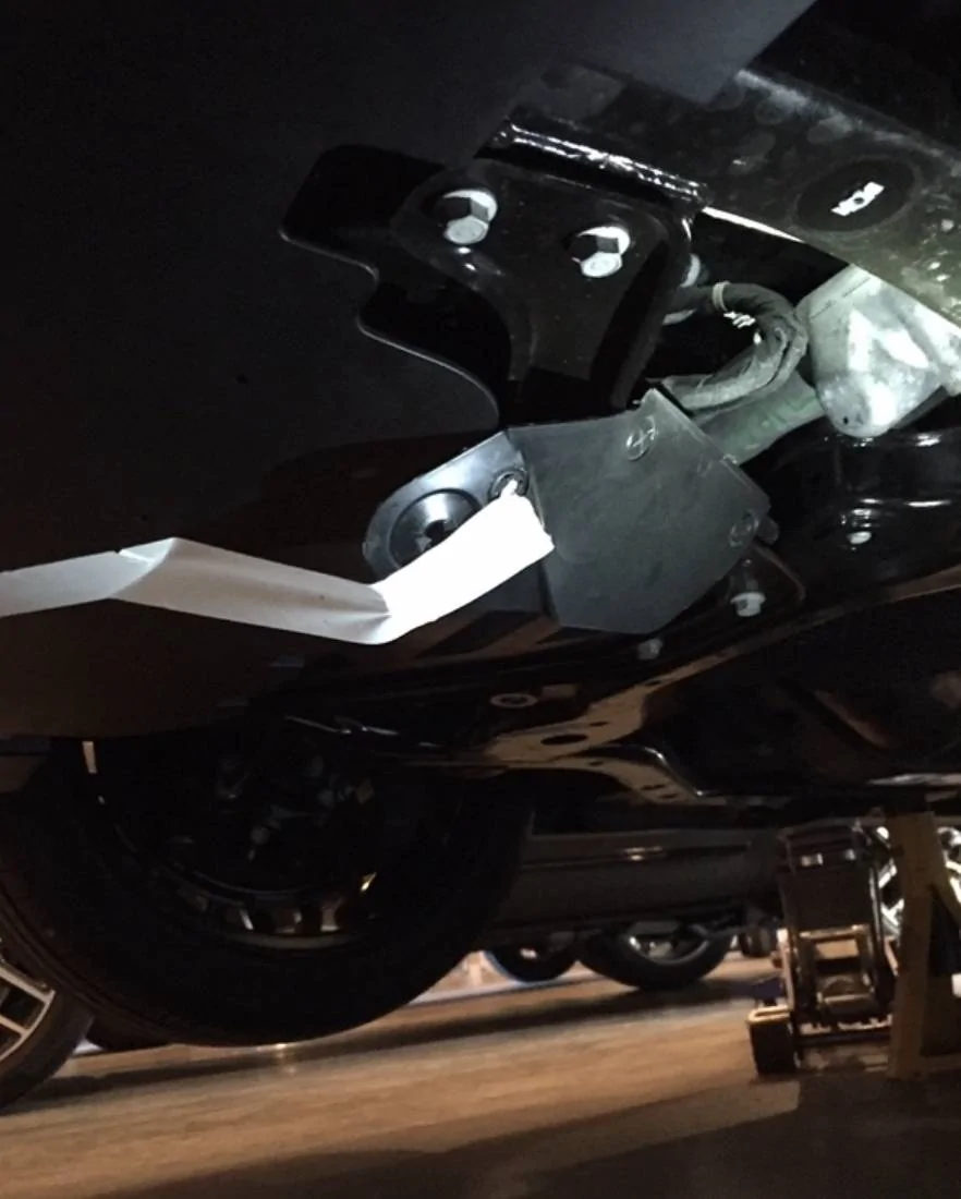

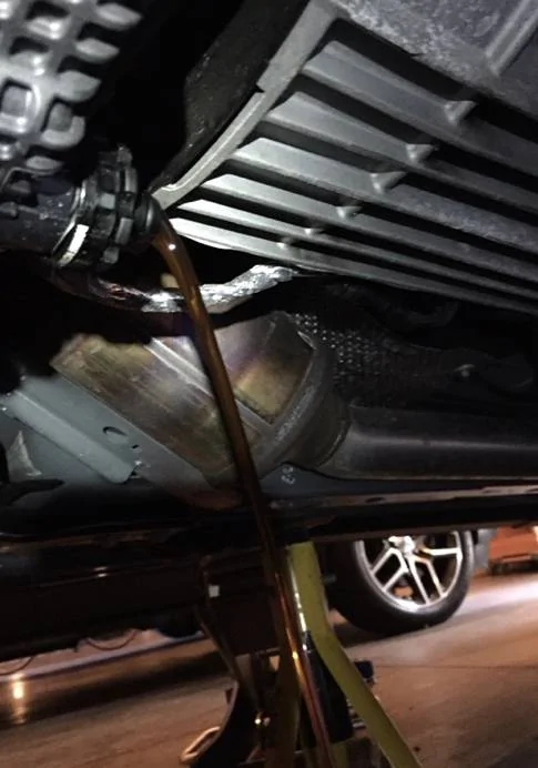

Straight out the back, like a fire hose. A tarp and old t-shirts helped. Should have considered a deflector shield to get it into the pan. UPR drain plug installed now. Future oil changes should be easier. :please:
For the filter, I first used a "V"-shaped cardboard form, for shape, laid with tinfoil. To protect the wiring bundle in the immediate vicinity, I put t-shirts there.

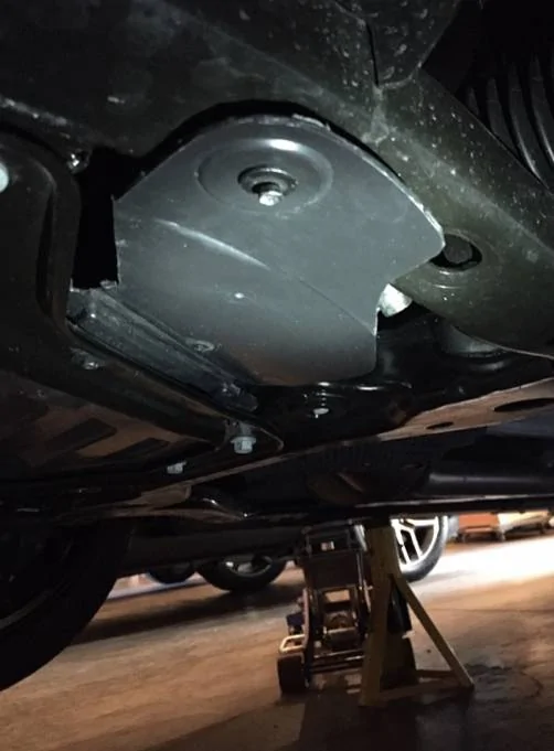

The first oil change is a pita. I've read where you can just loosen the yellow plug, and let 5 quarts out a time. But I did all 10 with a little mess.
On my '20:
- Remove the 7mm fastener on the plastic pan door to access the filter.
- Wipe off the pan/door, and use duct tape to hold it open.
- Loosen the filter, then place a one-time-use , open sided aluminum foil funnel under the to oil filter to channel the oil.
- Prime and lube the o-ring on the new filter, then screw it on snug.
- I have the Ronin Drain Plug. Just remove the cap, and thread the adapter in. My pans only 5 quarts, so I just close it up after 5 quarts is out, dump that, then come back for final 5.

I duct tape a piece of cardboard as a backsplash on my drain pan, sure was glad I did! ;)

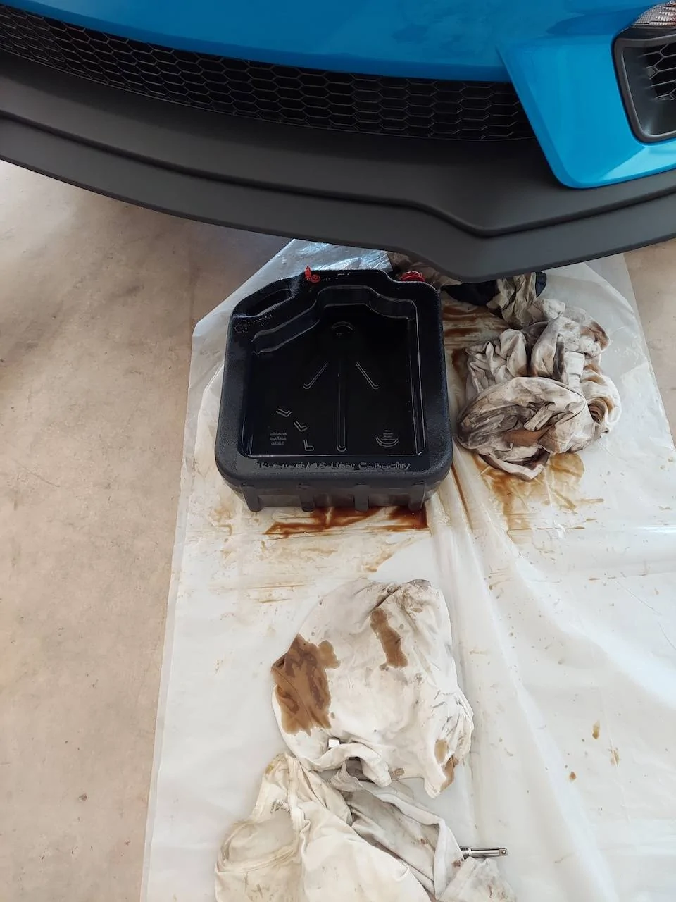

When I did my first oil change I used a 16 qt tub like this
and the oil was coming out so fast I thought it'd go over the top the whole time lol

Same! My catch pan couldn’t keep up with the flow. Fortunately, I had placed a large flat catch pan under my large plastic oil pan. It caught the overflow.
