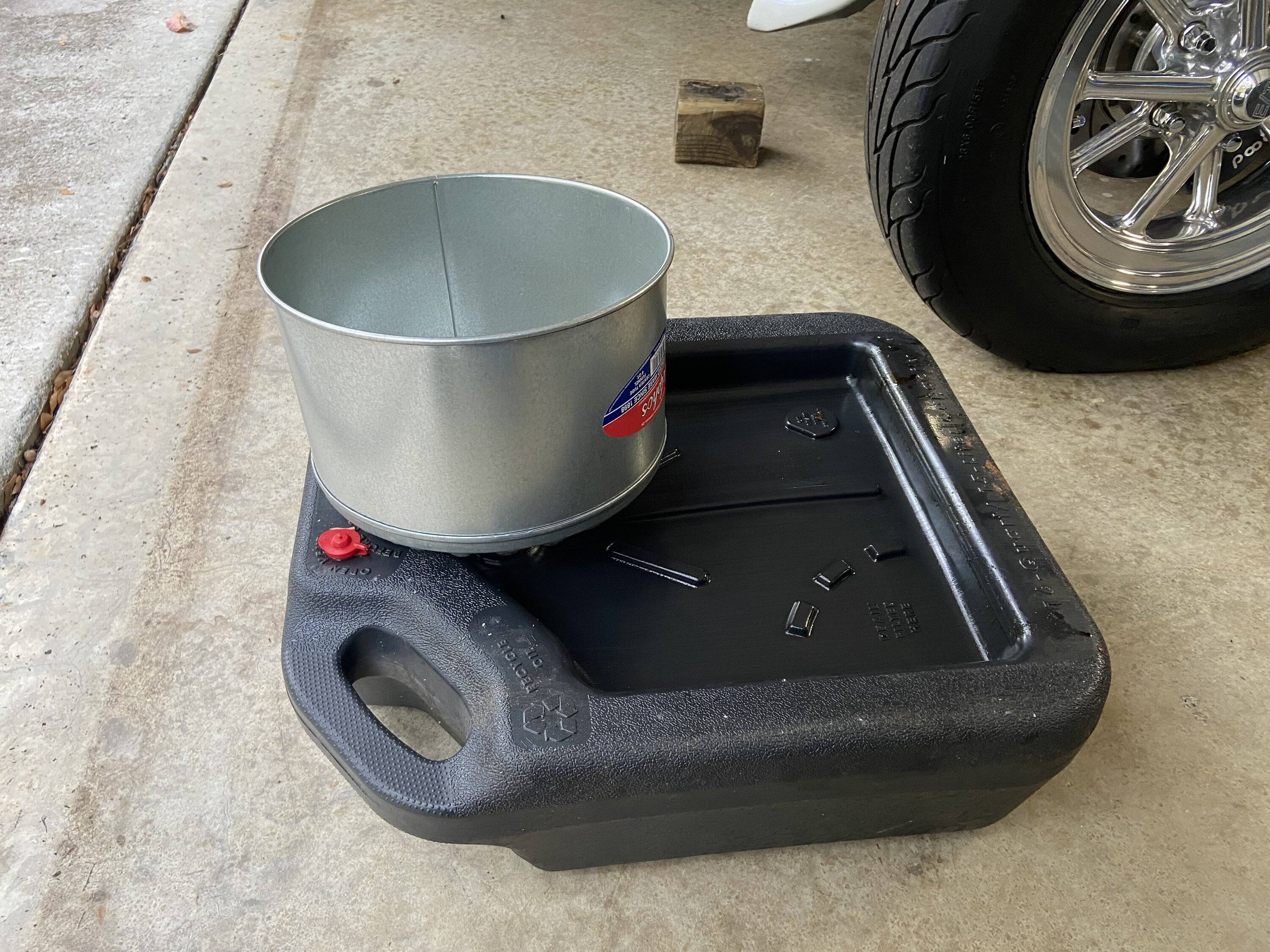

Just a warning to any driveway warriors doing their first 5.0 oil change, that oil comes out FAST. My catch can is the type where it drain down from the top and the Mustangs mighty stream overwhelmed the little hole and made a MESS on my ep henry driveway.
It sure does, Fred. I got lucky having a big one for the F250 the first time I did the Predator motor. When you have nearly double the volume of oil subject to good old gravity, the pressure is also a lot higher.
Sorry about the driveway, I hate getting it on the porous concrete as it takes a whole lot more effort to get out the stain. Good luck.

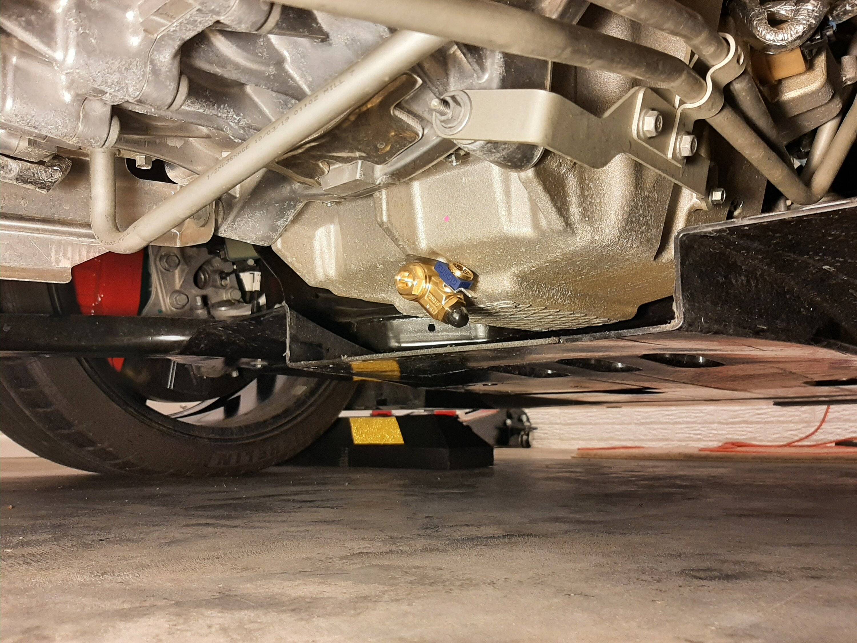

I highly recommend a Fumoto valve, makes oil changes so easy!
Had one on my WRX and never liked how it hung off the oil pan. Ended up going back to the factory plug style. Gonna get one of the UPR metal drain plugs with the magnet next oil change.
The one I have doesn’t hang low and the outlet sits just a bit higher than the belly pan. But, it’s also for a Shelby so I can’t speak for other models.

I third that emotion, make it much easier with a smaller orifice that doesn't explode with a 3/4" stream and no trying to find the oil pan plug. :-)
This will control the oil flood, never spill a drop again
Quick Jack friendly

Fumoto is above the belly pan. Blue clip is the safety lock. Just attach a hose, put it in your drain pan, remove the blue clip, lift the lever up out of it's locked position and rotate to open. It is as mess free as you can get. I have a black vinyl cap on the hose barb to keep everything squeaky clean.
